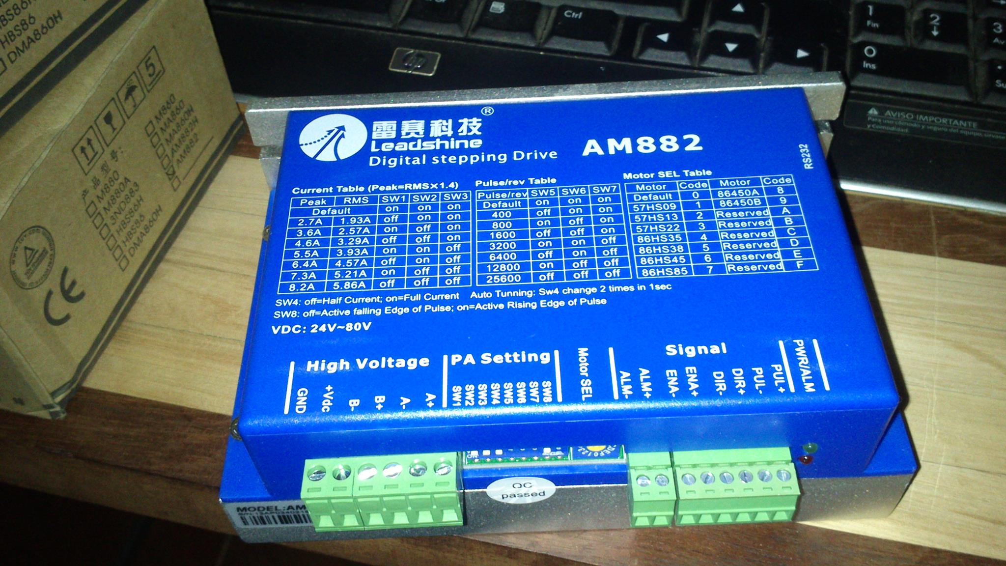

    Hello guys I recieved all the goods from china for the cnc
    Axis X
    2pcs RM1610-1500mm Full length 10 pitch
    2pcs HGR15 -L1500mm
    2 AM882
    Axis Y
    1pcs RM1610-1200mm Full length 10 pitch
    2pcs HGR15 L1200mm
    1 AM882
    Axiz Z
    1pcs RM1605-350mm Full length 5 pitch
    2pcs HGR15 L=350mm
    1 DQ860MA
    Motors
    5PCS Nema 23 stepper motor 425oz-in,3A,2ph,1.8°
    Breakout board
    1pcs 6 axis cnc DB25/ interface board adapter milling engrave c10
    I want to thank you for your help, thanks to you I could select the components. I would like to know if you could give me some advice regarding the spindle selleccion. I have a 2050W router and do not know if I should use this or if it is better to buy a water cooled spindle or any other,since I donŽt know if the power that I need 2.2 kw or 3 kw is suitable for milling materials I will use.
    On the other hand, I want to ask JazzCNC for help to build the power supply appropriate for this equipment,and to help me decide on the components I should buy to make it. And finally I would like to know what I have to do with the components, what procedures I need to follow.

    Contact me thru PM with your email address and I'll help you with PSU but won't do it over the forum as it can be miss understood by others and potentialy dangerous and damaging if done wrong or misunderstood.! . . . . . . Others may offer over the forum but I'm not prepared to do that.!
    Also At the moment looks like you plan to use AM882 for X & Y with DQ860 for Z & A but you have bit of a mixed up setup there mixing digital drives with Analog drives and if Slaving A axis with another(X) to form twin motor axis then you would be much better using same drives on each.! The AM882 would be best for this because they have stall detect and fault signal.
    Another thing is the motors.! Which motors are they and do you have a data sheet or model number.? Becasue you quote 425oz rather than Nm I suspect these are the high impedance motors often found cheap on ebay.? If so be aware you will get much lower performance from them for the same amount of Voltage compared to same power motors with lower impedance. This will affect the feeds you'll achieve and lower the amount of torque available higher up the speed curve.!

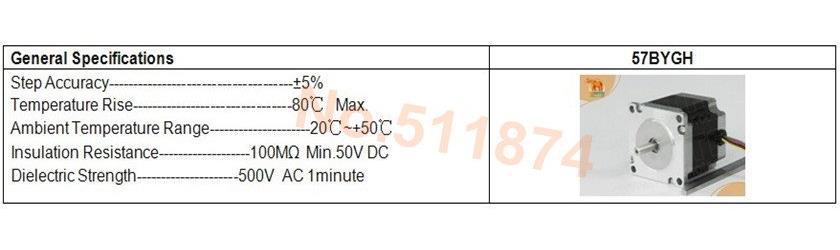

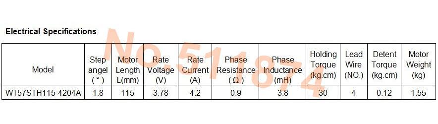

    Hello guys I try to follow your advice in all the buys. I bought this models, wt57sth115-4204a, Click image for larger version.
ID:	12414Click image for larger version.
ID:	12415Click image for larger version.
ID:	12416 and I find this on internet Click image for larger version.
ID:	12417Click image for larger version.
    I ask for low inductance as Jonathan told me. Ibought this in October 2013 and after 1 month of travel and the rest of the time in ARGENTINA CUSTOM y recived this. Some times I want to leave this country!! But my family is here.
    Thank guys I really apreciate your time.
  11. #30
    Quote Originally Posted by jpsicilia View Post
    Great good to see you took Jons good advise. Those motors while still a little higher than some motors of same power are still have low enough impedance not to be restrictive.
