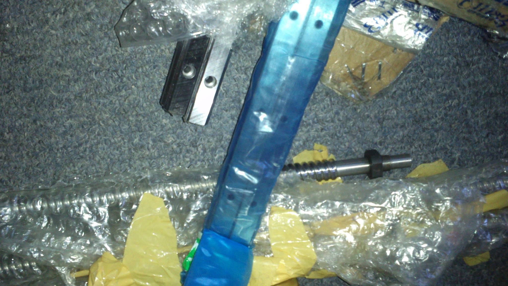

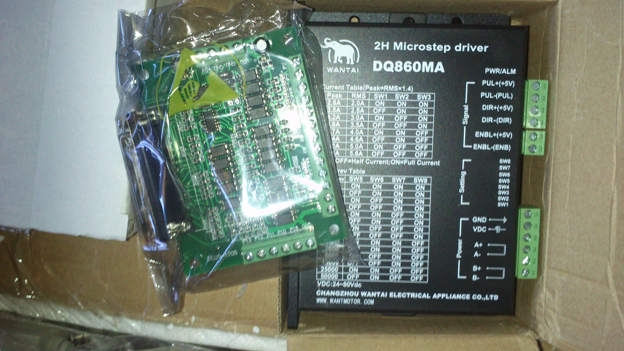

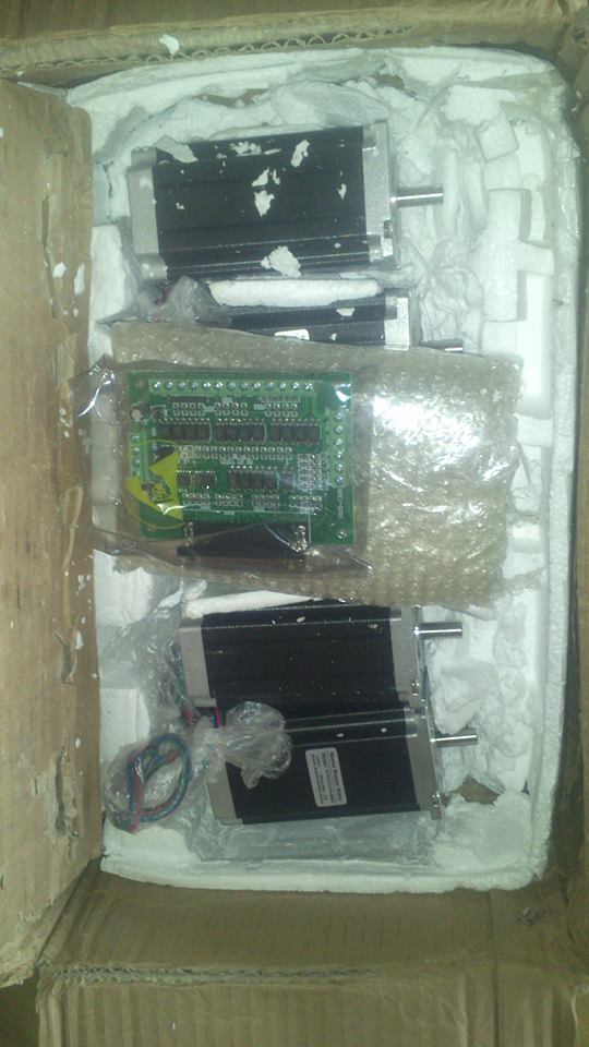

    Hello guys I recieved all the goods from china for the cnc
    Axis X
    2pcs RM1610-1500mm Full length 10 pitch
    2pcs HGR15 -L1500mm
    2 AM882
    Axis Y
    1pcs RM1610-1200mm Full length 10 pitch
    2pcs HGR15 L1200mm
    1 AM882
    Axiz Z
    1pcs RM1605-350mm Full length 5 pitch
    2pcs HGR15 L=350mm
    1 DQ860MA
    Motors
    5PCS Nema 23 stepper motor 425oz-in,3A,2ph,1.8°
    Breakout board
    1pcs 6 axis cnc DB25/ interface board adapter milling engrave c10

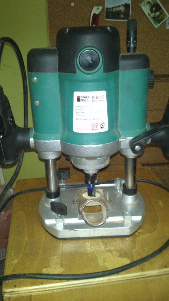

    I want to thank you for your help, thanks to you I could select the components. I would like to know if you could give me some advice regarding the spindle selleccion. I have a 2050W router and do not know if I should use this or if it is better to buy a water cooled spindle or any other,since I donīt know if the power that I need 2.2 kw or 3 kw is suitable for milling materials I will use.
    On the other hand, I want to ask JazzCNC for help to build the power supply appropriate for this equipment,and to help me decide on the components I should buy to make it. And finally I would like to know what I have to do with the components, what procedures I need to follow.
