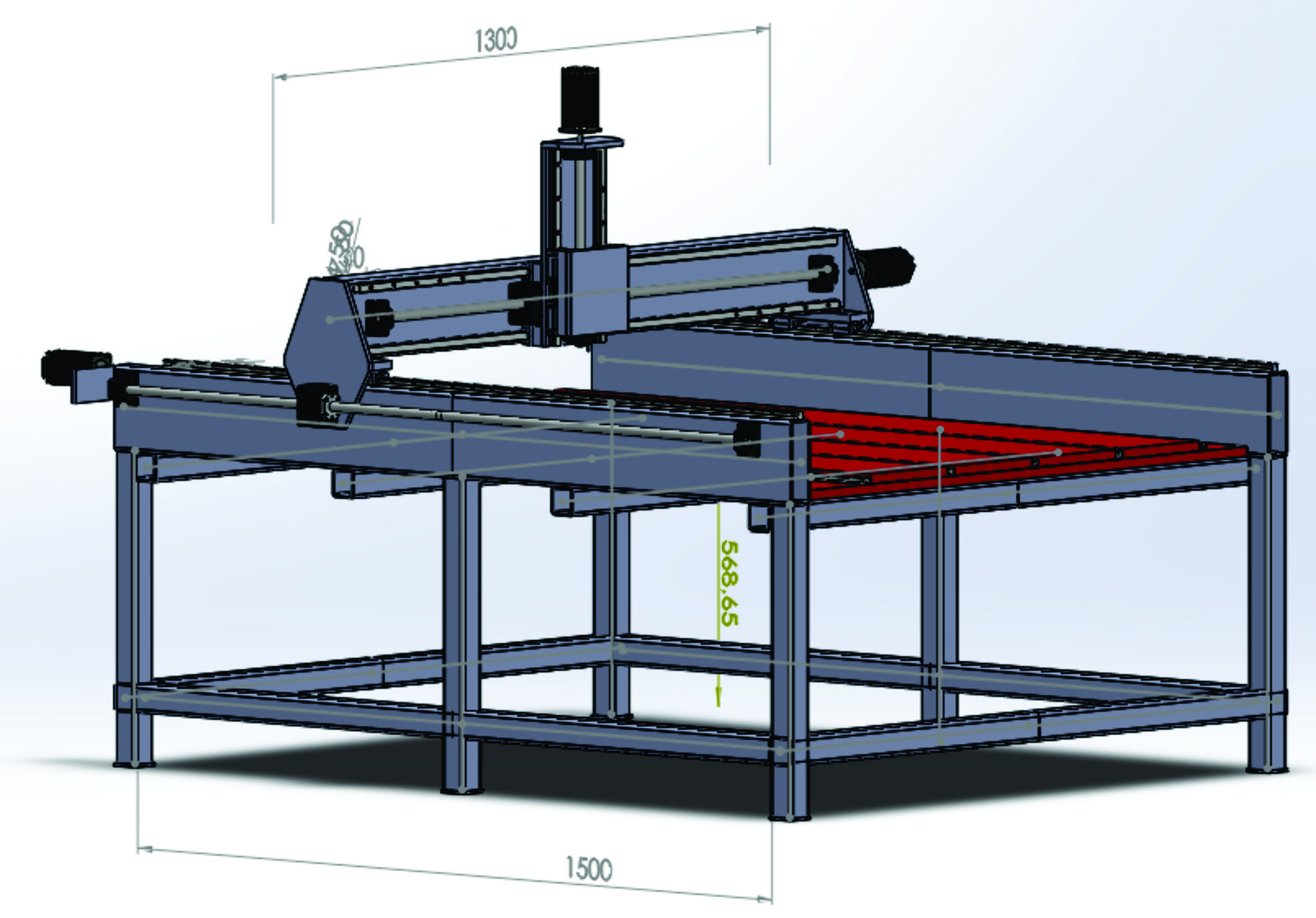

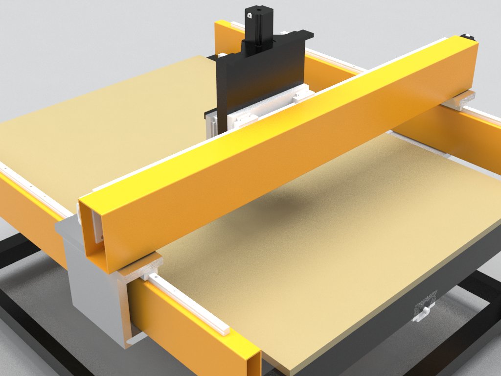

    Here are some old frame renders

    Quote Originally Posted by jpsicilia View Post
    Hope this is just initial draft because You will need many more supports and bracing adding before this design is usable.
    Also it's too wide for a central ballscrew and you will never successfully cut aluminium, or wood for that matter with this design. ABSOLUTELY must have TWIN ballscrews.!!
    How are you Jass? You are amazing! You have clarified many doubts for me. I hadn´t considered the pitch before and the quality it brings. As you said, it is true that we think that the bigger the engine the better. It is very interesting your idea of changing the ratio of the pulleys to get more resolution or speed and considering the torque. With all the information you gave me I have decided to restart my project. I will remodel these aspects with the solidwork software and I will most probably ask you some questions if you do not mind. Thanks a lot!!
    Hello again! As I have told you before I have started with my CNC project from zero thanks to the tips you have given me. I thought of making a bigger CNC, use it to mill wood, plastic and aluminum, and later I want to buy a small mill and change it so that I can build mould in aluminum and if possible metal.
    This time I am bothering you because this week I am going to buy the components from China and I want to make sure that I am buying them correctly, and I imagine this happens to all of us when we build a CNC for the first time. I have a couple of questions regarding the hgr15 for the x axis, maybe they will work or will I need a hgr20?
    This is what I have thought for the CNC:

    Same pictures of the cnc frame
    Either is plenty stiff enough. Sometimes people go for the 20mm rails just to make it easier to to make the parts they mount to with minimal machining. You need to draw it and work out which is best before buying them.
