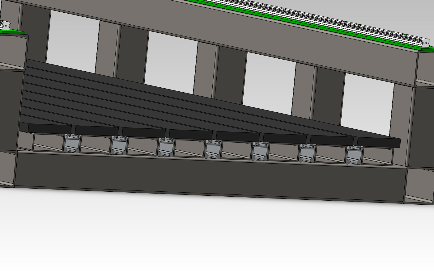

    I I wont use a movable cutting surface as I first had in mind. The cutting surface and the clamping system will look like this.
    On the 80X80X4 steel tubes I will weld 80X40X3 vertical pieces and between them 40X40 tslot aluminum profile. On the 80X40X3 steel tube, 19mm plywood will be bolted. If there is any comment I will be glad to hear it.
    Your solution seems very nice, man i like it. May be will implement it in my next build. But the plywood thing i don't like. Will constantly need resurfacing if you make precision stuff.
    better would be some scrap plastic sheets from doors or whatever found at the Junk yard. And on top-sacrificial layer of expanded PVC plastic sheet. Quite cheap.
