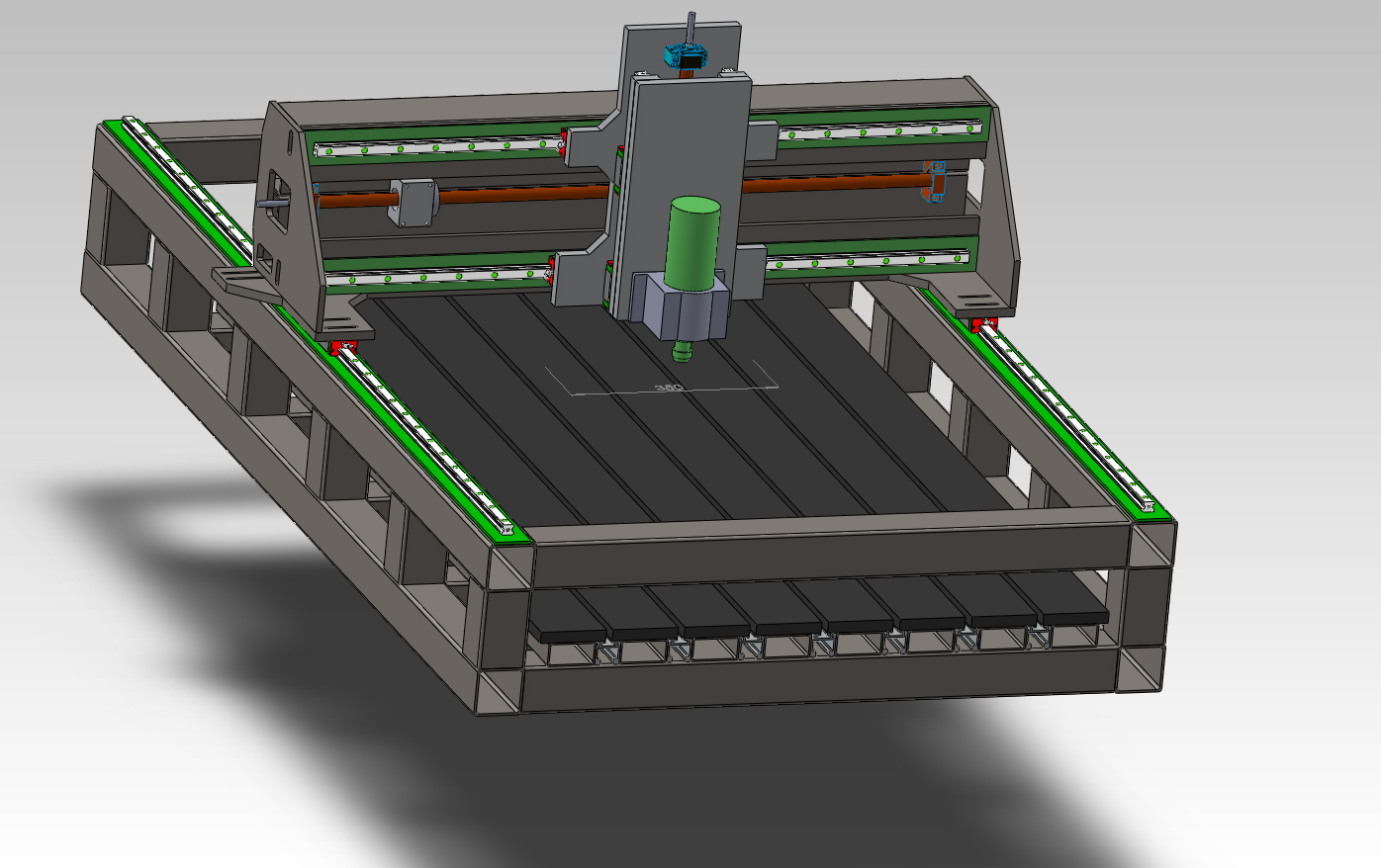

    Now regards the gantry it will be made from 2 80X80X4 tubes(in the middle ) and 2 120X60X4 tubes (up and down) welded together like this. At the back side of the gantry all the tubes wont be in the same plane. The 80X80 tubes will exceed 2cm to make space for the ball nut mount flange.
    Attachment 12676
    The ganty will be welded and then bolted straight to the hiwin carriages ( after I apply epoxy at the bottom side of the gantry ).

    The clearance (after Deans suggestion ) from the lower point of Z to the cutting surface is 180mm. The travel of Z is nearly 130mm. When z axis is at its lowest point the situation is this
    Attachment 12677
    That means 6mm from spindle choke to the cutting surface.
    When z axis is at its higher point the situation is this
    Attachment 12678
    That means 136mm from spindle choke to the cutting surface.
    Is that Ok?This is very critical for the machine construction as any mistake here will need frame reconstruction. Generally is there rule about what is the distance from the choke to the cutting surface when Z is at its lower point.?
    What spindle /KW?/ will you be using at the end? That make protruding things longer or shorter.
    Also have in mind usual 1/8 bit is 10-30mm long, usual 1/4 bit is 20-40mm long, the piece that is not in the collet i mean.

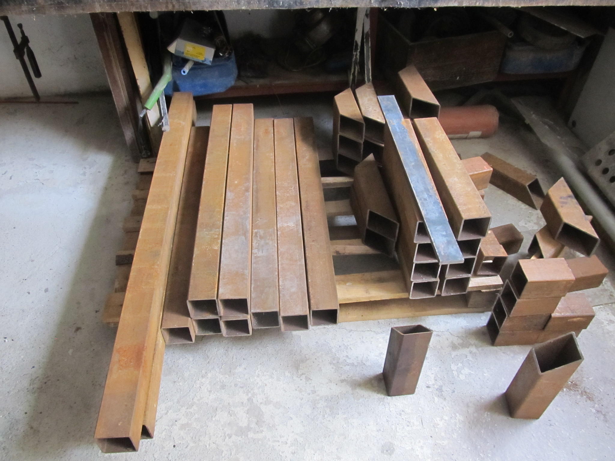

    First of all i didnt get 6m long pieces. In order to lower the cost i choose for the lower base of the machine to go with pieces that a friend had.
    Too rust but not as bad as it looks
    Then i had to cut them. Good for me my friend has a big steel saw so it was easy

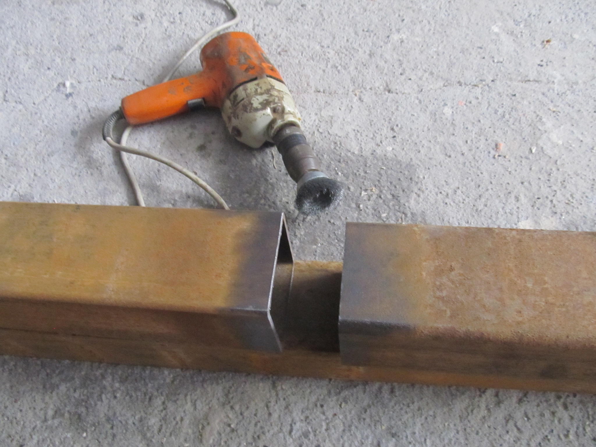

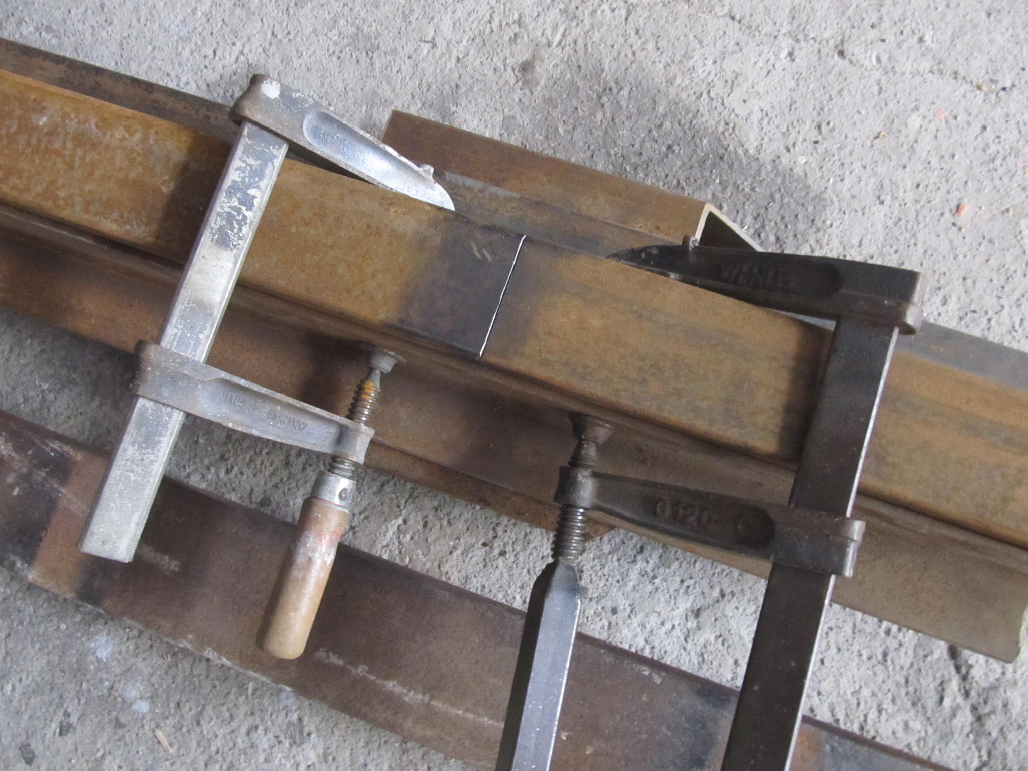

    The steel box section that i get from my friend pieces are 1,5 long so i had to weld them in order to make the 1,9m long that is the bigger piece.

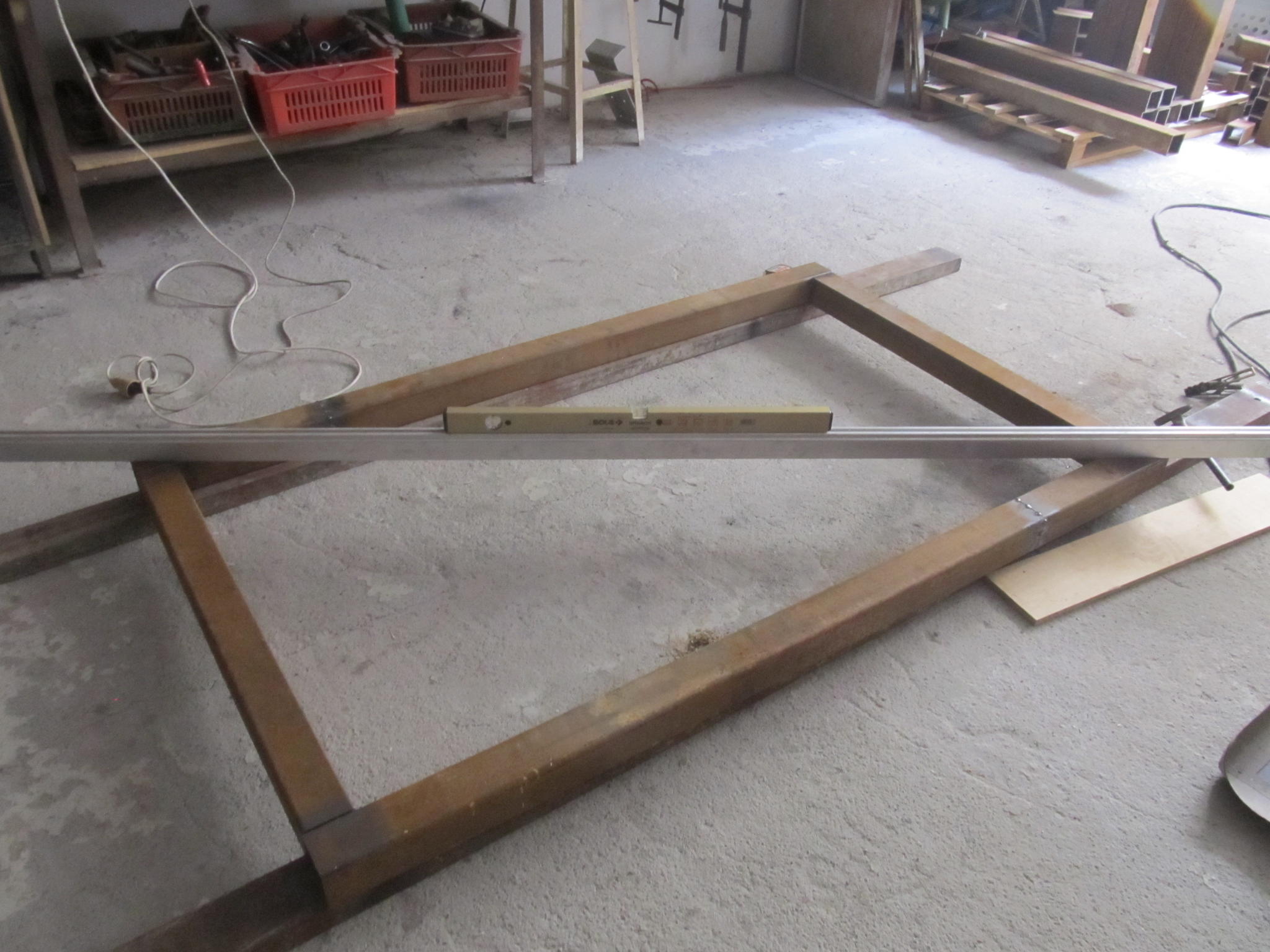

    After i finished the table ( lower part ) i realize while checking with an aluminium profile ( that supposed to be straight ) that the table has distortion issues
    The following photo shows the aluminium profile when i check the diagonal from one corner to the oposite
    It seems that the aluminium profile has 7mm distance from the table.
    I use a jack in order to corect the bending but with no big success

    Good for me i reaslize that the problem is at the midle of the table, as the 4 corner( lets name them 1 2 3 4) are all at the same level. I use a digital level. First i messure τηε gadient between corners 1-2 and i zero the level. Then i continue by messuring the relative gradient f between corners 2-3, 3-4, and the diagonals 1-3, 2-4. All the messurement show 0.0 gradient. Also 0.0 relative gradient i messure between the front and the back beam. That i s good as i can correct any mistake at the next steps (weld the upper 1,9m long beams where the rails will rest) before i apply epoxy.
    Now i am waiting for the 6m long beams to contruct the rest of the table
