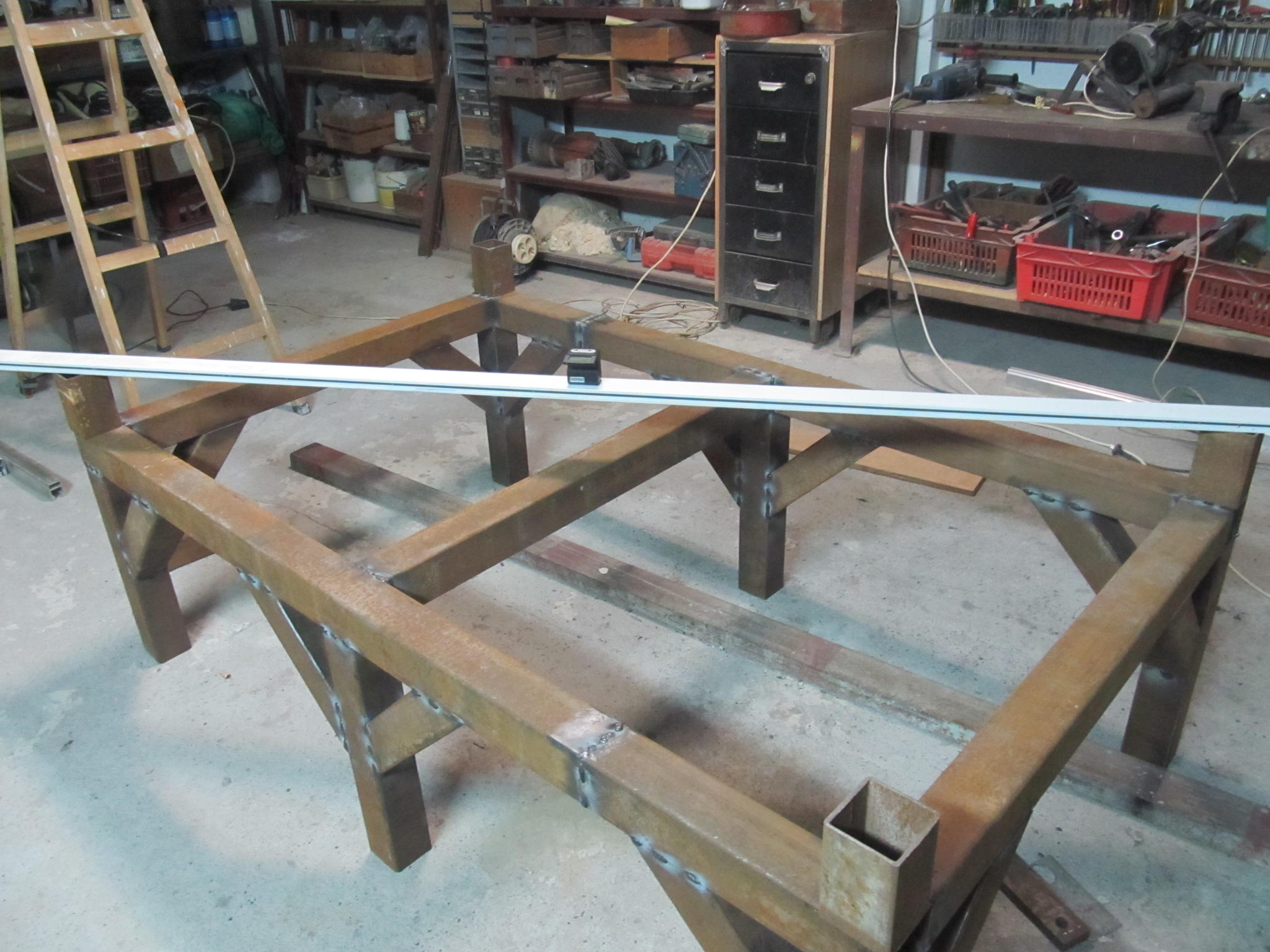

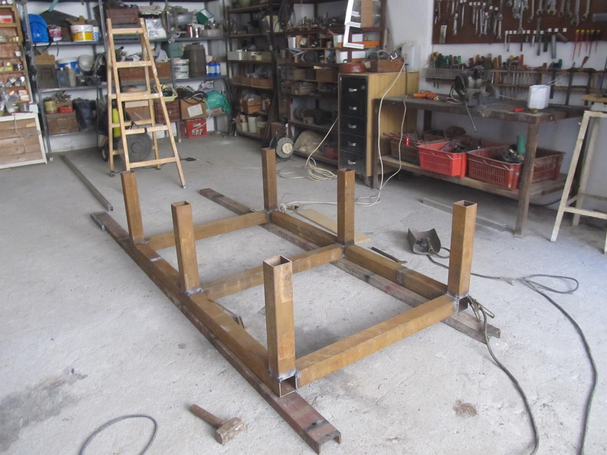

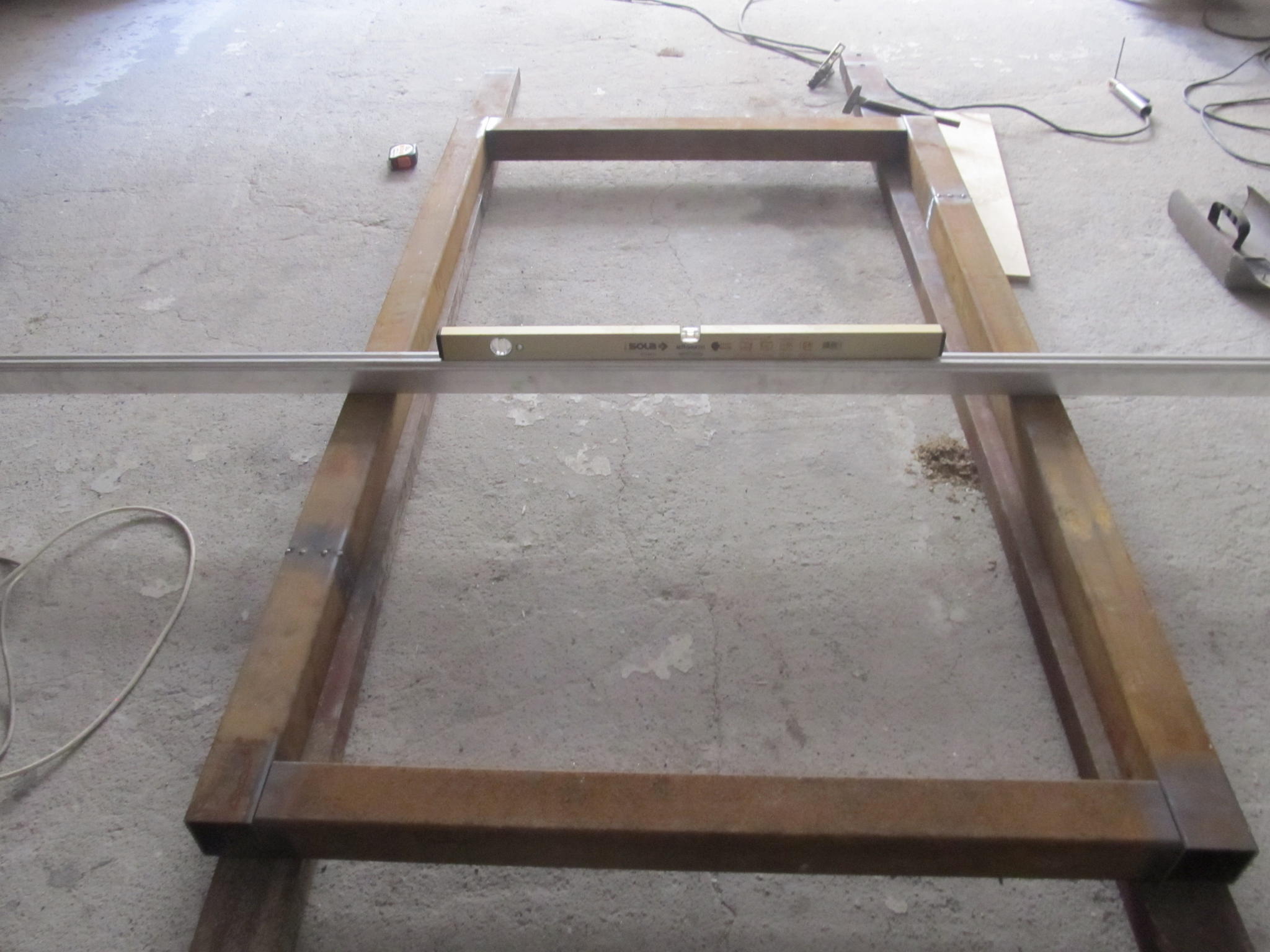

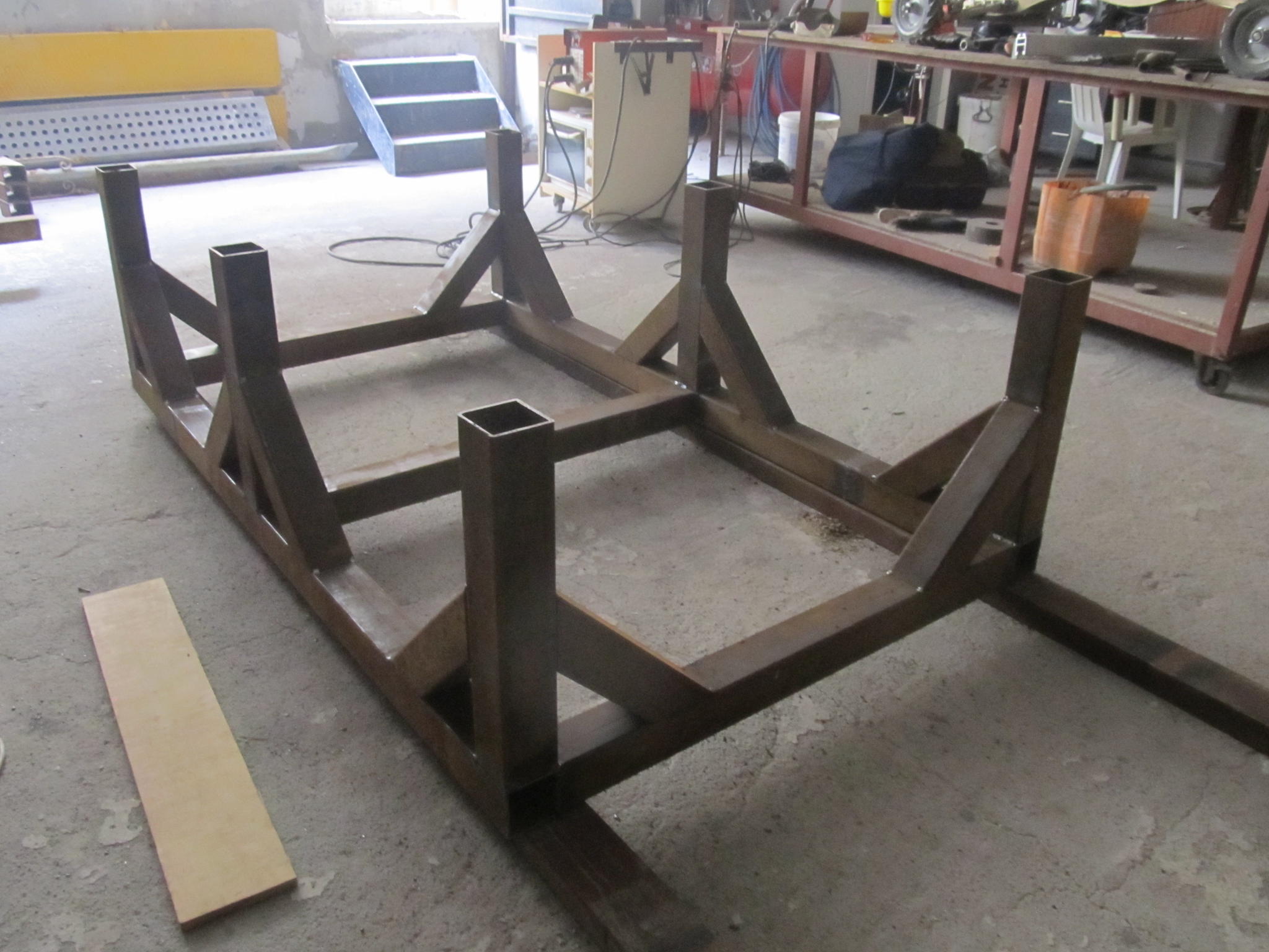

    Hi everybody
    This is the table so far ( the piece in the middle with be removed a little bit)
ID:	12866Click image for larger version.

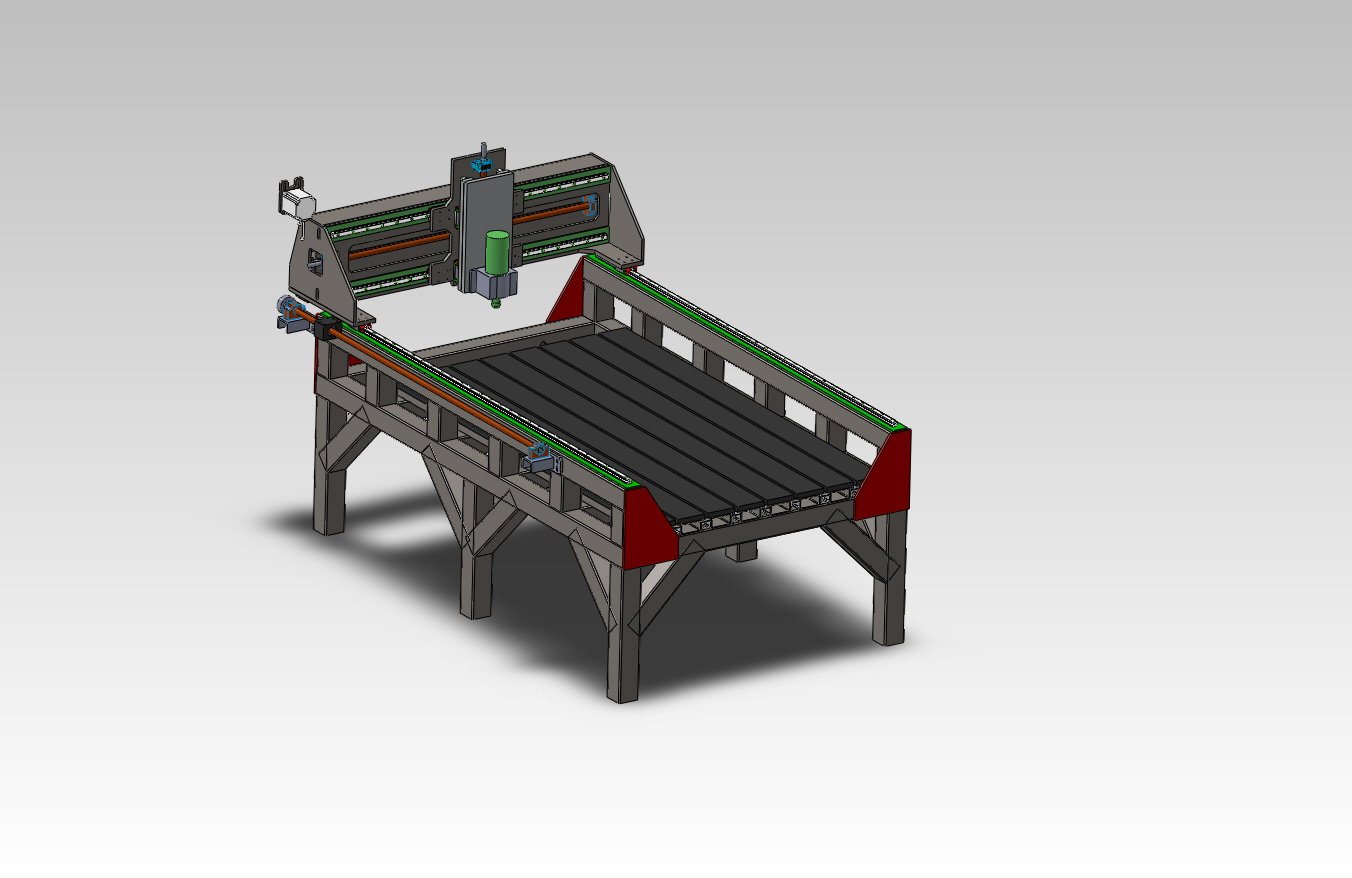

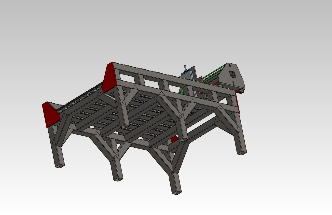

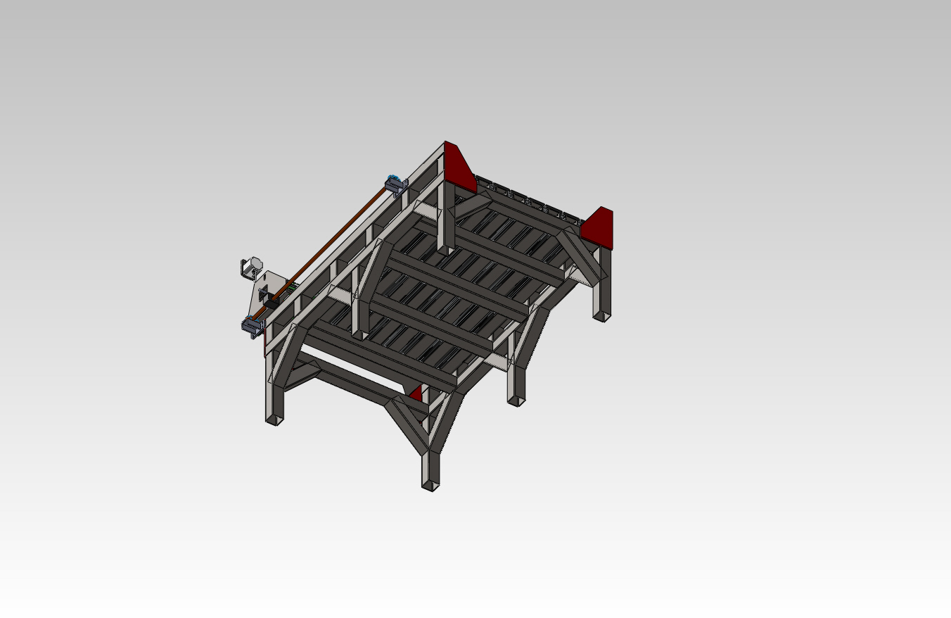

    This is how it will be
ID:	12868Click image for larger version.
ID:	12869Click image for larger version.

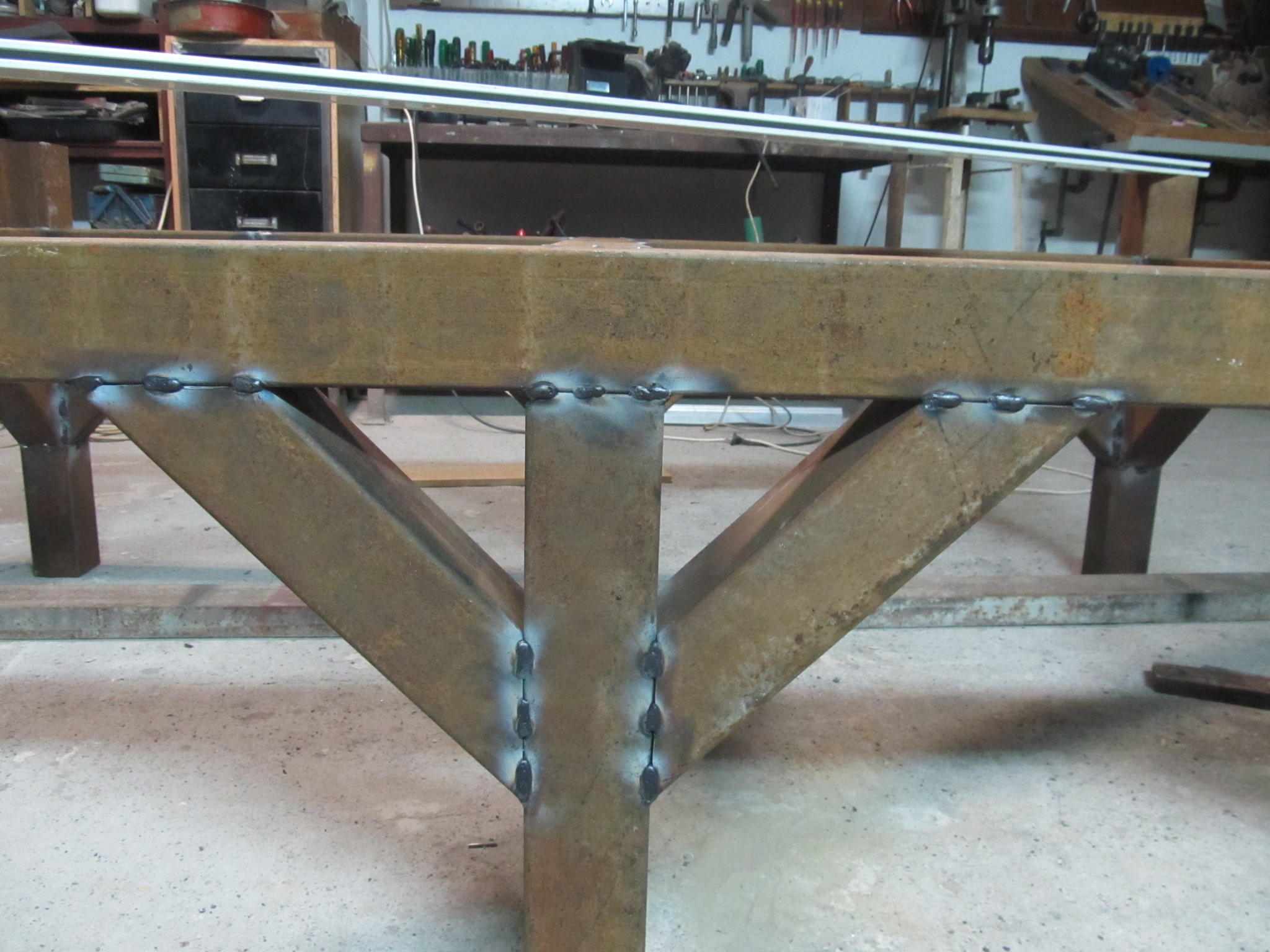

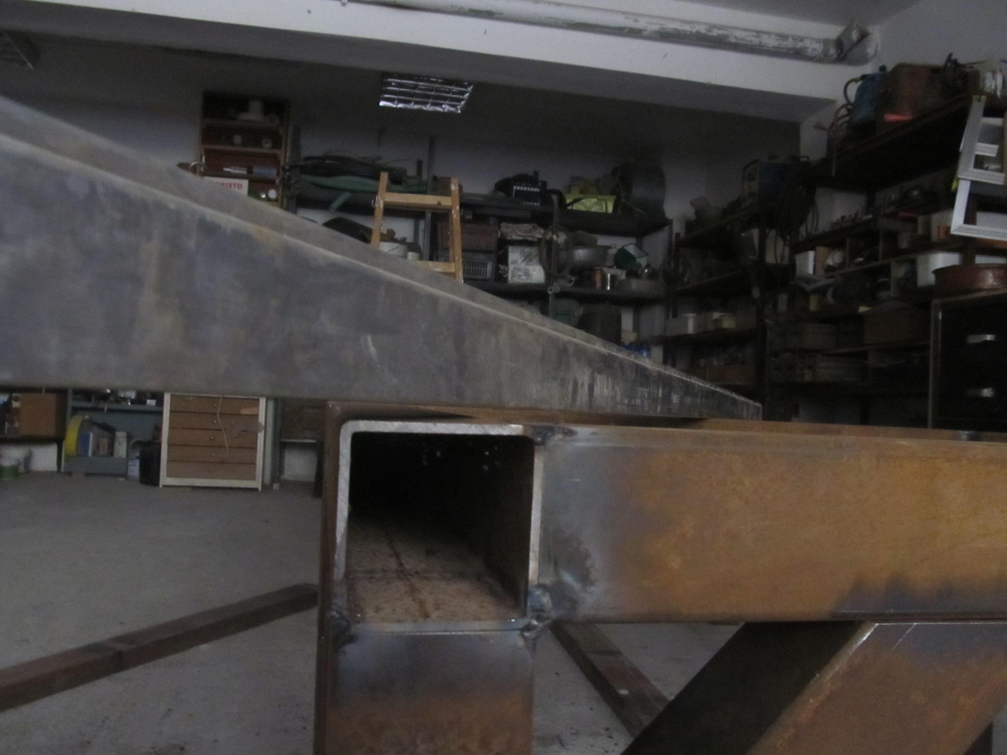

    Two questions
    #1 If you see the the top right photo you will see that i dont make a full welding pass just 3 spot ( edges and at the middle ) in order not to produce too much heat. Is that ok or should i weld all the way?
    # 2 Do you think that more diagonal support will be needed and where?
    Thank for your time
    Vagelis
    The creative adult, is the child who survived
    Quote Originally Posted by ba99297 View Post
    Two questions
    Thank for your time
    Vagelis
    Hi Vagelis,
    #1 I believe what is below the gantry and the gantry itself should be fully welded. Anyways later you will epoxy it for leveling. I spot welded only the Z which seemed strong enough/on my build i mean/
    # 2 To me it seems there would be no need, especially with your monstrous table bed
