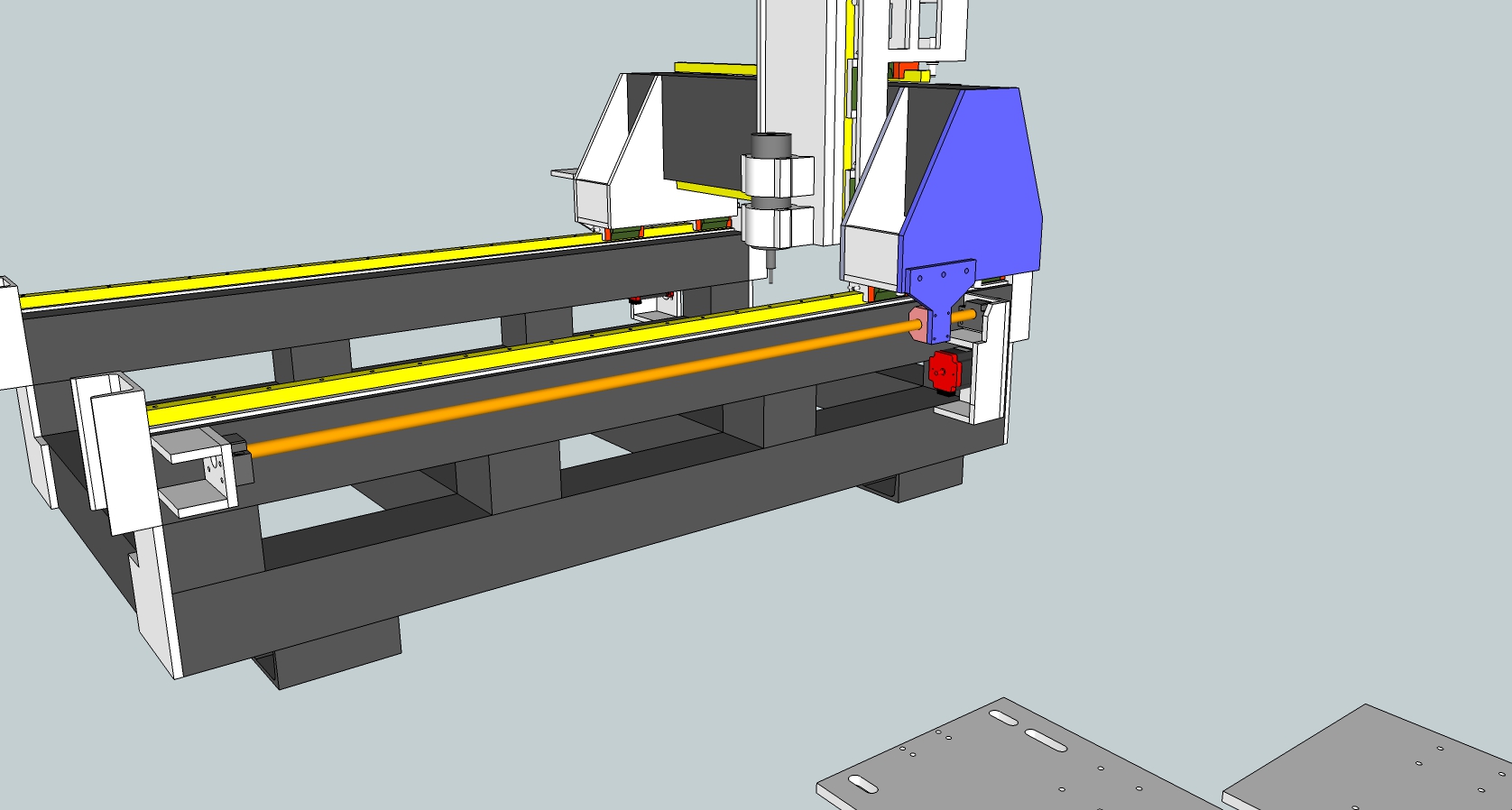

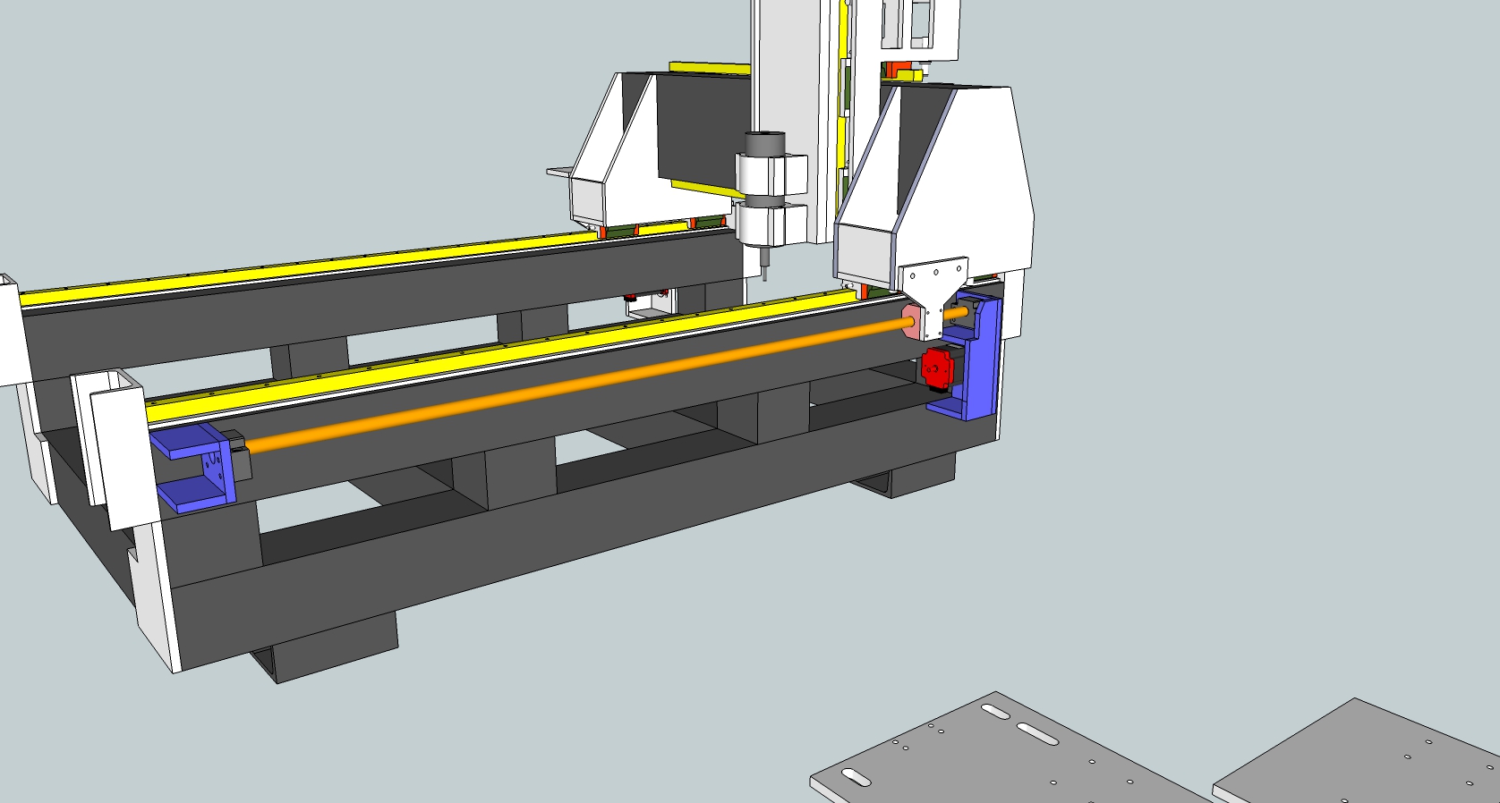

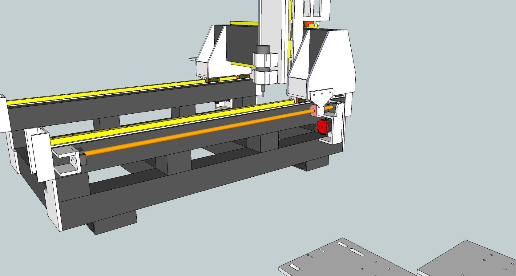

    I bought M25 or so bolts for the machine, soldered the nuts to the legs, thinking that will hold. When the machine was ready i left it on the nuts only and they lay on the hockey pucks. cause i did not find M25 bolts sturdy enough. On your machine M25 6cm bolt on the legs will shake like a plastic, once that heavy gantry starts accelerating.
    The pucks are made from hard PU rubber. make sure they are the solid ones, not refilled with something.
    You call 1cm imperfection , i have to deal with 6-7 cm inclination in my garage and i plan to level it with cement. Thats what is best to do, to level the floor under the machine. If i had to deal with 1cm, i would simply stick 10mm steel plate below the leg.

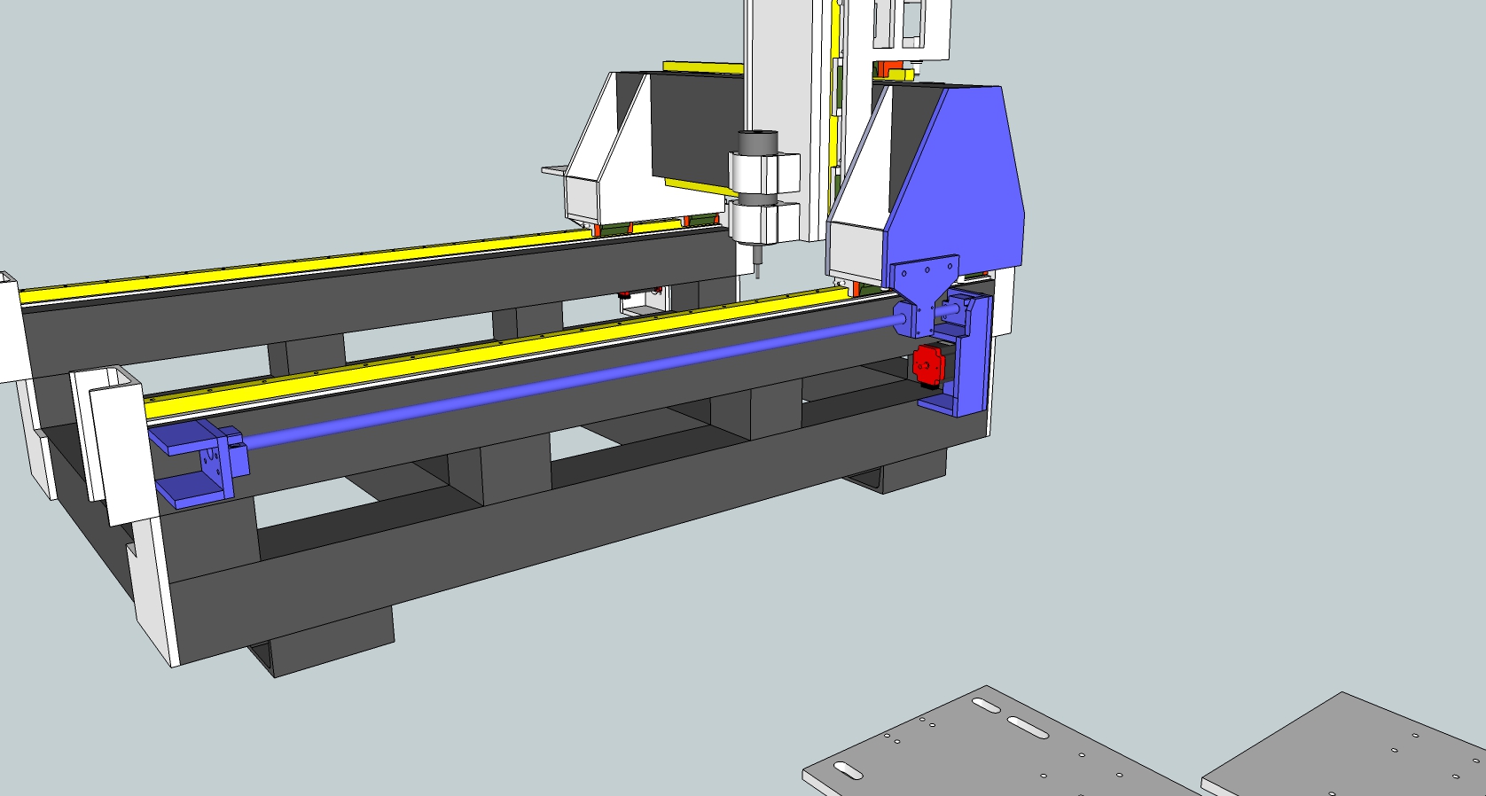

    Translate for you design:
    I meant these pieces in blue Not to be welded until the gantry is ready and mounted and rectified in all directions:
Name:	AutoSave_cnc 100x100x3 profile x400y1000z200.jpg
    Then bolt these 2 together with a piece of paper between them/that for the later paint thickness
Name:	AutoSave_cnc 100x100x3 profile x400y1000z200 2.jpg
    Then bolt all that is in blue together as it would be at the end, trying all bolts to be in the center of the holes. the bolts must not be tightened very much
Name:	AutoSave_cnc 100x100x3 profile x400y1000z200 3.jpg
    Now move to one end the gantry and spot weld with 5- 6 spots 1 of the pieces in blue from the first picture. Rotate by hand the screw and move to other end of machine. Now you spot weld the other fixture.
    then dismount all in blue, ballscrews , etc. Then weld well the 2 fixtures. No everything is in parallel/guide rails and ball screws/ and perpendicular/ball screw supports.
    When painted and ready, mount them the same way. So the only necessary adjustment will me made by the play of the bolts that hold the ball screw end supports to the fixtures. Tighten them when gantry is at that end.
    In other words, now all 2 rails and 2 ballscrews are exactly parallel and have exactly same travel. Doesn't matter if one is up or down, otherwise using other method that also should be taken care of.

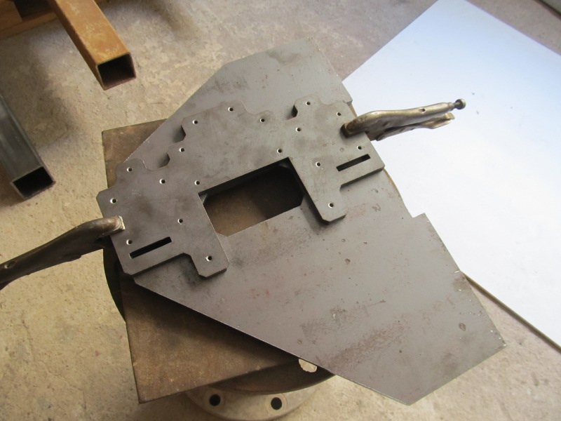

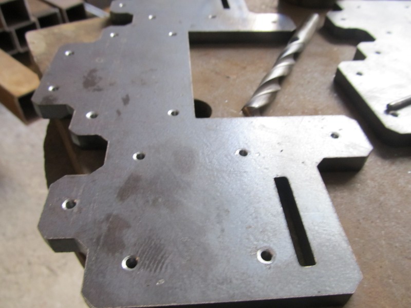

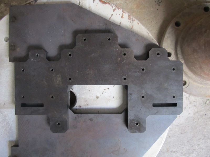

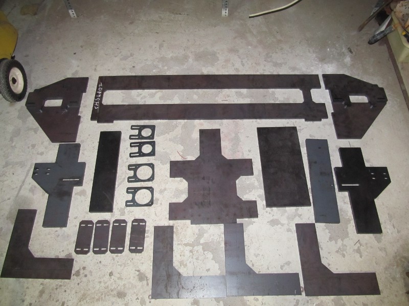

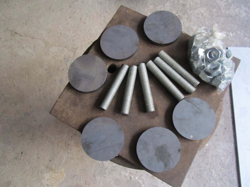

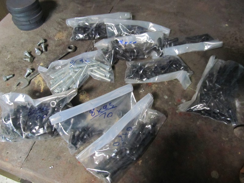

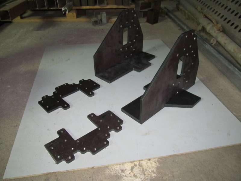

    Firstly i get the bolts and the steel pieces laser cutted last Friday
ID:	13035Click image for larger version.

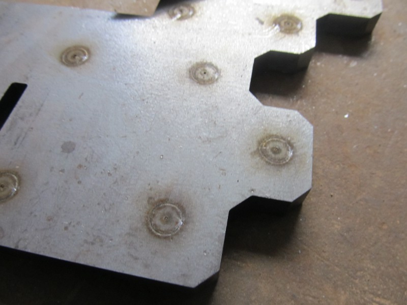

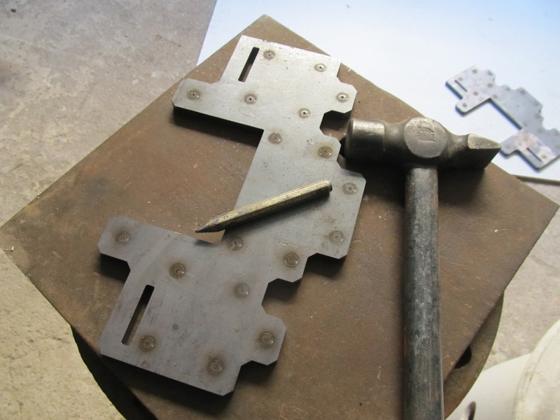

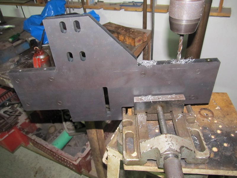

    In order to save money i didnt laser cut the holes ( wherever needed ) except the straight slots. I just ask to point the center of the holes
    So i use these centers and then i drill the holes

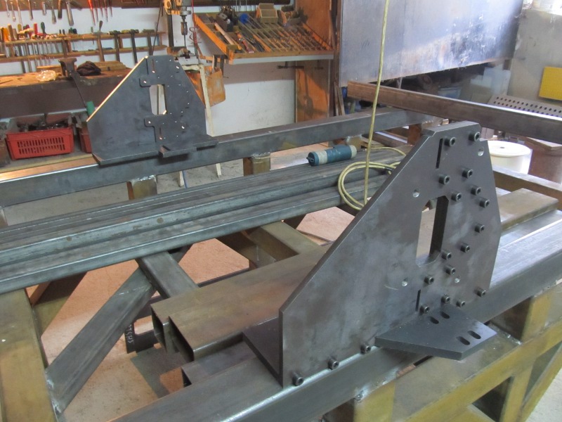

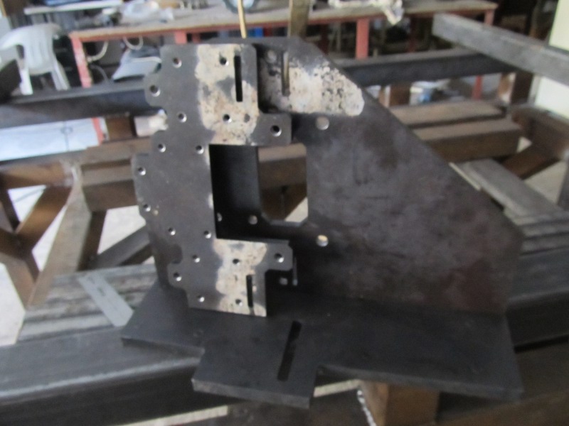

    At the following photo you can see two pieces that will be bolted together. The upper piece will be welded with the gantry tubes and then it will be bolted with the lower piece. The holes of the two pieces should be excactly coeficient so i drill the upper piece an the i put the one piece over the other to mark the ceter of the holes
ID:	13040Click image for larger version.

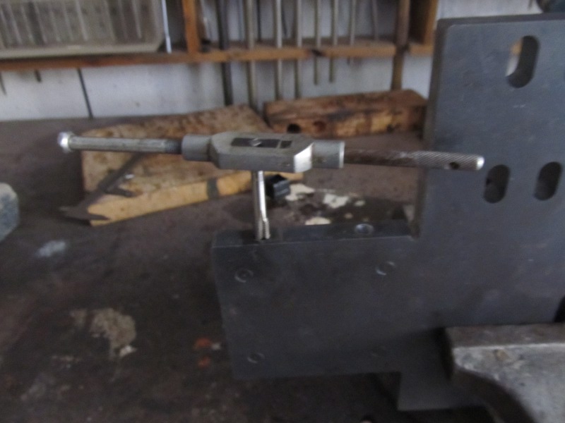

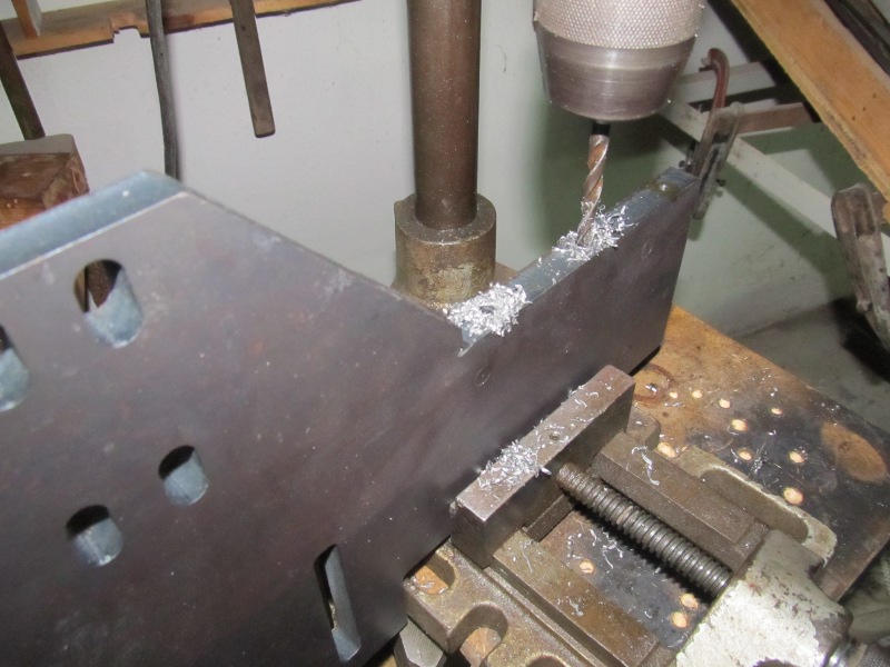

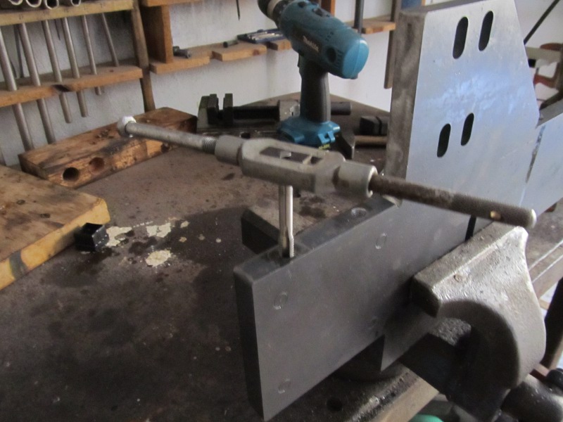

    After pointing the centers i had to drill the holes. That took me A LOT OF TIME. Even more time i need for the tapping
ID:	13042Click image for larger version.
ID:	13043Click image for larger version.

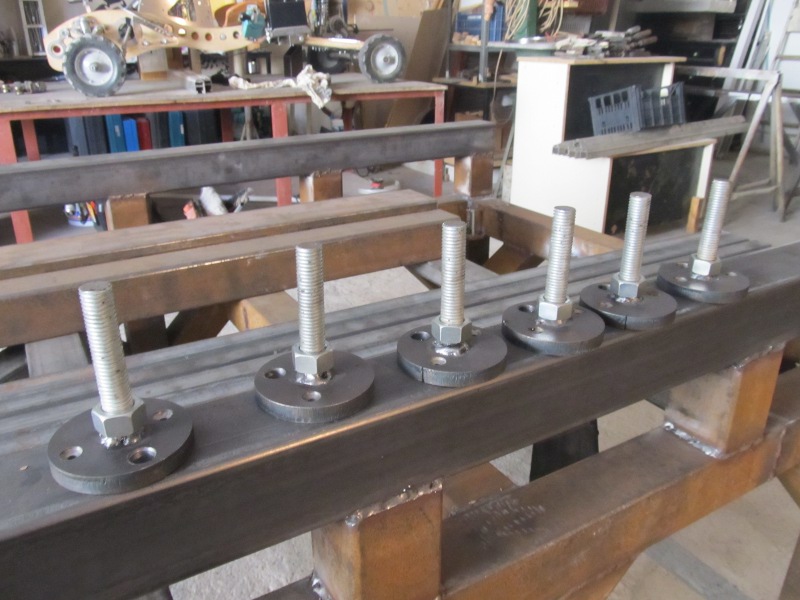

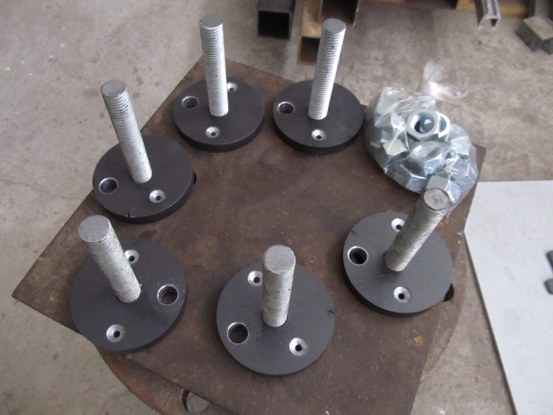

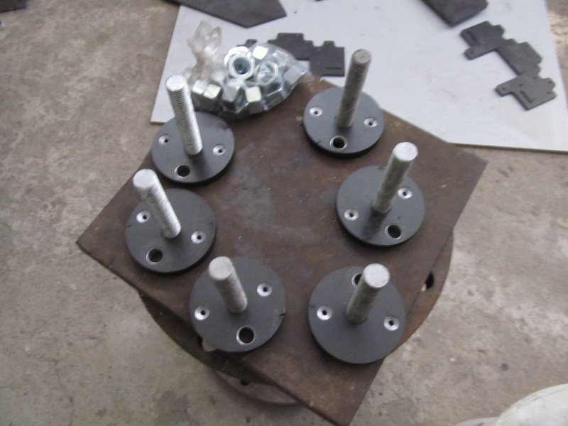

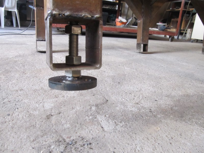

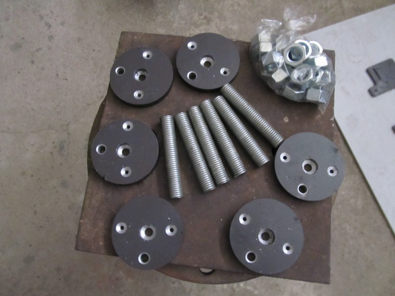

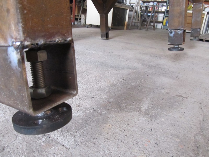

    Today i start the adjustable foot construction. Syliavski suggest me not to put that foots. Even if i use them or not they are very usefull to level the table as perfect as possible for the epoxy method. You will see each foot has 4 holes. The one at the center is for the bolt the other two ( the smaller ones ) are to bolt a softer material at the side of the foot that touch the ground. The fourth hole is for bolting the foot at the floor
ID:	13045Click image for larger version.
ID:	13046Click image for larger version.
ID:	13047Click image for larger version.
ID:	13048Click image for larger version.

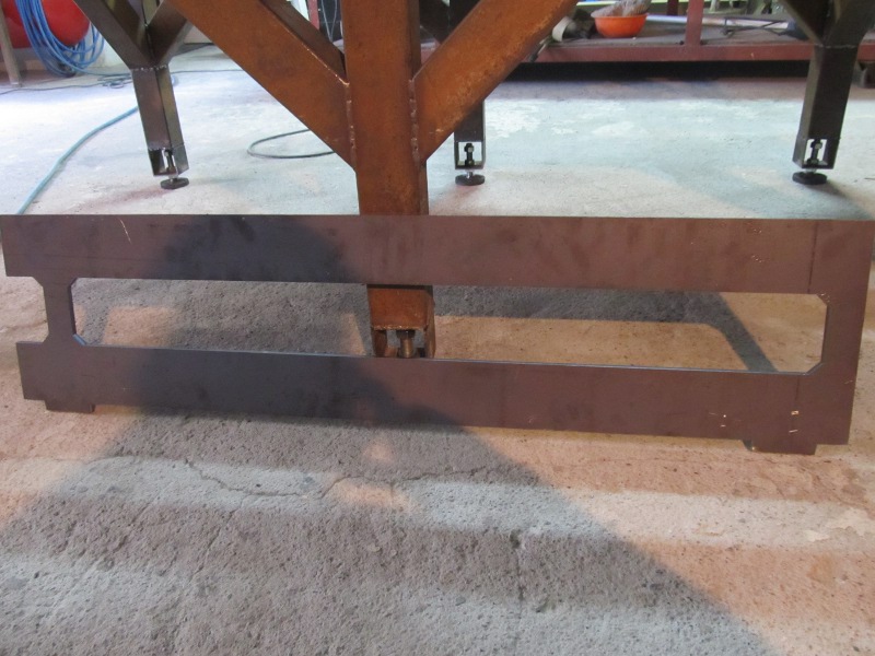

    Then i lift the table with the winch and put the foots
ID:	13050Click image for larger version.
    After that i go on with the tapping. Too much time but the result was more than good

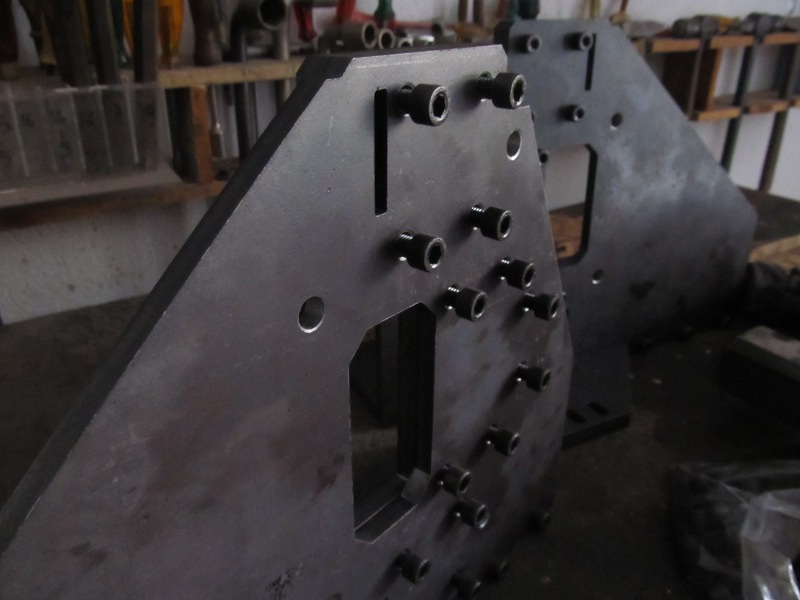

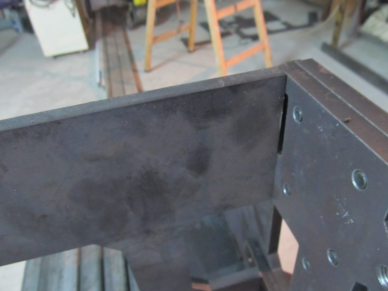

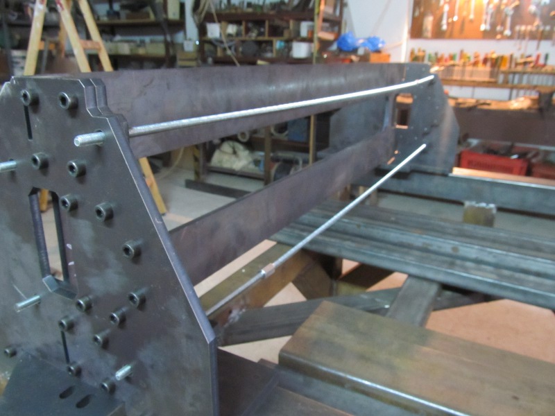

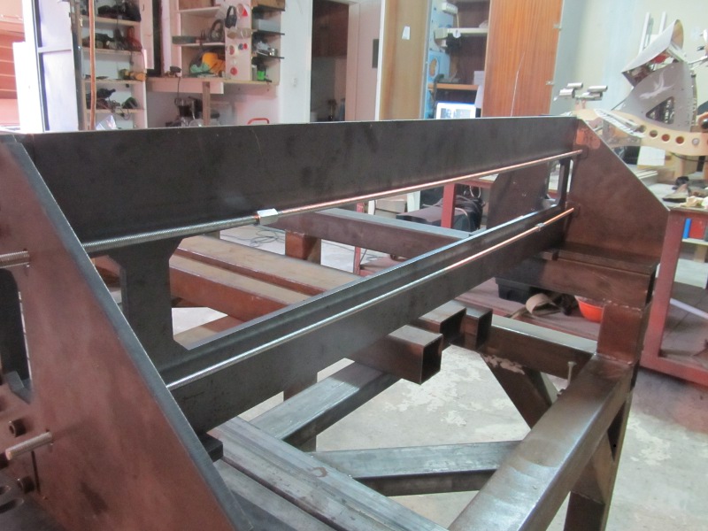

    After i bolt the side parts i start to work with the gantry. I put the two side braces on the table and then i attach the vertical 10m plate.
ID:	13056Click image for larger version.
    If you can see the stell plate has two projections ( left and right ) that will "sit" at the side braces so that the distance will be driven by these slots. It is something like a tagram.
    Then i use long bolts to "tune" the gantry
ID:	13059Click image for larger version.
ID:	13060Click image for larger version.

  10. #139
    The laser cut parts look great, I like how the holes have been marked with both a centre and an outline of the hole. This is good engineering practice and I don't know if you already know this but if the drill moves off centre this is how to bring it back into line;
    If the outline of the hole had not been marked you would not know if the drill had moved off centre.
    https://www.youtube.com/watch?v=ESWzx3YBo3g
  11. #140
    Nah good engineering practice is to do it right first time and use a proper spot drill not some poxy pin prick mark.!!
    Looking Good Vagelis don't drop it on your toes mate. . .Lol . . . . . .Drilling & Tapping 100's of holes in 10mm steel is good for building character and stamina needed to setup and run CNC machine. .
