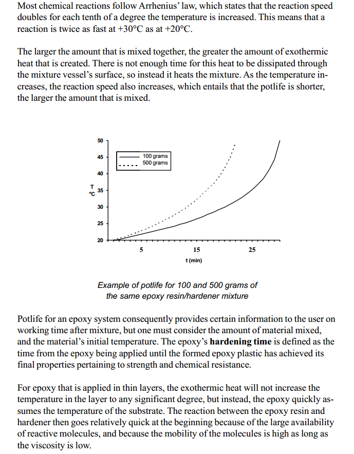

    very interesting book and fast to read. http://nilsmalmgren.com/Laddas/Epoxy_handbook.pdf
    from the book:

    Just read at Spanish forum that the epoxy i was aiming for did not harden properly when the mix volume was very small - 10g. Thats another good reference if the epoxy is any good or crap... How it behaves when the mixture volume is very small. So its a "no go" for me and i will be ordering the West System today. After spending 5k for my machine i don't see a reason for saving 80euros.

    Could you do the 10g-20g mixture test if you have anything left? To see what happens?
    How should the test be done ? what are we looking for ?
    Just mix a very small amount, 20g in total and see if it hardens well. Should use a precision scale though. The idea is that the epoxies if don't behave well in very small quantities but behave well when mixed half kg for example, are poor quality.

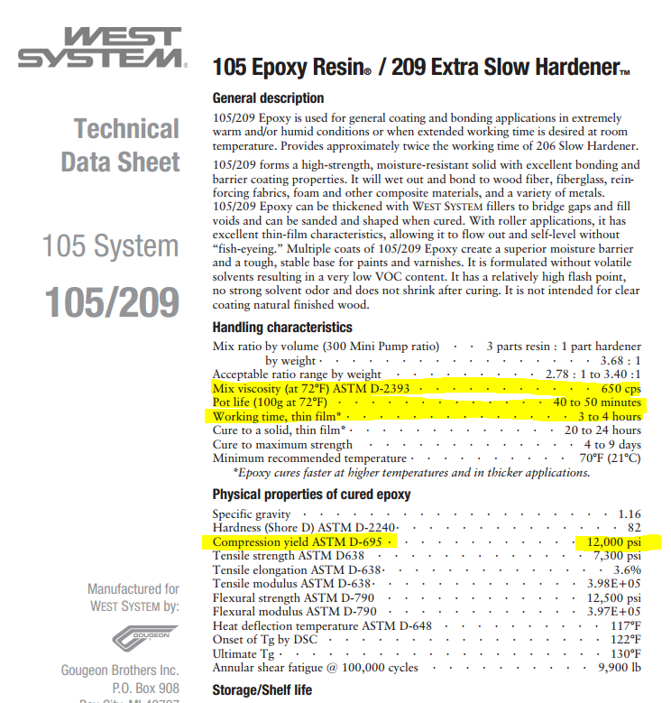

    PR 220 (resin) with EM316 (hardener ) has 120-150 minutes pot life
    PR 220 (resin) with EM317 (hardener ) has 200-250 minutes pot life !!!! but not curing at room temperature
    Here in Greece they import only 315 hardener to be combined with PR220 resin. This hardener suppose to be the fast, but it has pot life 50-60 minutes 200 gr at 25C ( when west system 105+209 has 40-50 minutes 100gr at 22 C). When i ask about the price ( here in Greece ) they told me 22 euros+vat but am not sure if they are talking about the PR220 or PR102 resin. Have a look.
