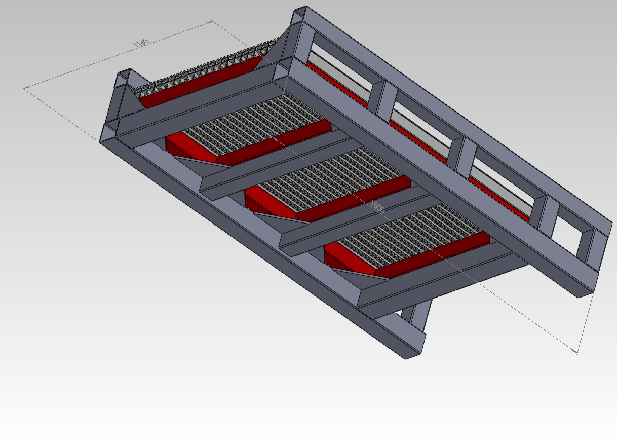

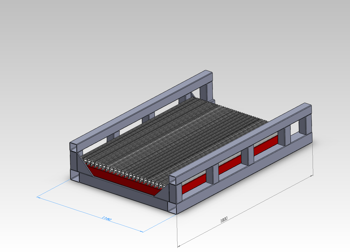

    After thinking that welding all the beams together, according to the previews plans i would have issues with the big weight, i decided to split the contruction into two , the bench and the CNC that will sit on that bench.
    So i introduce the CNC pictures first
    So i have the main frame

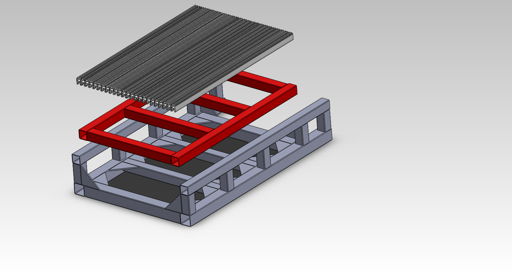

    Then with the red color is the cutting table made by 80X80X5 beam
    over the cutting table i will put aluminium profile tha will be bolted on the red cutting table. That profile has T slot for clamping item that will be cutted
    And here we have some picures of the construction with all the items together
ID:	11107Click image for larger version.
Name:	front close.JPG
ID:	11108Click image for larger version.
ID:	11109Click image for larger version.
Name:	isometric bottom.JPG
ID:	11110Click image for larger version.
ID:	11111Click image for larger version.
    if i want more depth for 3d cuts i will remove the cutting table(80mm) with the T slot( nearly 40mm) and i will put a 20mm mdf. That will give me about 100mm (80+40-20) more depth
    I am waitting for your comments

    Nice. Looks great,
    What size of the steel profile you decided on? If 80mm or bigger, you don't need the triangular plates. Believe me, will not move. Reason - the short profiles will hold it firm enough. If you insist, make them L shaped, so they will not bother you fitting longer than the table pieces.
    And as for the size of profile, i am with Jonathan. Bigger the profile, the better. If resonance, its easier to drill a hole and fill it with something later.
    I said it earlier some where but one of the best ways to fight resonance is avoiding perfect symmetry in the machine, meaning all pieces spaced same distance and mirrored exactly. Offsetting each piece even by 1cm here and there will have enormous impact. Same when avoiding mirroring
    Nice. Looks great,
    At the above plans i use 80X80X5 beam for the red table and also for grey frame except the 4 lower beams that will have contact with the bench. Those four beams are 100X100X4. I think that the triangular pieces will help to achieve triangulation and parallelism and also stiffness.
    I agree with you that if avoid symmetry and mirroring that will help to reduce resonance. As for the beam size i think even 80X80 or 100X100 will not have much difference to the final result.
    The t-slot profiles are aluminium profiles that are used for for clamping solar panels at the roofs. I design the profile from a piece that i had.
    I will come back with the gantry design. I will use one motor for X axis with double ballscrews and i may use double nut (preloaded with a spring) for each side
    I want you opinion about this option. What kind o f spring is suitable for this use and where can I find it. I also would like to know what would be a good distance between Y and Z axis profiled rails ( i will use 20mm profiled rails ). Also what will be a good distance between the carriages of X axis ( outer side of carriages )
    So far thanks everybody for the help
    Vagelis
    Hi Vagelis,
    Looks ok to me. . . . Just a Couple of simple things that will help.
    You could drop those inner triangle braces and just keep the inside corner ones but make them little larger, there will be more room with others gone. Not much gain strength wise from them being there and not having them means less welding which will lessen the chance of heat distortion.! . . . . Would do the same with corner braces for the Bed frame just to help keep it square.
    Also the outer End triangles will be better placed on the outside of the box section and made larger so there is more contact area, they will also cover the ends of the section. Then when you weld just put short welds but on both edges. Again this lessens the chance of heat distortion by allowing short weld runs and balancing the welds pushing/pulling action.
