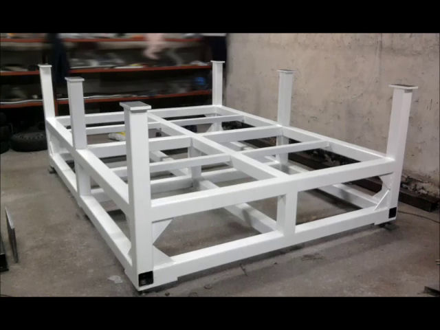

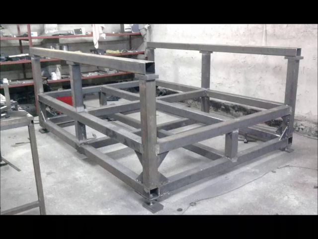

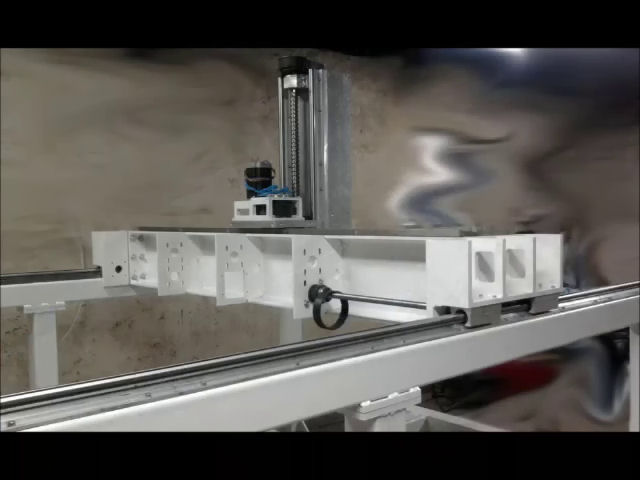

    Just grabbed these out of a video I saw if any use

    details are here 3D Model of CNC Router c4d, obj, 3ds, fbx, dxf, skp, iges
    and it looks like they had to add some triangulation to the legs after these photos

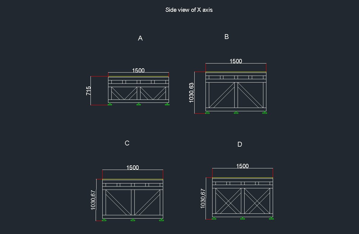

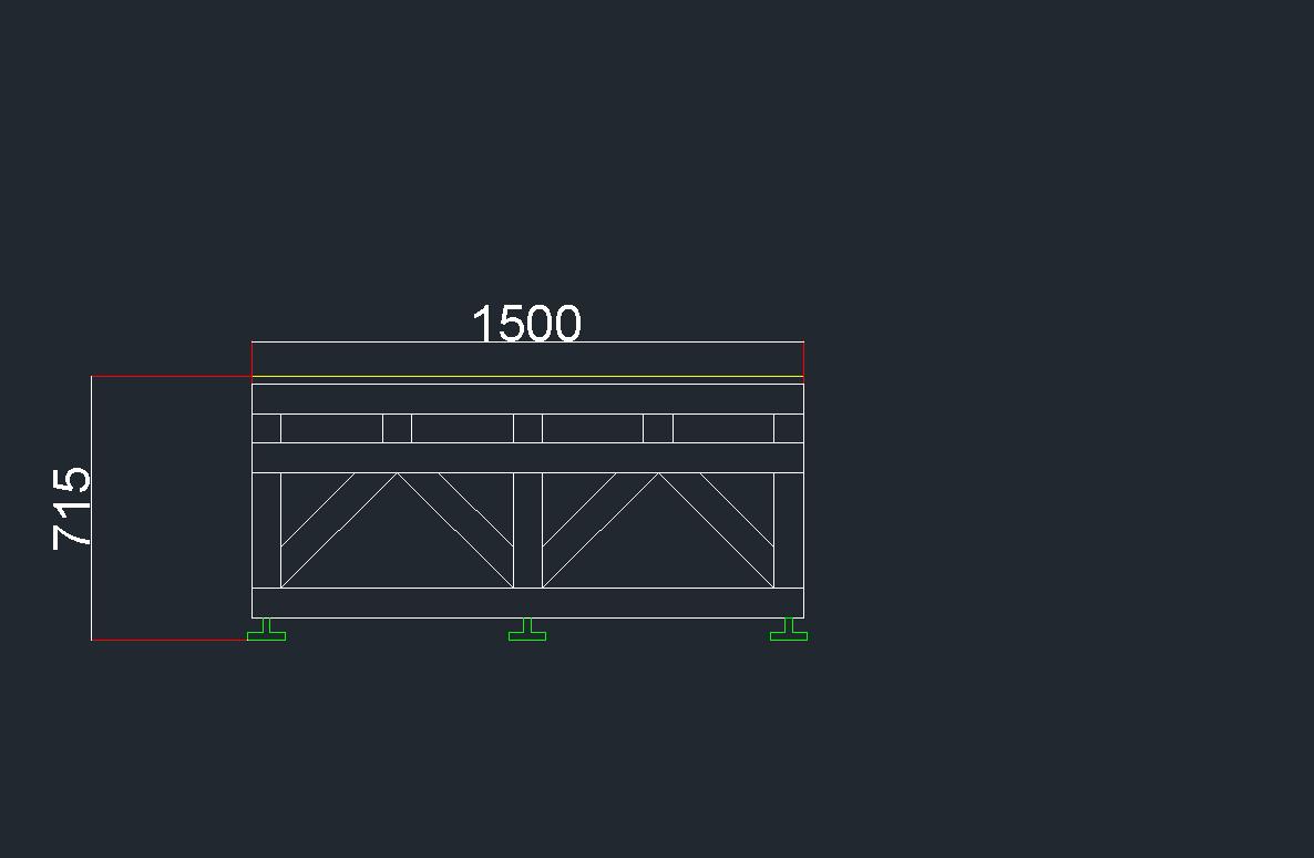

    Here are some autocad plans. They represent side view of X axis. I design 4 solutions ( A,B,C,D )
    The upper yellow line represents profiled rails, and the green color is adjustable legs
    Tell me your opinion.

  6. #16
    I like B but not everyone will
  7. #17
    I like A but if i were you, would turn the 4 diagonals 180 degree/ mirror them upside. That will separate on smaller sections and support even further the X rails support + when pushed from upside will make a stretching force to the lower beam, not pushing, as it is now.
    I mean instead of MM WW
    If full height is desired, as Eddy says B is best, simple and strong + the diagonals will stretch again the lower beam, if pushed from above. And we all know steel can not be stretched

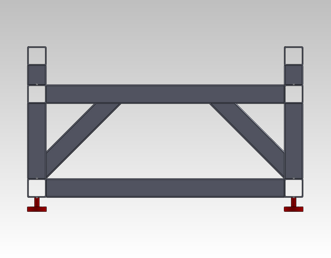

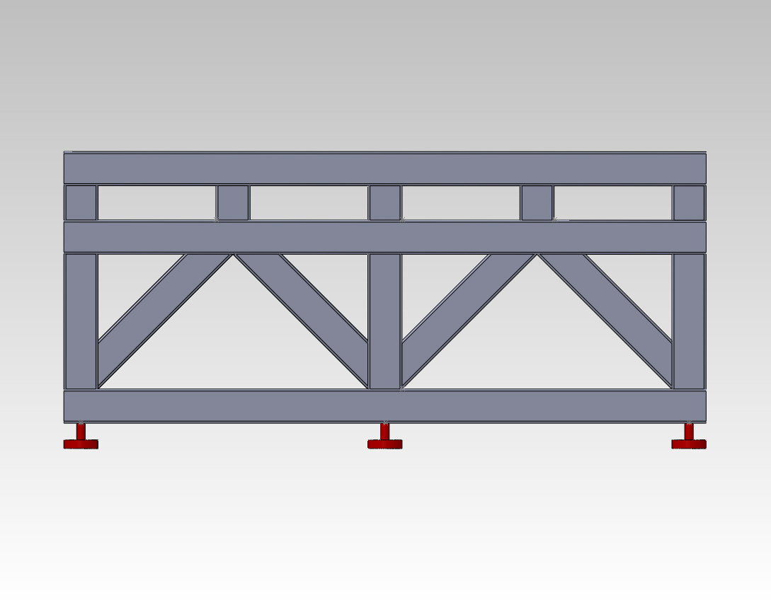

    Silyavski before i check for any new post at my thread i design in autocad this
Name:	cnc table side view X axis 2.JPG
    and then i read your post
    I think that we are thinking in the same way
    To be honest you inspire me for my table plan ( especialy for the rail support beams ) thank you.
    Aslo thanks everybody else like Eddycurrent and of course Dean for their ideas
    Day after day, thread after thread post after post i feel that the knowledge and the experience of people that willing to help, give me the ability to make a solid machine. You know it is very important to make a step and have no question to be answered. That is what i almost fell now about the table plan. May be some small changes will be done, but the basic consept i think is this.
    I will post 3d plans soon
    PS A machine that is having rail height at 70 cm from the ground, has any disadvantage compared to a machine that is having rail height at 90-100 cm from the ground?
    I will be happy to hear any other advice.
    The only question that is waiting for answer is the beam dimensions 80X80 or 100X100 and of cource the thickness

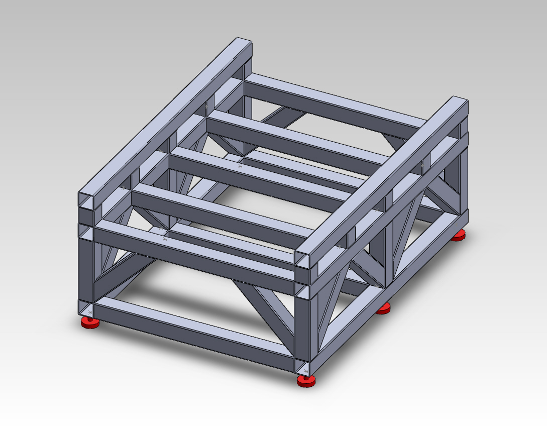

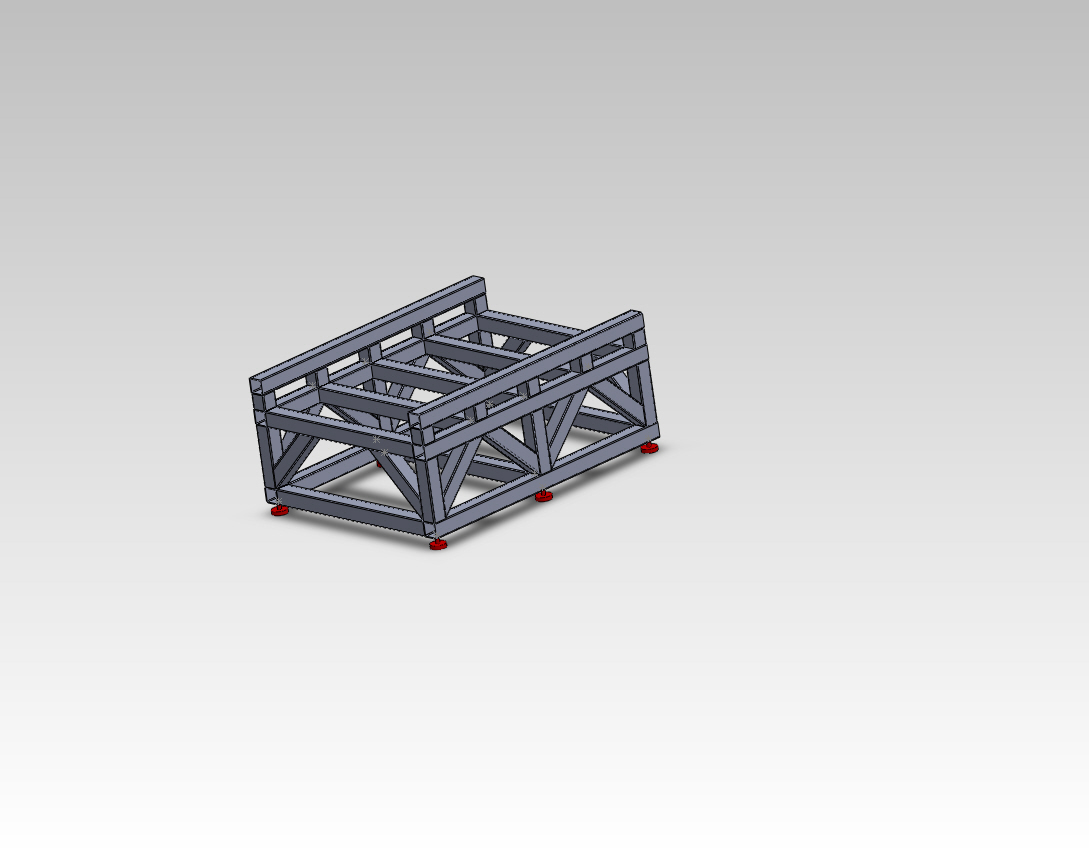

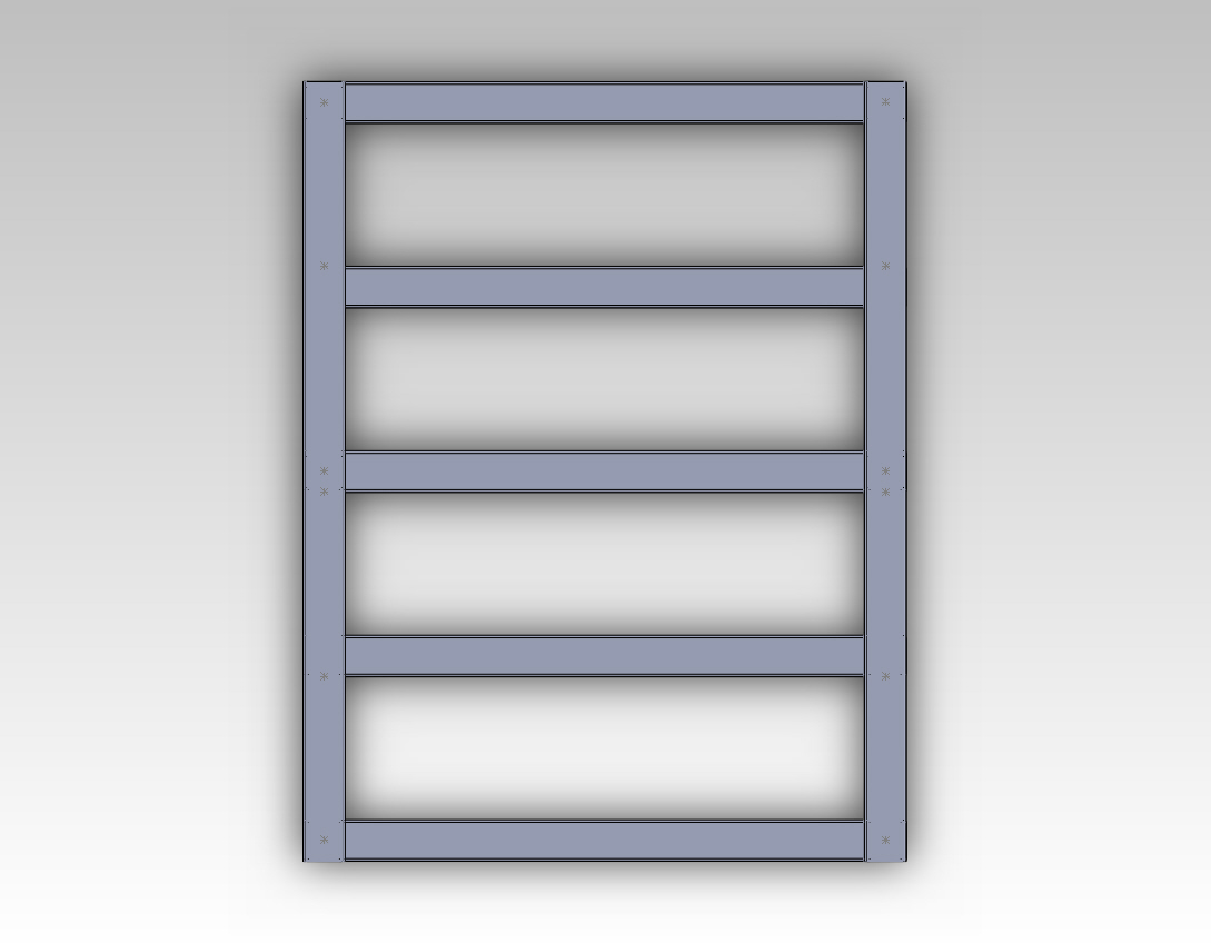

    And here i have some 3d plans.
    I will come back with another plan a little bit different

  9. #19
    It will work both with 100x100x3 and 80x80x 3 or 4mm. Depends on how strong would be your gantry, what spindle you will like to mount and how further you will like to push it.
    I suggest you make your gantry from 2 pieces of the same profile you will use soldered together, hence 200x100 or 160x80 or do it from aluminum, the way Dean makes his machines, with a ball screw hidden in the gantry, depends what means you have.
    The drawings look very good. Now if you aim at certain weight or to be able to pass through normal 1m wide door, don't make it higher . if you want to make it higher and at the same time light, just make the legs longer. Also if length, weight is a problem, you can lift the 4 lower beams to the middle of the M , and remove the middle leg below this point, this will not compromise the strength.
    If you aim aluminum and hard stuff mainly, maybe a gantry like Jonathans will be better, look at his exemplary build
