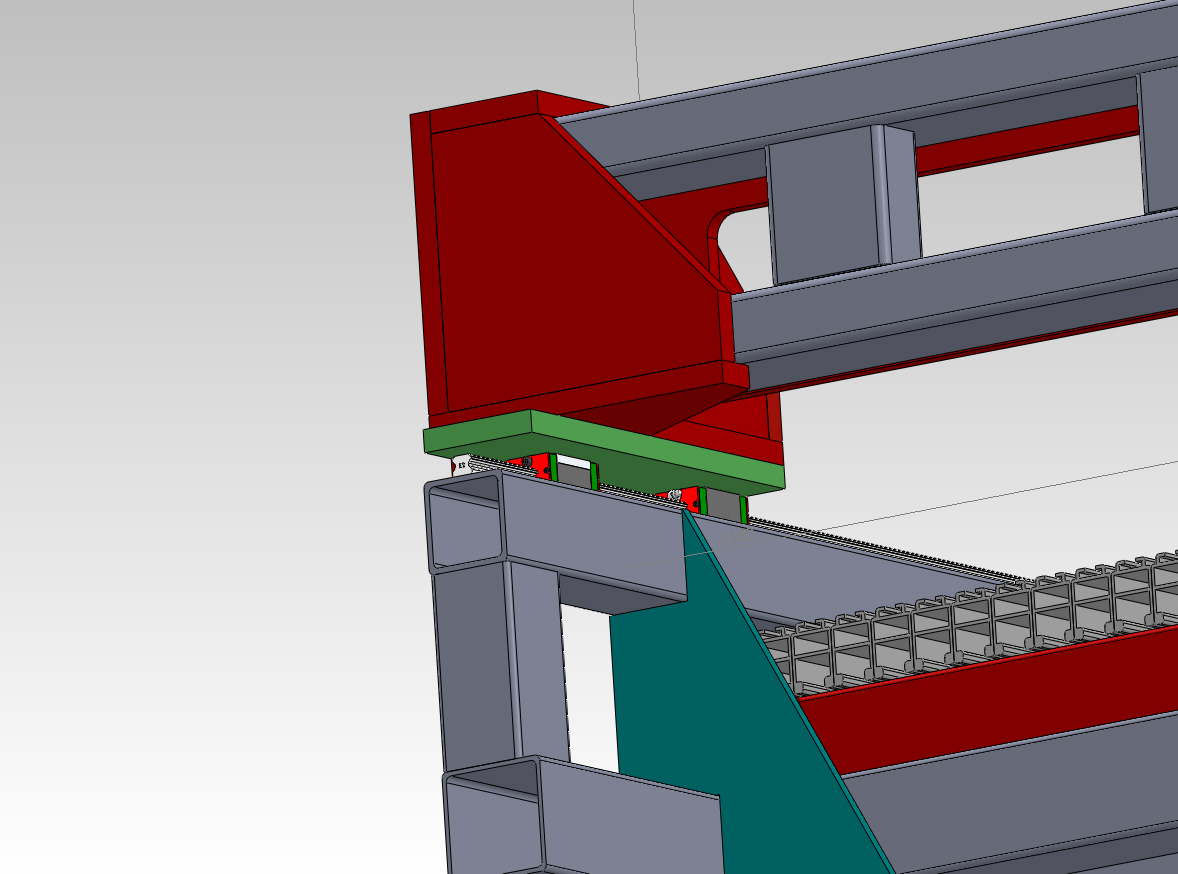

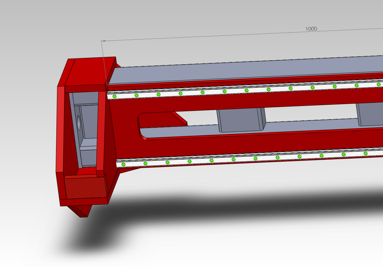

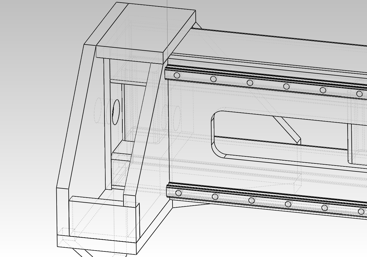

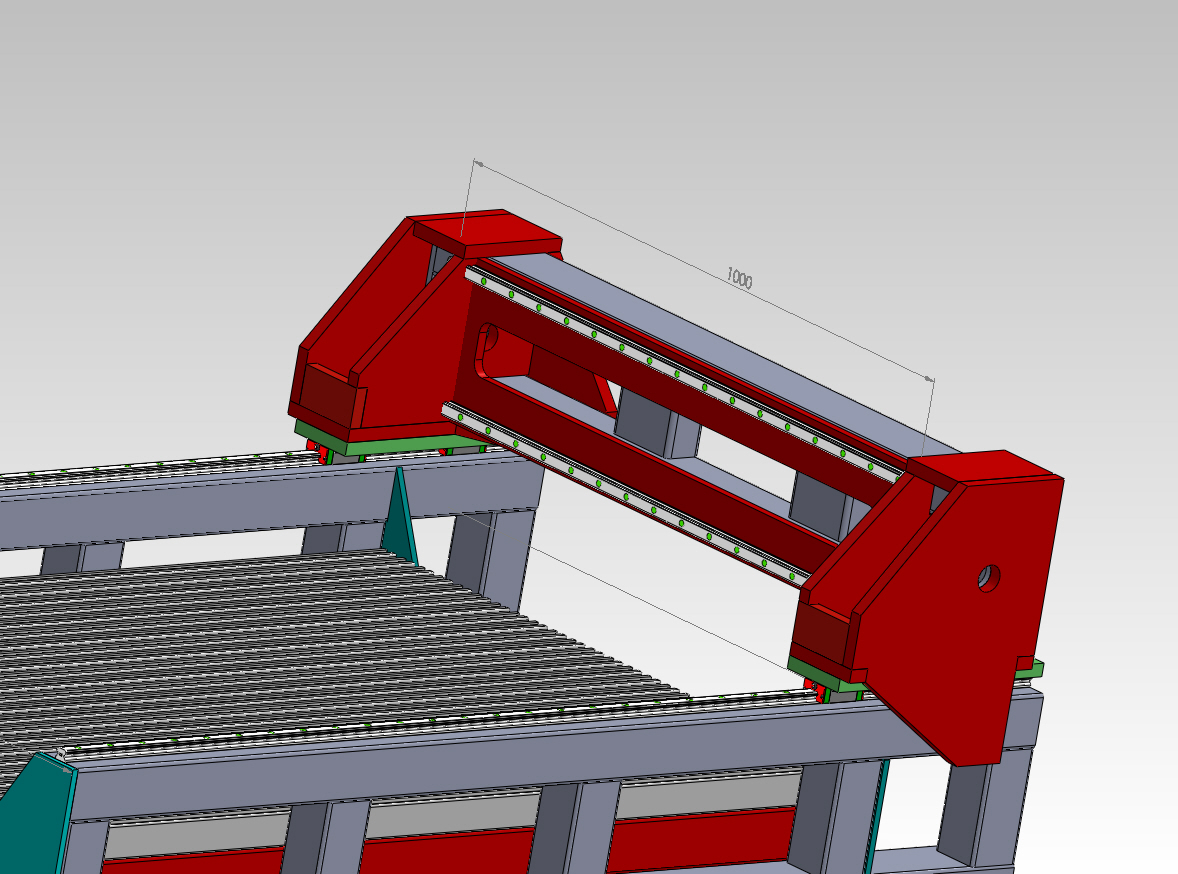

    To be honset i think the green plates are a little bit wrong

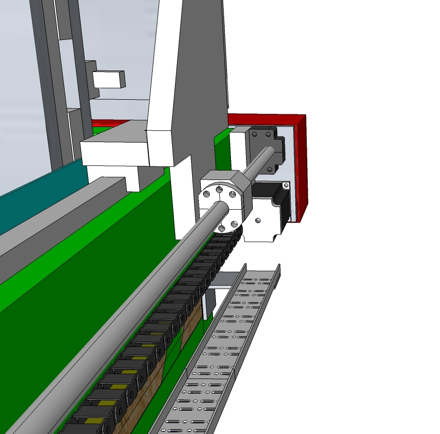

    I must correct the design. I am thinking of make the green plates square and connect the ball nut on the external red aluminium plate that will be designed longer. I dont know if i am understood, so i will design and come back later. Eddycurrent thanks for your answer.
  2. #62
    Yes I see what you mean, the red plate must come below the level of the rails to both protect the ball screw and also to allow mounting of the ball screw to the outside of the top beam.
    But will there be enough room between the extended red plate and the beam to fit the ball screw in. ?

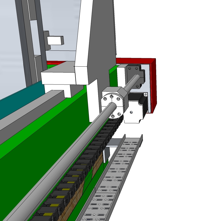

  3. #63
    If you see photo number 13 you will see how much space there is. This space isnt enough to match the ball screw between the plate and the 80X80 box beam. So i could even make the gantry a little bit wider or match the ballscrew at the outer side of the red aluminium plate. My first thougth was to put the X axis ballscrews at the same vertical plane as the profiled rails of x axis. In that case the x axis ballscews would cross the back plate of the aluminium construction that i use to attach the steal beams with the profiled rails. I dont know if this is a good idea as in this case i will have the x and y axi ballscrews been corsed very close each other.
  4. #64
    I'd extend the outside gantry plate below the X axis carriages and have the ballnut housing attach to this. You might need to put spacers on the frame for the BK/BF ball screw ends but it shouldn't matter. I've done just this with my design. which you and see here...http://www.mycncuk.com/forums/gantry...planes-12.html that way you can mount the x axis carriages on the bottom 20mm ali plate and not have to bother with the green plates?

  5. #65

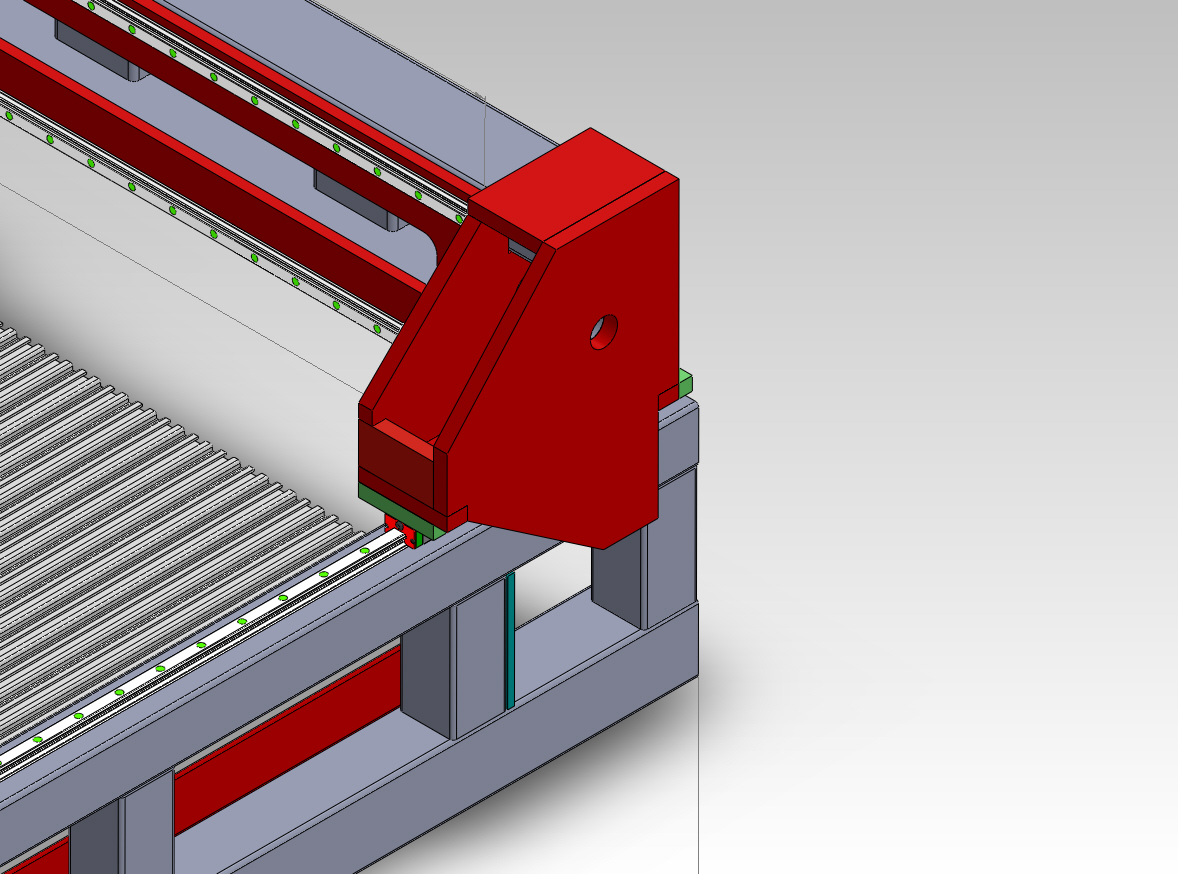

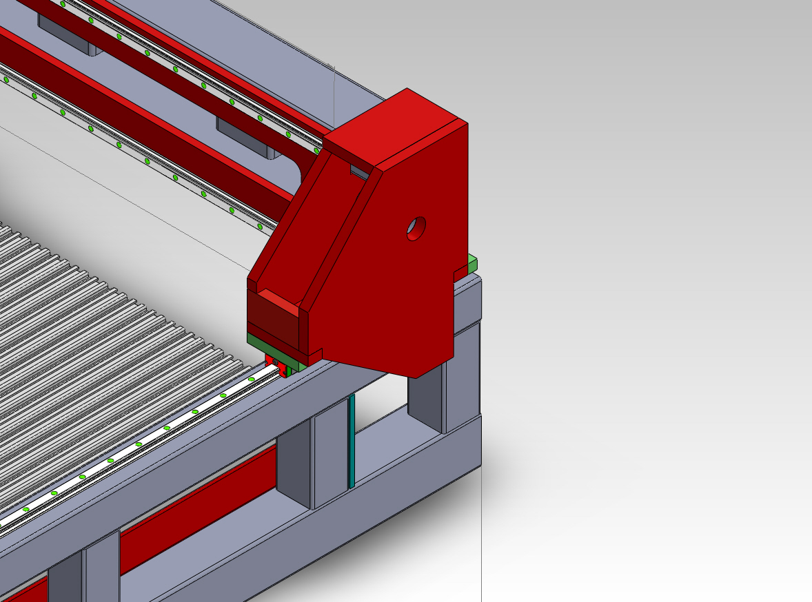

    Some small changes

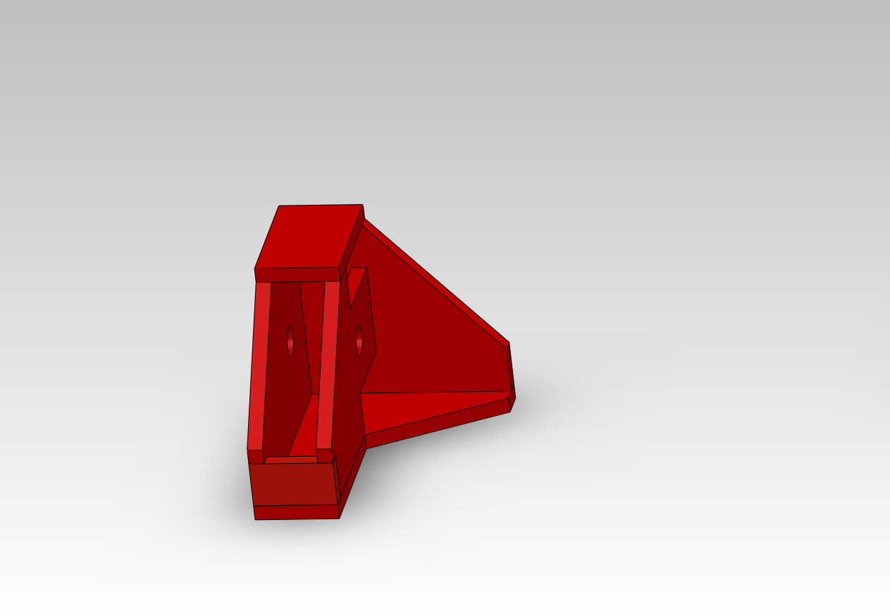

    The green plate(20mm aluminium plate ) will be bolted on the carriages and then i will bolt the green plate with the red plate (20mm aluminium plate)
    Could anybody told me what are the critical spots that i must have freedom to adjust. I think is obvious that the spindle should be vertical with the cutting surface. Is this possible to achieved by putting shims between the red and the green aluminium plate.
  6. #66
    Vagelis can you show an exploded view or See thru view so that can see how Steel fastens etc. This seems a very complex arrangment of plates that may not be required or adding a lot to overall strength.? The design is correct regards gantry sides Etc just looks more complicated than it needs to be.
    I'm also curious to how your arranging the ballscrew/motors because it looks like the steel supports across gantry could clash with ballnut.?
    If you prefer Email me Model.

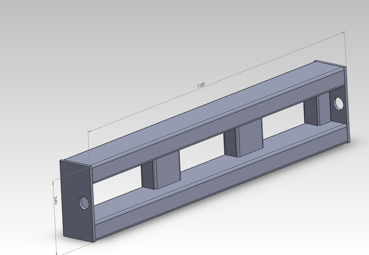

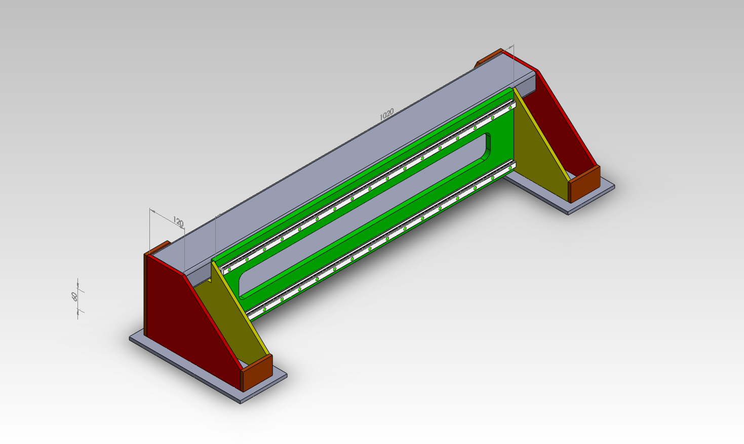

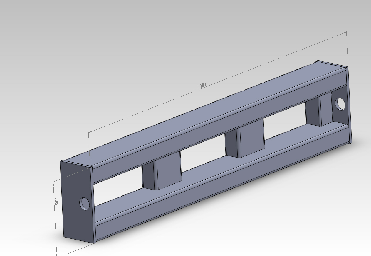

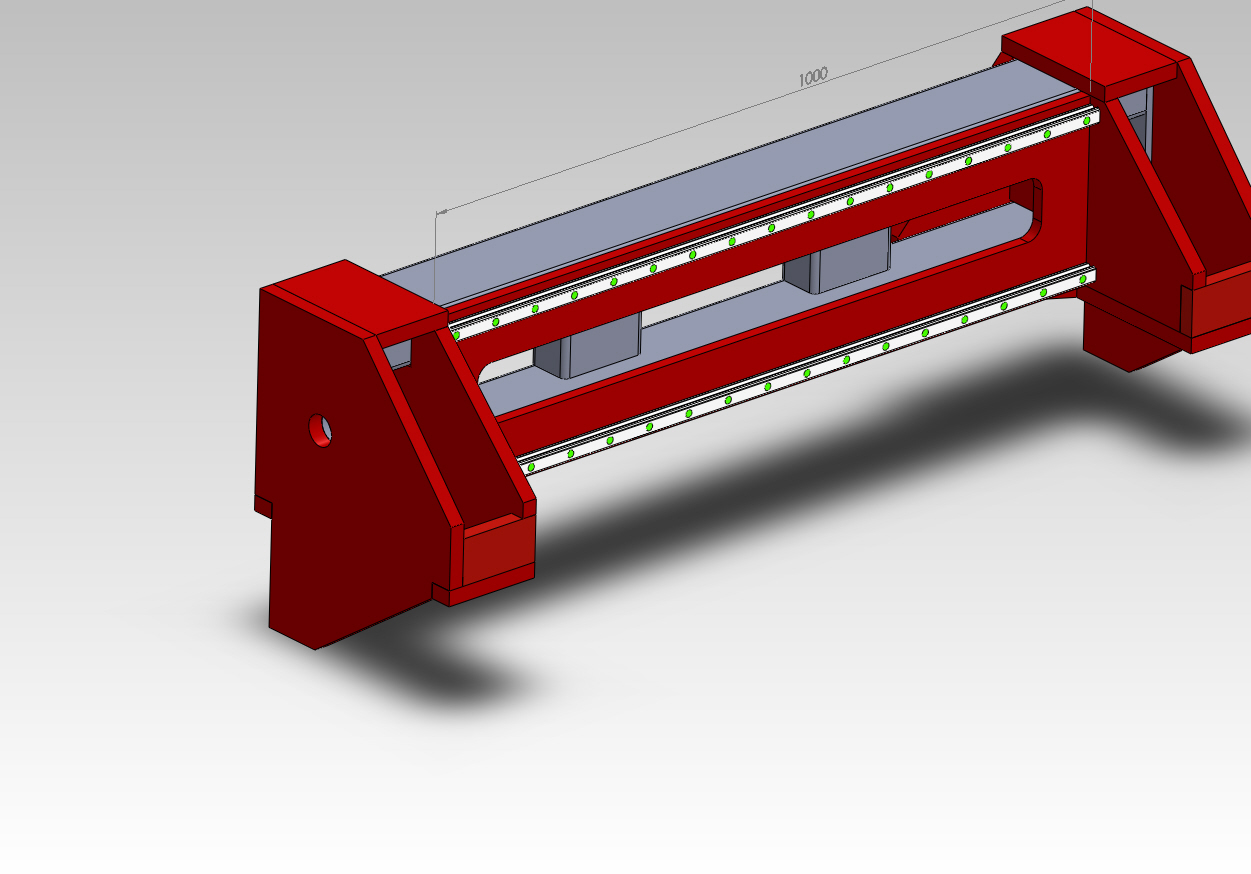

  7. #67
    Dean the steel supports are from 120X60 steel tube so they leave 60mm space for the ballnut. I dont know if this is enough but even if it isnot i could make the steel supports from 40X80 tube so 80mm would be the space for the ballnut. Regards how steel fastens i explain. The 120X60 beams will be fist welded like that
    Then the red assembly (made from 20mm aluminium) will be bolted with the tubes like that
ID:	11538 Click image for larger version.
    I dont know if the following picture will help you
    Anyway i have sent you the model did you get it
    Thank for your time
  8. #68
    Gantry looking a bit similar to this; but stronger, maybe there's something here for ideas ?
    http://www.mycncuk.com/forums/gantry...html#post49880

  10. #70
    Syliavski thanks for your reply
    I am a little bit confused about what materials is should choose for my gantry. Firstly I was planning to make a steel gantry. 120X60 tubes for the gantry welded together lke this
    Then the sides would be 10mm steel laser cutted.
    I would even put the green aluminium plate at the front of the gantry, or i would epoxy level the tubes surface so that the rail would be on the same plane.
    After that came Dean who adviced me not to have a fully welded gantry so i would be able to adjust. In fact at the above plans i was planning to bolt the sides with the 120X60 beams. Also i was planning to epoxy level tha base plates of the gantry or use shims in order to adjust.

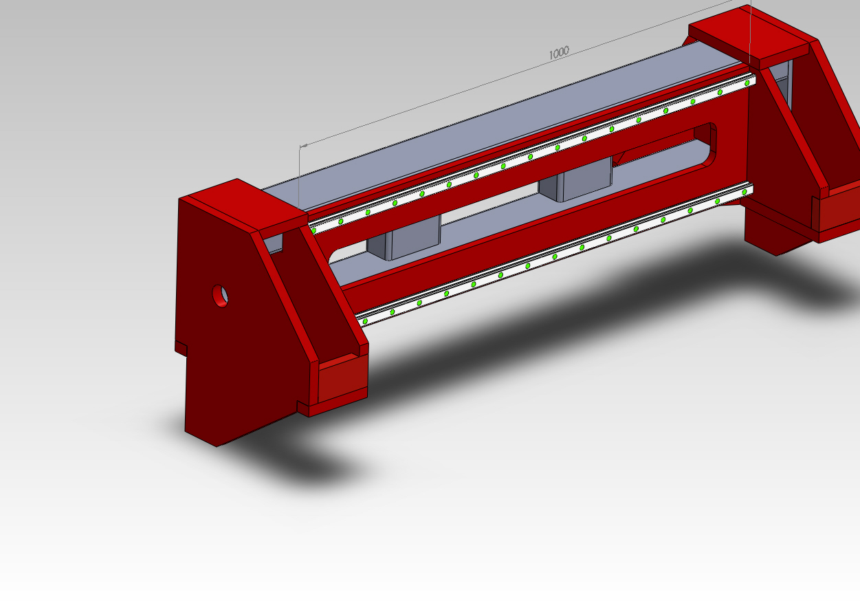

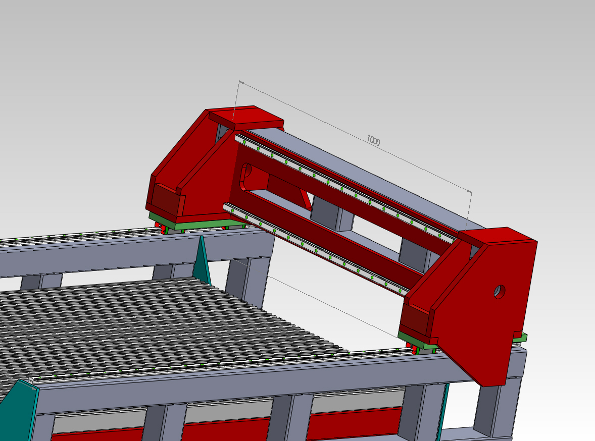

    After Deans comments i come up with these plan
ID:	11563Click image for larger version.
    with the grey color represent steel and the red color aluminium.
    I am really confused about what is better or not. I am starting to make a plan and as i have no experience about the difficulties that i will come up with, i dont know if i am right or if am wrong
    So far thanks everybody for your help.
    Vagelis
