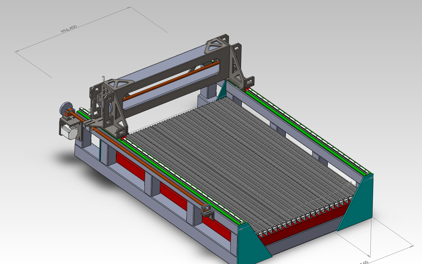

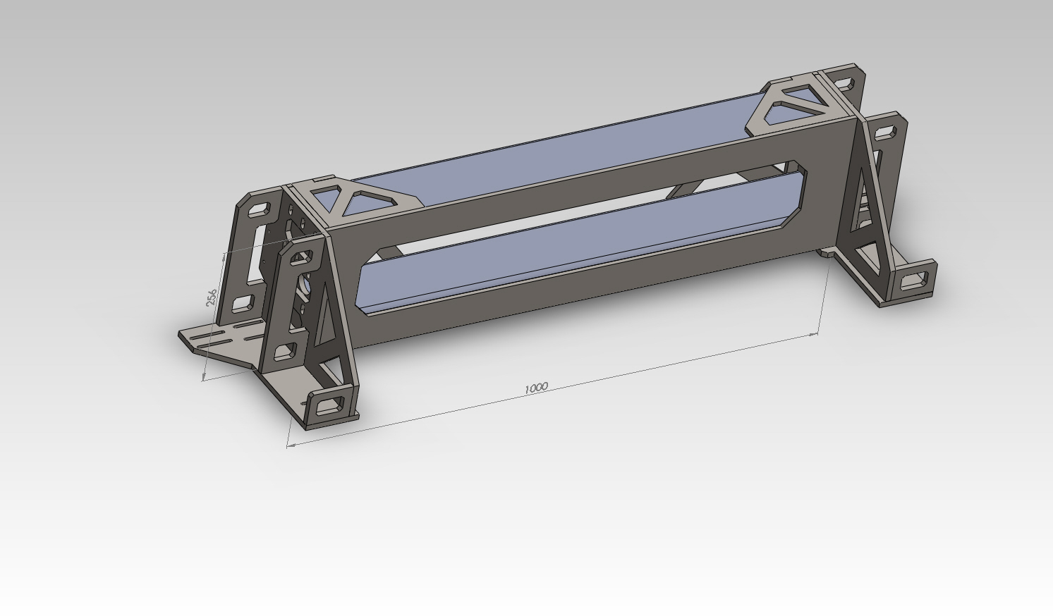

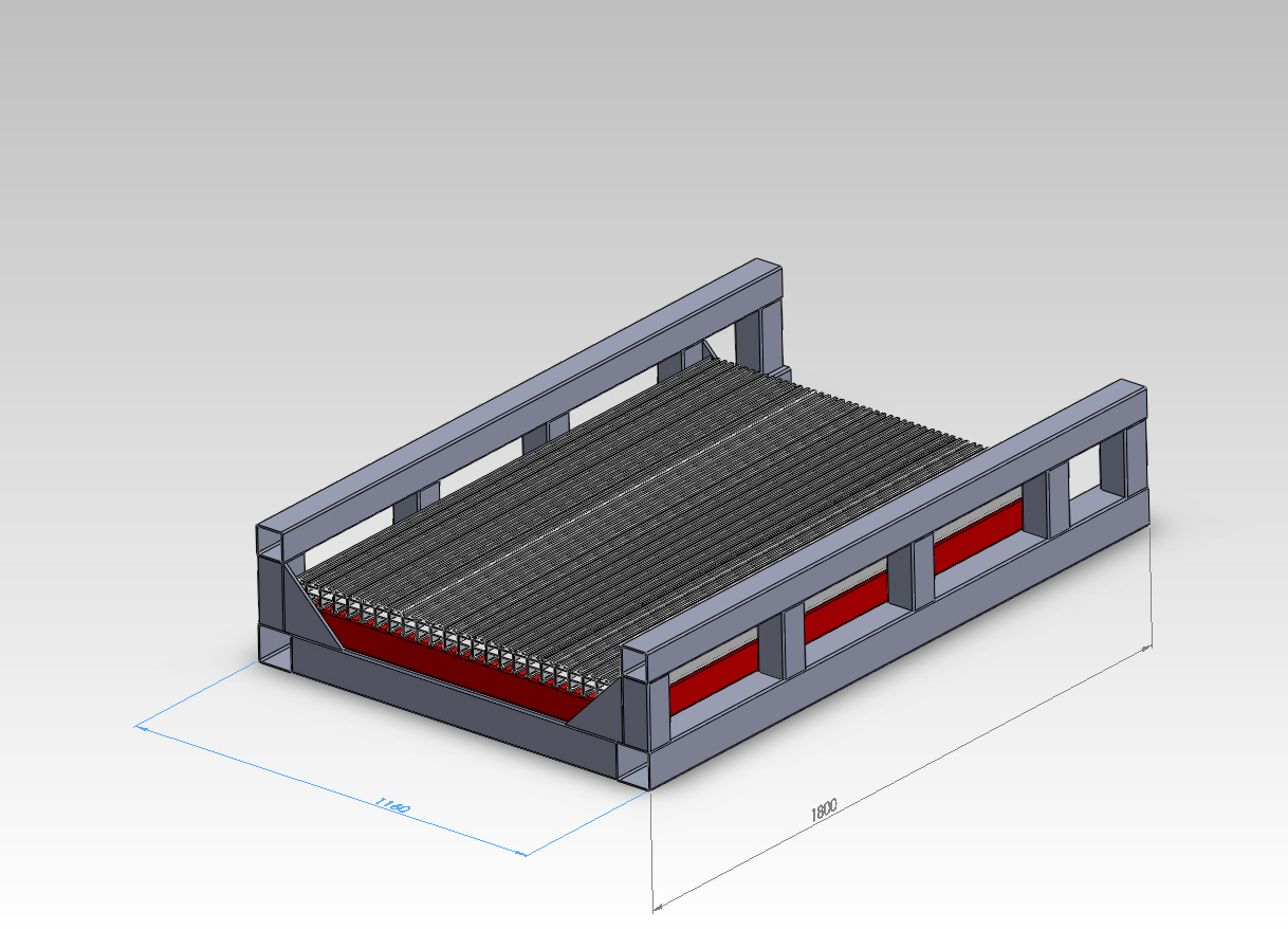

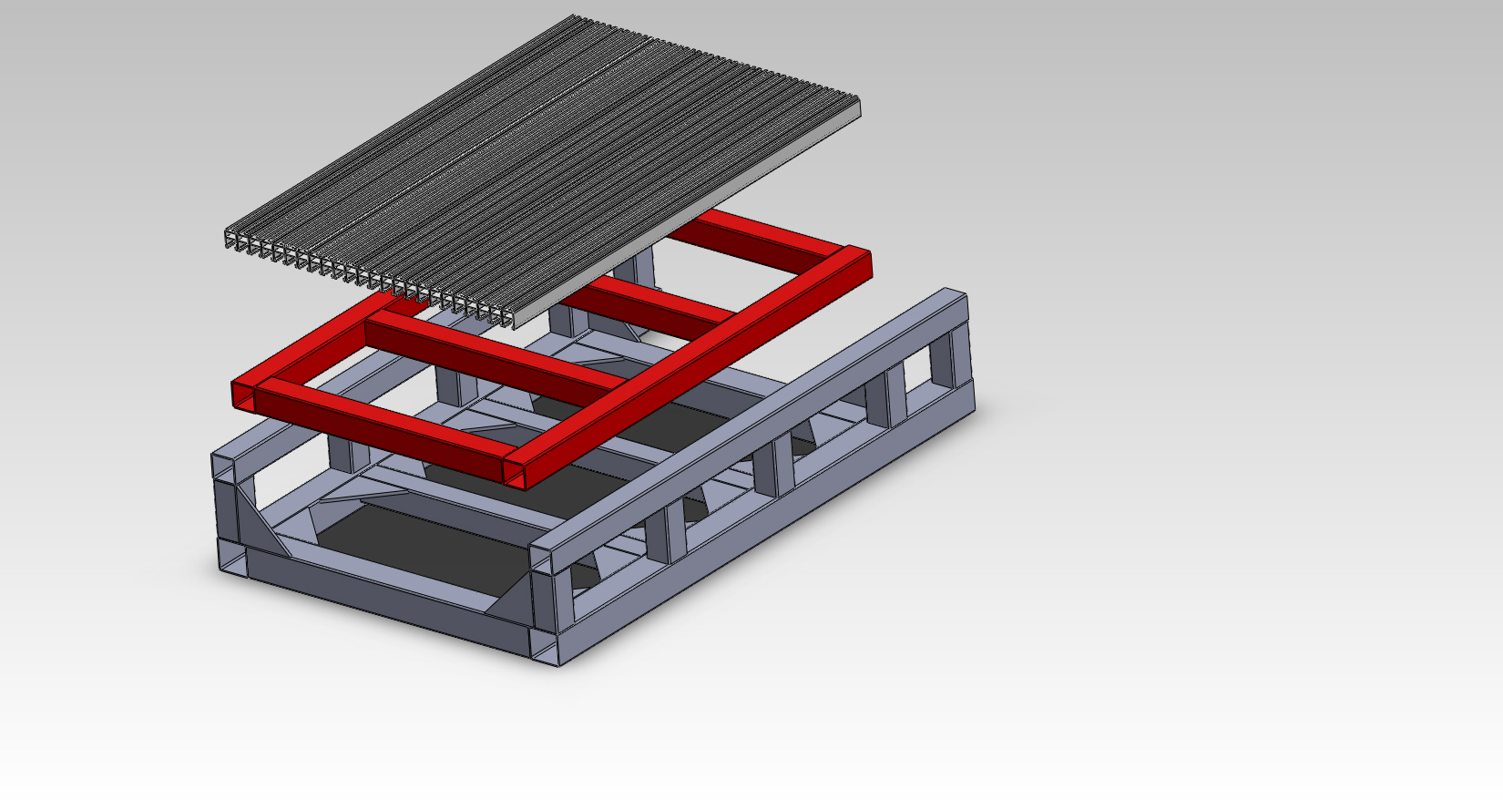

    Hello everybody. I came back to show my little progress.
    I want to remind everyone that we are talking about a cnc router with
    X 1800mm
    Y 1000mm
    Z:300mm
    It will be moved with 4 ( 2 x axis, 1 Y axis, 1 Z axis ) 400 watt yaskawa servo sigma II.
    Steel is the basic material for the construction ( except z axis that I didn’t design yet )
    As the table has been discussed many times, I have nothing to say. I just upload two photos . Basic beam is 80X80X4 mm.

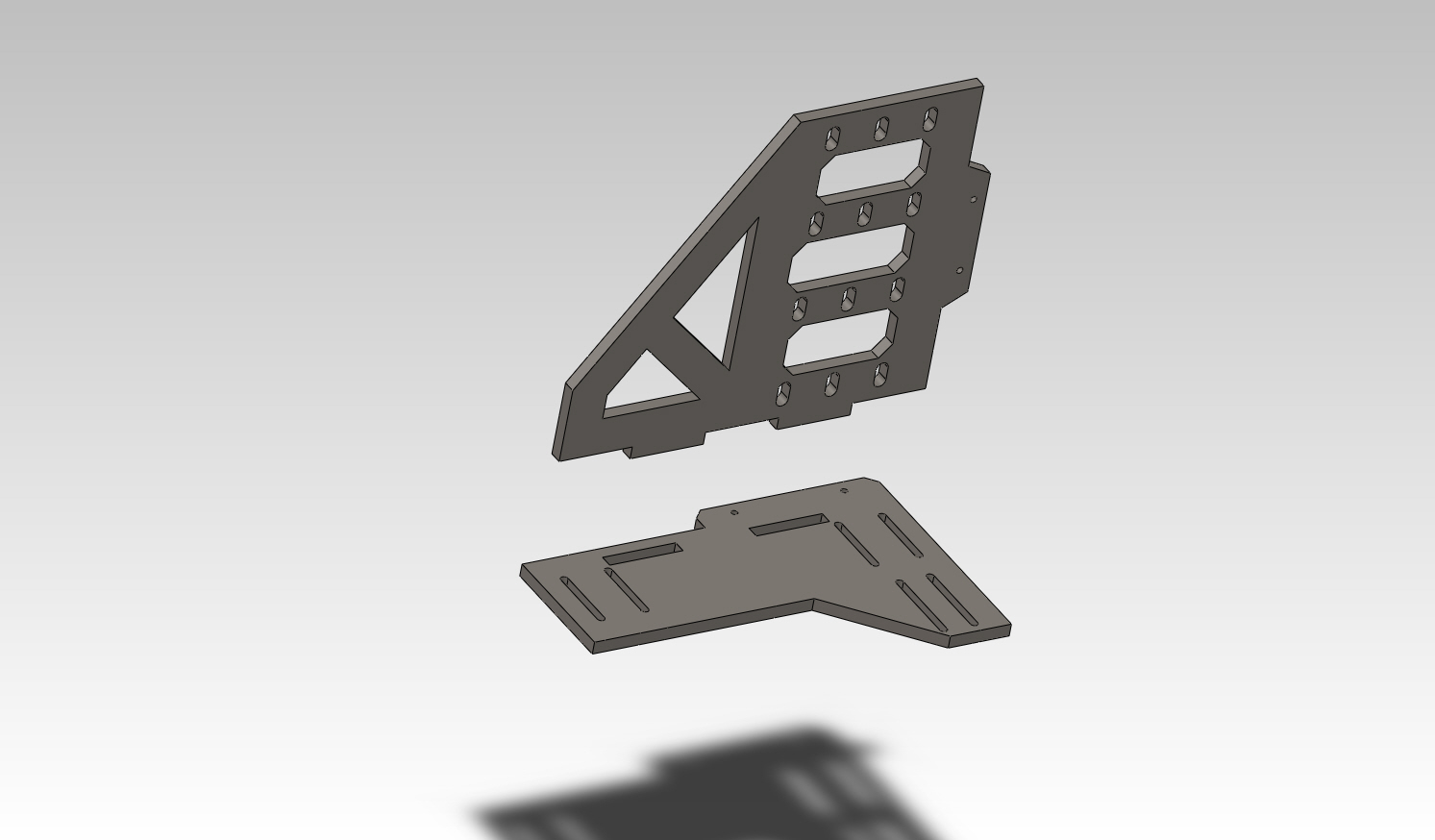

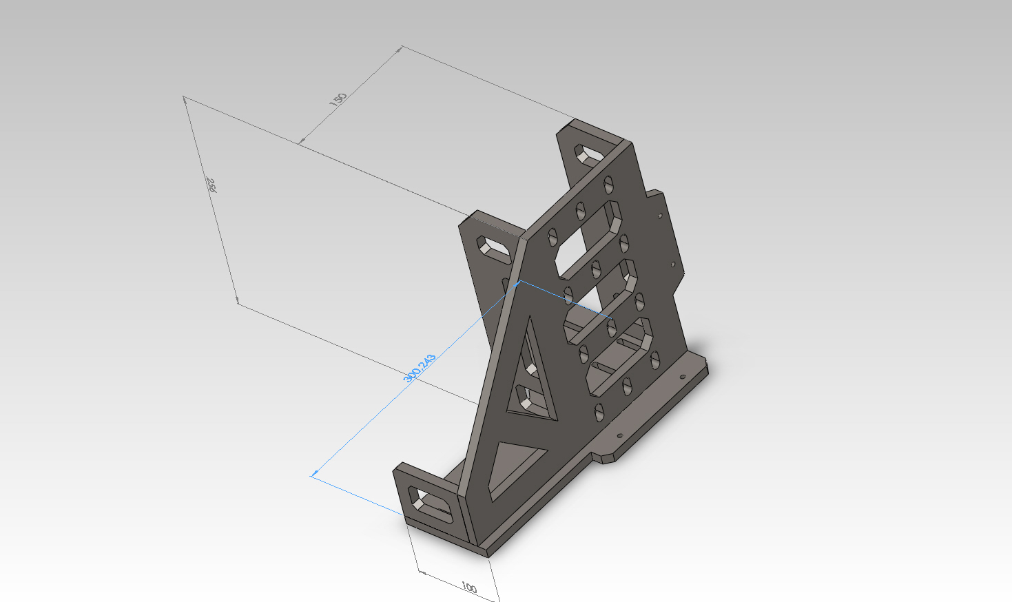

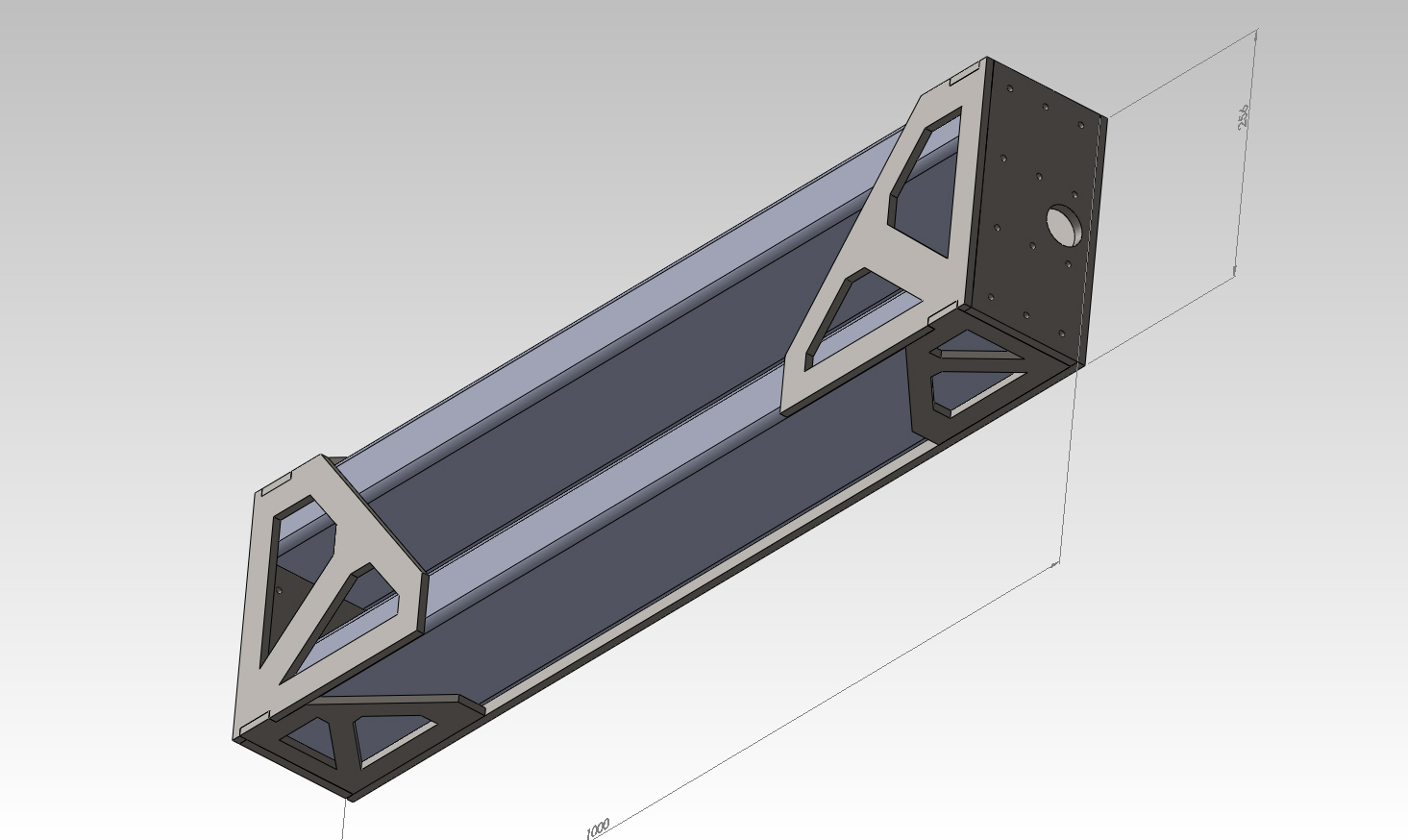

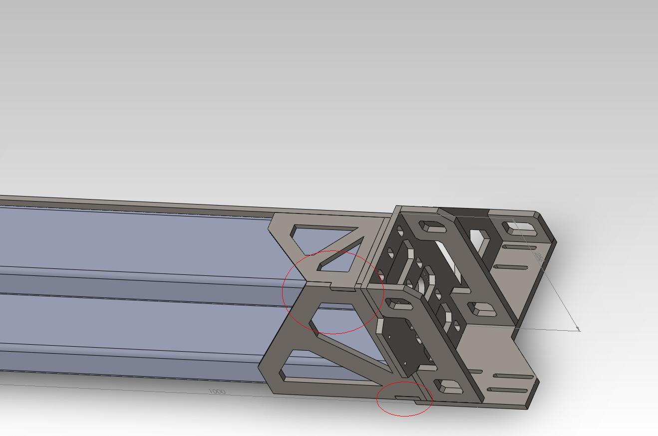

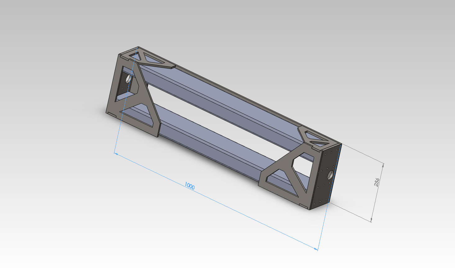

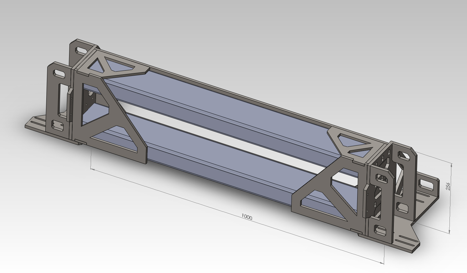

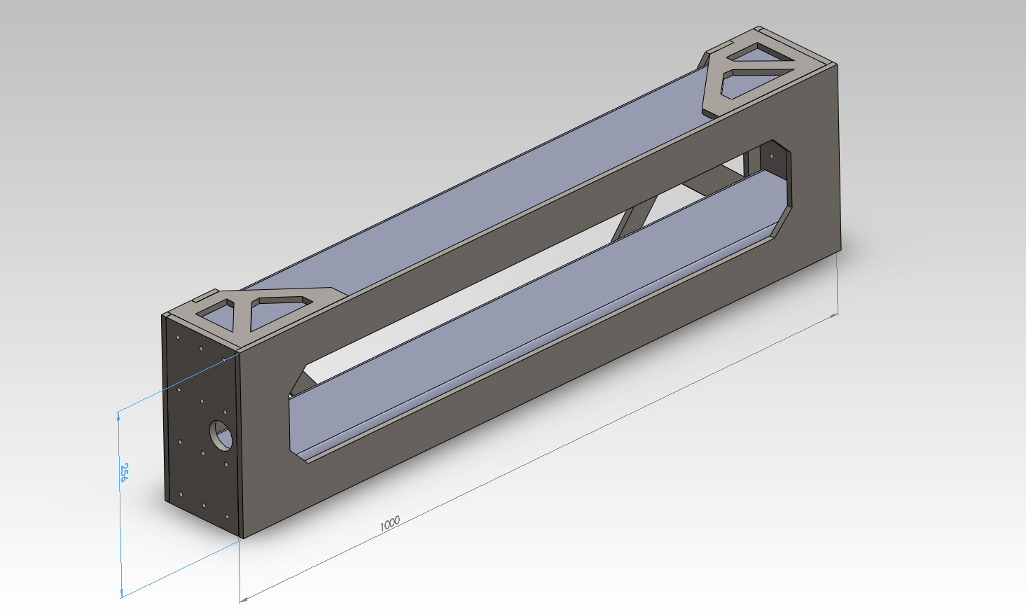

    The gantry will be maid from two 120X60 X ( 3mm or 4mm thick steel ). At the end of the gantry frame, 8mm and 10mm steel plates will be welded in order to reinforce the gantry attachment to the side braces that will be bolted on the carriages.
ID:	11948 Click image for larger version.
ID:	11949Click image for larger version.
ID:	11959Click image for larger version.
Name:	gantry sides back.JPG
    If it will be needed ( I try to avoid it ) the front face and the side (left-right ) faces will be perfectly milled to be vertical each other.
    Here I want your opinion about the way I laser cut the steel plate and the way I try to keep everything square in order to avoid (if possible) machining cost. If you notice the plates has been cut in such a way ( like a puzzle ) that it is difficult to distort when I will weld them ( I am planning to tig weld the parts in order to reduce heat distortion). Do you think this trick ( “ puzzle cut “ ) will work ?

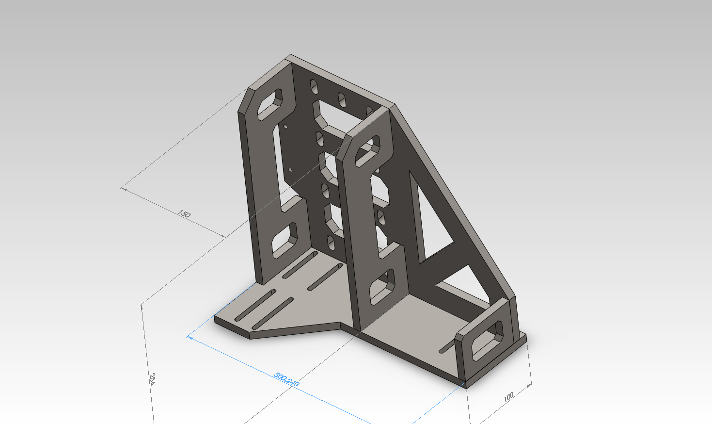

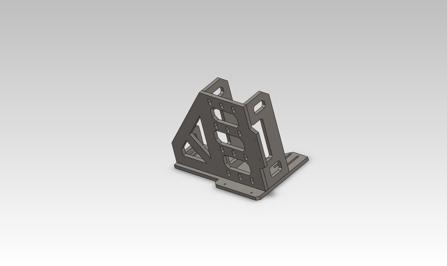

    The same way I made the side braces here are some photos.
Name:	side brace build 1.JPG
ID:	11951Click image for larger version.
Name:	side brace build 2.JPG

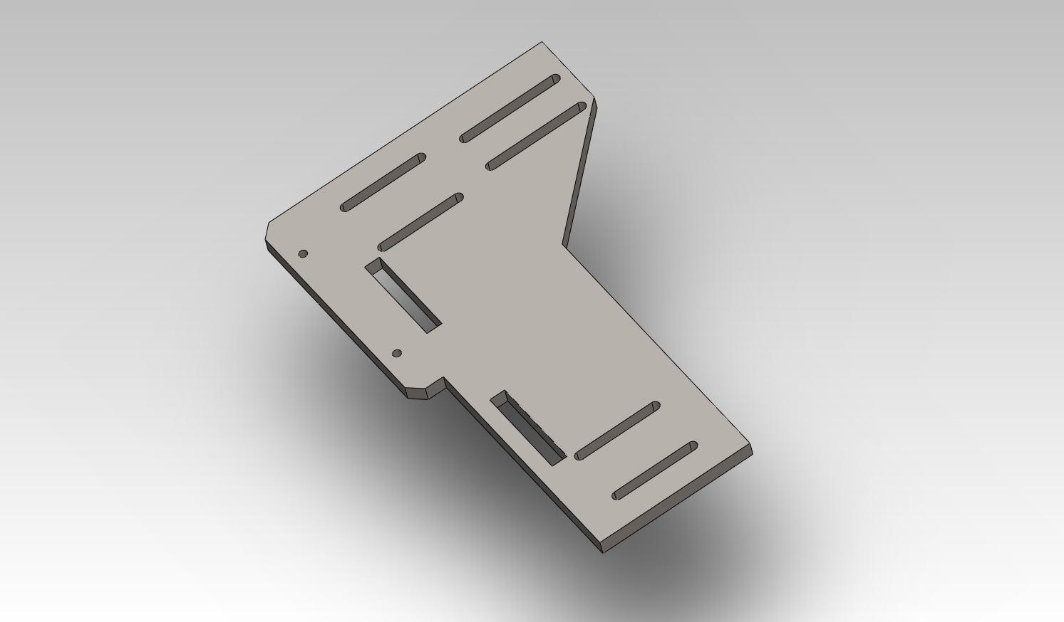

    If you notice the side braces have straight slots in order to fine tune the gantry so I will be parallel to the cutting surface.
Name:	side inner.JPG

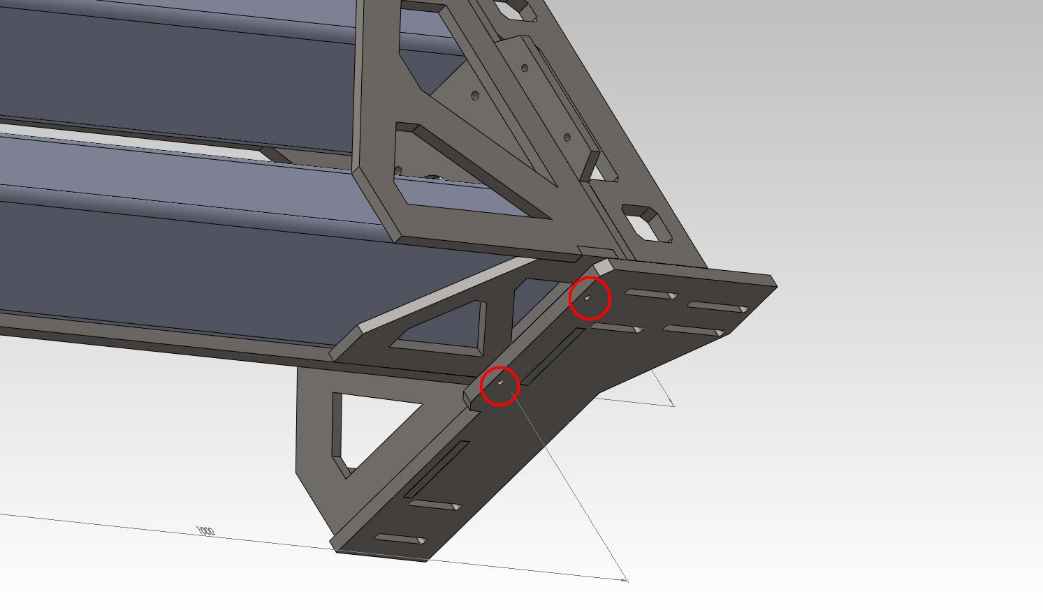

    At the following photo you can see two holes where I will bolt screws that will help me to adjust gantry height.
Name:	gantry sides tune holes.JPG
    Also the straight slots ( on the vertical piece of the side braces ) will allow small ( up-down ) movements. Side braces and gantry frame will be bolted together.
Name:	gantry sides front.JPG

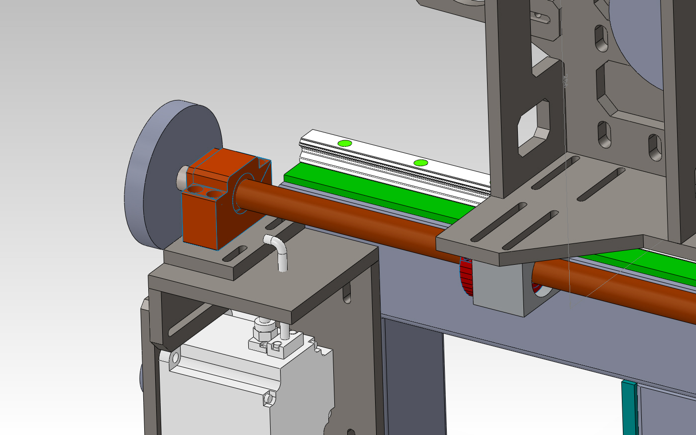

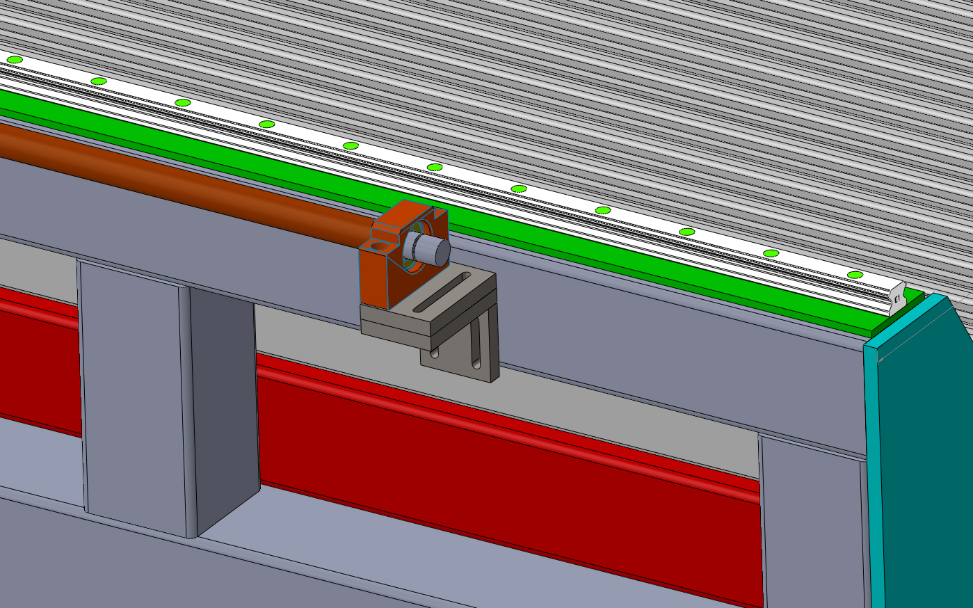

    As for the ball screw mounts, they are also adjustable.
Name:	bk mount.JPG
ID:	11957Click image for larger version.
Name:	bf ballscrew mount.JPG
    I want your comments if you wish , an I remind you my basic questions
Name:	total isometric .JPG
    1. Is the gantry overbuild?
    2. Is 10mm steel ( for gantry side braces, front face, and side reinforcing )too much for such a construction or should I go with 8mm 7mm or 6mm. I am asking because if we follow the 1:3 relation between steel and aluminum, 10mm steel equals to 30mm aluminum )
    3. Will the puzzle cut technique work?
    As for the weight the gantry without the motor that will move y axis and without the ballscrew and of course Z axis, weights nearly 41 kgr ( with 10mm thick steel for the side braces and 8mm steel for the reinforce angles and 4mm 120X60 rectangular beam). If I reduce steel thickness and remove steel from some no critical spots, it is obvious that 41 will be easily reduced to 35 or less.
    Thanks for your time
    Vagelis
    Ps: I will use 1:2 gearing but at the above plans i use 100mm 60 tooth diameter for the ballscrew pulley ( that will give me 1:3 gearing, having in mind that the motor pulley is nearly 3,6mm 20 tooth) in order not to have dimension issues if in the future i want to go with 1:3 gearing.
  9. #79
    Forget all the cutouts on the gantry which have been included to reduce its mass. The servos you have a plenty powerful enough to move achieve the required dynamic performance for a gantry several times heavier than what you have designed. If you continue with your plan to use 100mm diameter pulleys then the inertia of just one of those pulleys will be more than the equivalent inertia of all three axes! Decide on the rapid feedrate you want, work out what drive ratio is required, select pulleys, then check that the servo motors are capable of driving it with the required acceleration. It is very simple to calculate, so don't compromise the performance of the system by using very large pulleys when they're almost certainly not required. If you're not sure how to work it out then let me know and I'll show you.
    In answer to your direct questions:
    1. Depends what you want to do with it, but you seem to be in the right ball park.
    2. The consequences of using a lower thickness and having to replace it are far worse than the small increase in cost to use 10mm, so unless you're prepared to calculate it just stick with the thickest you're happy to pay for (presumably 10mm).
    3. It looks a bit risky to me - the tolerances on the parts would have to be very good for them to fit together properly.
