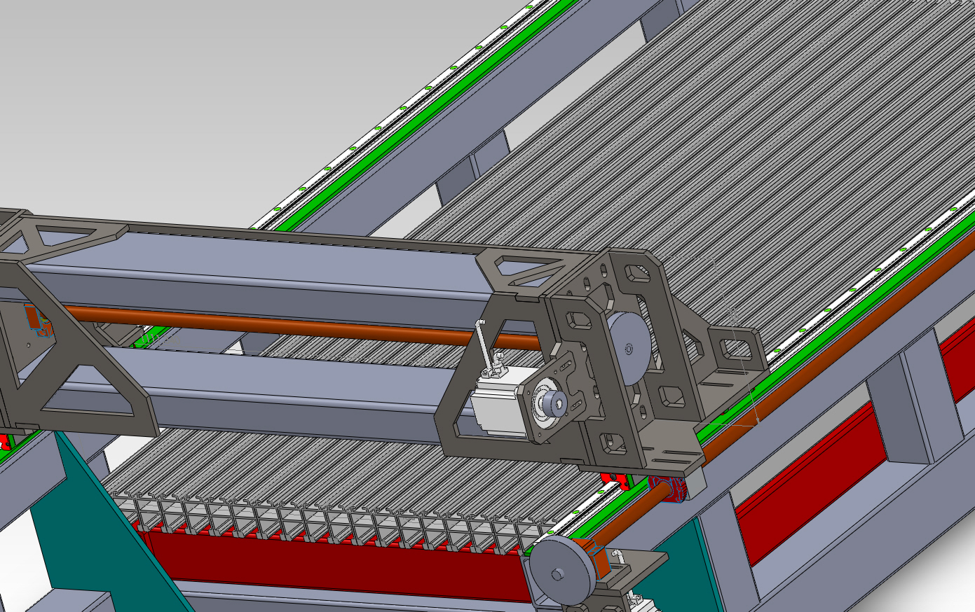

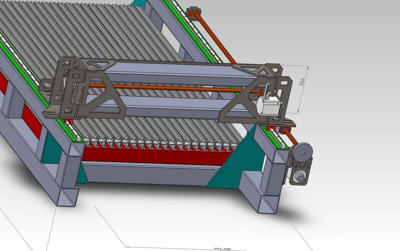

I second that. The plates will distort not matter what you do. Use 10mm simple solid plates. Dont be afraid for the weight. When everything aligned and smooth, the gantry will slide with astonishing to you ease.
How you came up with such big pulleys? Another thing to point you is to make sure the pulleys are from Aluminum, cause last time i ordered pulleys from belting online assuming they were aluminum they send me steel pulleys. So ask and make sure before buying.
