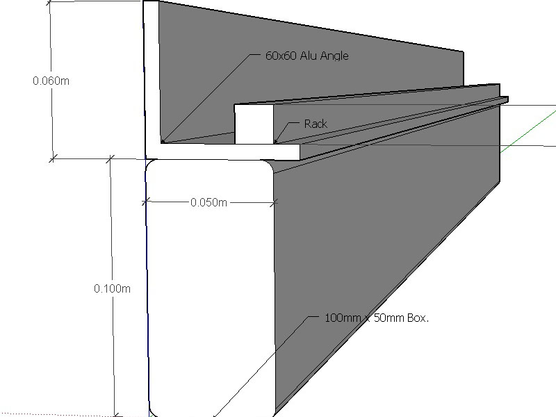

    Okay great. I intend to purchase my rack and pinion materials some time next week.
    Having these materials will help me picture what I need to make regarding brackets for sticking it all together.

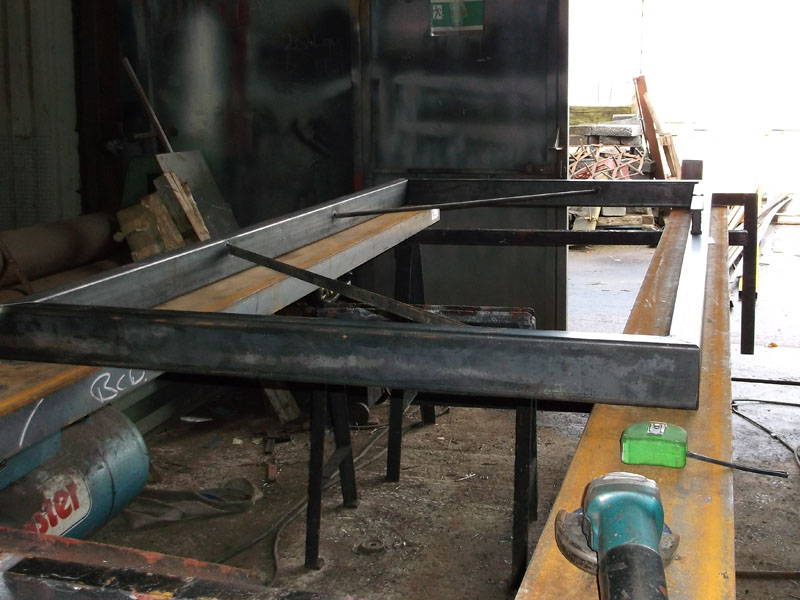

    Started building my table today, A pic of were Im up to.
    Its all braced up and tacked ready for welding.
    Decided to do the table 2200x1200 giving me plenty of room inside for 2m x 1m sheets and gantry parking.
    I used mod 1 rack on my machine, I was a bit unsure to start with thinking I might have been better with a size up, but it seems to be working a treat, I would use it again.
