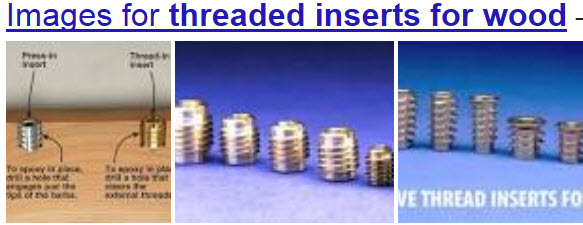

    Hi Eddy C
    T Nuts are OK but they tend to work loose and fall out after they have been used a bit unless you put another sheet behind them.
    These are better....
    https://www.google.com.au/?gfe_rd=cr...serts+for+wood
    You just drill a hole and screw them in with an Allan key (or see video below for another type). Very strong.
    http://www.youtube.com/watch?v=tIhEqoKE8Dc
    John

    Thanks John, I've used similar to those before, I see what you mean about the T Nuts with vibration about. Do you think he's correct when he says it's not a screwdriver slot ?
