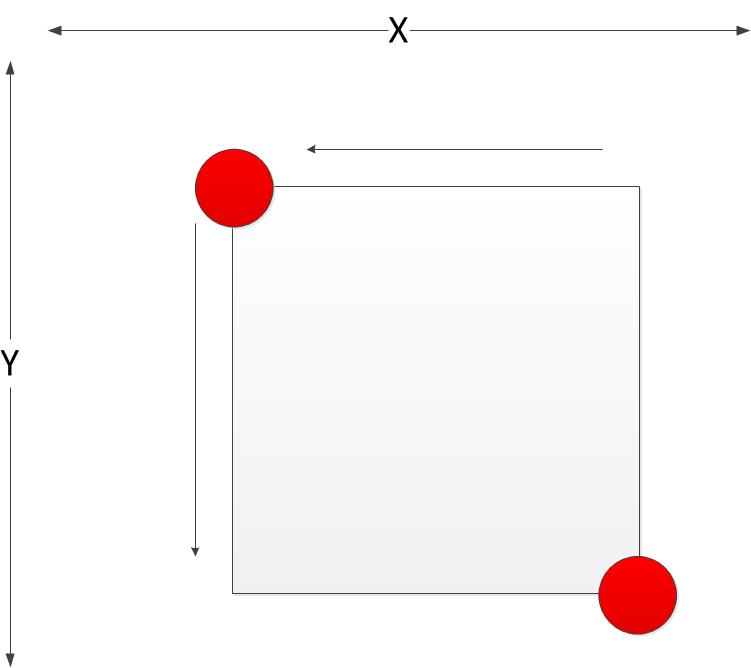

    Ok so my cnc is generally great (for my very very simple needs!) but it does have 1 major failing that i would like to improve. The gantry is made up from 2 20mm round bars spanning approx. 7-800mm and it supporting a 1.5kW chinese spindle and associated mounts. You can imagine what happens - tons of flex/ruined parts - most noticeable when trying to cut sharp 90 deg turns from y to x, ends up with a lovely big curve if I go to fast!
    Here is a rough diagram.

    I also had a situation cutting a long thin pocket running down the x axis - all was going fine until suddenly the spindle seemed to flex down as if was trying to dig into the wood! I guess this was the flexing issue allowing this to happen...
    So my question is how could I possibly improve my situation with minimum cost/rework?

    Also, back to my original issue, does it look like it comes from the flexing on the y axis?
    Here is a pic...
    If I feed too fast the red points end up being curved rather than a sharp right angle?
