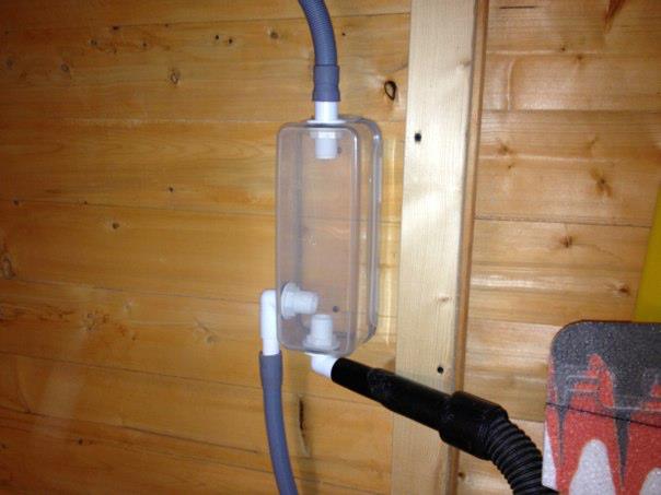

I understand the need for a vacuum chamber to give a good suction at the start of clamping while there is not a good seal at first. However what about dust and stuff getting sucked down? If I'm using a pump I presume I need a good filter too. How would this be done? Is it enough to place some open-cell foam over the reservoir inlet or might this just get sucked into the chamber anyway? Maybe fill the chamber itself with wire-wool?

Depending on the funds you wish to spend there are more then a few options for a vacuum table. One item most folks miss IF not using a vacuum cleaner to generate the vacuum (yes it can be done but requires adapters and still gives a lot of noise) is to not only seal the board if using a wooden structure, but to also put a dust/SWARF trap in between the the vacuum unit and the table. How you place it is up to you. Also IF you set up zones you can decrease the area being used by building a manifold for the table. IF building your own vacuum pump please remember that you REALLY want to have a reserve tank set up and a manifold switch. Otherwise you will burn the motor out way to fast and you will not get a good solid grab as the vacuum is applied via the manifold point.
