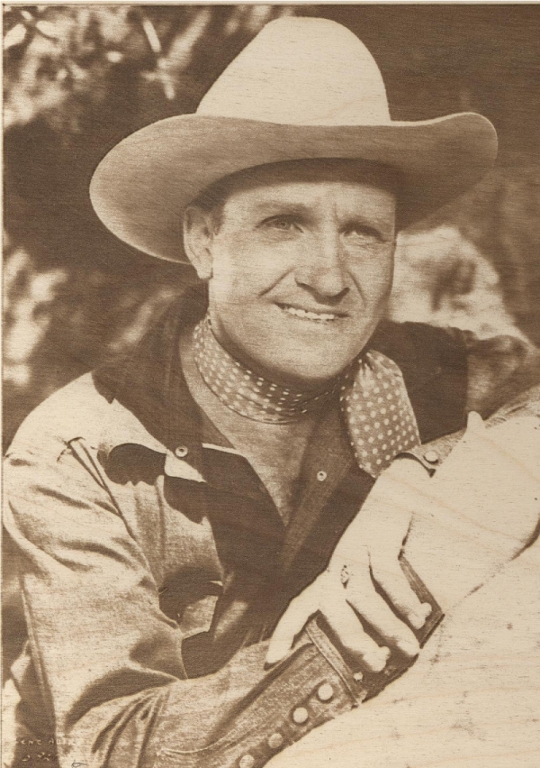

    Laser diode (445) engraved on Baltic Birch Plywood using gcode generated by PicEngrave Pro 4.
    Engraved at a 45°angle with .006 inch raster line spacing. Original engraving size 6 x 8 inches.

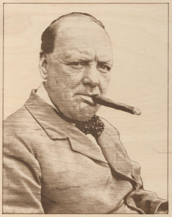

    I engraved this one today. Same settings as above.
    John Champlain
    For those who may have interest, the link below is to a short video of laser diode engraving. Gcode generated by PicEngrave Pro 4+Laser (PicEngrave CNC Image Engraving Software)

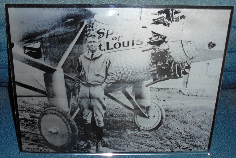

    John invited me here to join this forum and his discussion about laser diode engraving. I own a CNC machine shop in Florida and me and my son developed this analog modulation laser diode engraving process using standard g-codes in Mach3 a year and a half ago. We started out using PhotoVcarve as our image to g-code program, but determined that it had it's limitations for laser diode engraving.
    Thanks to John's hard work and considerable Beta testing between us both, he has updated his Picengrave Pro image to g-code program to become a very unique, one of kind software that enhances this LD engraving process considerably. It has options for 4th axis rotary, TTL, variable feedrate, and spindle type of engravings like Lithophanes all in one program also.
    Thanks John for being so patient with me and implementing all the program change requests I threw at you!!
    Here is one of my favorite mirror engravings done with his excellent program using analog modulation. It is possible to get shades on mirrors using a laser diode and PEP 4 where a dithered 1bit image using a pulsed CO2 laser can't.
    Jeff
