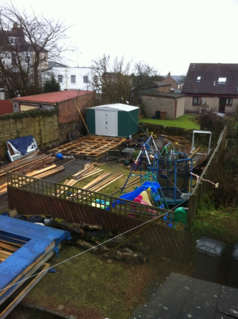

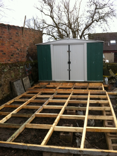

    eventually got the wood for my work shop.
Name:	IMG_0904 (478x640) (478x640).jpg

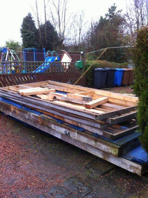

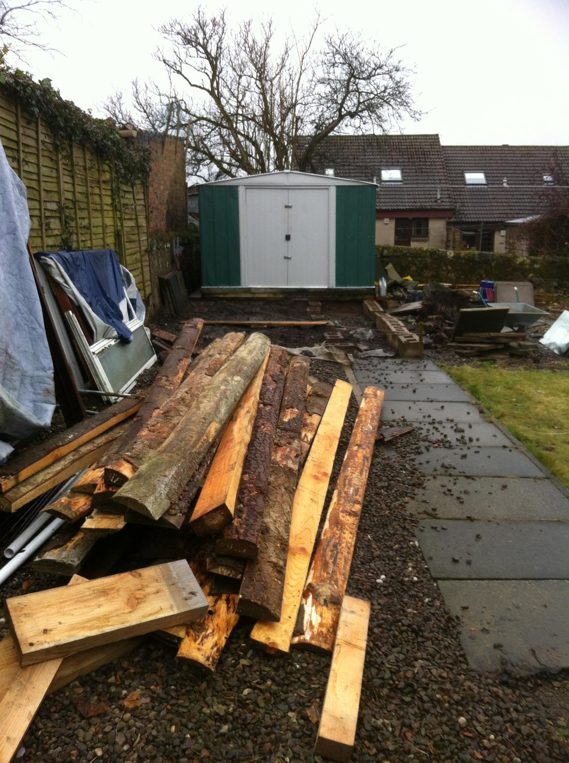

    this the cladding i,m using (tree slabs
    This where its going, attaching to my metal shed.

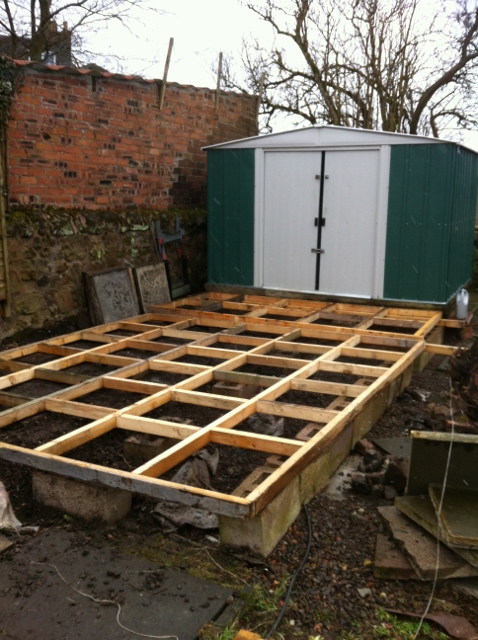

    The floor is down.
Name:	IMG_0911 (478x640).jpg

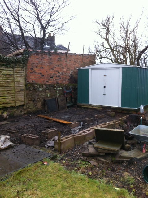

    If the snow stays off, then i might just have this completed next weekend, then i can progress with my build.
    First off are the concrete blocks sitting on the ground or do you have concrete under them? Also what is the base sitting on near the wall is it slabs? The centres of the joists look quite far apart but that might be the photo. What are the centres? Also you will need to put some DPM between the base frame and whatever your are sitting it onto so that it doesnt suck up moisture.

    I agree with the above pluss I think ;you are asking for trouble with settlement which would be a shame if you did all the work and the floor sunk. Its vital to get a decent foundation as you will be putting some heay stuff in there. the suports for the floor would be better under the long pieces fron to back and not under the bits that are just nailed to them. hope this helps. good luck with the build.
    These were taken a few days ago, and weren't finished at that time. The blocks are sitting on a bed of concrete, the gaps are 610mm. The bearers that the frame will sit on will have damp proof on them. The floor will be 18mm ply, but will be looking at possibly cutting a section out where the machine will be sitting, and pouring a concrete bed, so that its solid. The photos are just to show a start has been made, but thank you for your comments, I'm always willing to listen and learn.
