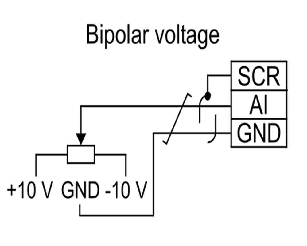

    I want to control servo speed-torque & vfd from mach3/linuxcnc with analog voltage -10v to 10v.
    My servo accepts digital step/dir - cw/ccw - quadrature for position control and analog -10v to 10v for speed/torque control.
    So iam searching a circuit to do this thing..
    Knows anyone something about that ?

    using -10v to 10v is normally carried out with a joystick control and a VFD, -10v is the reverse direction whereas +10v is forward direction.
    To generate the -10v to 10v you could use a simple potential divider across a 20v supply with the centre tap connected to zero or you
    could search for a better circuit on Google for example using the search term "Dual rail power supply"
    There's some info here that might help.

    Mach outputs a PWM signal to control spindle speed, so that's 0-5V (assuming 5V parallel port). You therefore need a circuit to convert 0-5V to -10 to 10v. You can use op-amps to subtract 2.5V from the signal (so it's -2.5 to 2.5v), and apply gain of 4 to get the correct range. Use an RC filter to get an analogue voltage level from the PWM signal.
    Something like this circuit:
    Non-Inverting Op-Amp Level Shifter
    The op-amp would need a +-10V supply... one easy way, though probably not the cheapest way to get that is with one of these DC-DC converters.
    Or you could get a breakout board which does it for you.
    If you're using LinuxCNC then you could control the spindle speed using any of the position control (step/dir, cw/ccw etc) inputs, which is probably easier as it saves making the above circuit.
  4. Think we need clarification of OPs needs. He doesn't mention spindle in OP only control of speed of a servo. Everybody's made the assumption of spindle speed control by virtue of mention of VFD but VFD is not a servo thing. If using step/direction controls then speed is related to step rate, so its not clear what analogue voltage is doing.
    Creating -10 -> +10v from step (PWM) and direction (polarity) isn't hard but you need some skills in design, electronics assembly and testing. Jonathan has given part of a solution but its of little use without the skill/knowledge to do the rest.
    I may be wrong but I know of no BOB that does -10v out... the speed output is invariably 0 -> +10v and direction goes to fwd/rev input on VFD.
    @vre: please be more specific in your requirements; are you referring to motion control or to spindle speed/direction control?

  9. OK definitely some confusion here...
    Servo controller is nothing to do with VFD. VFD is standard 0 - 10v speed and FWD/REV run/stop inputs and can be driven from normal spindle control board or BOB with 0 - 10v speed control output.
    Servo controller can be programmed to operate in different modes - parameter Pn002. One of these modes is step/direction for positional control (like a stepper) using wiring diagram 2.3.1. Another mode is analogue speed or torque control using wiring diagram 2.3.2. These modes are mutually exclusive, you can use one or the other but not both.
