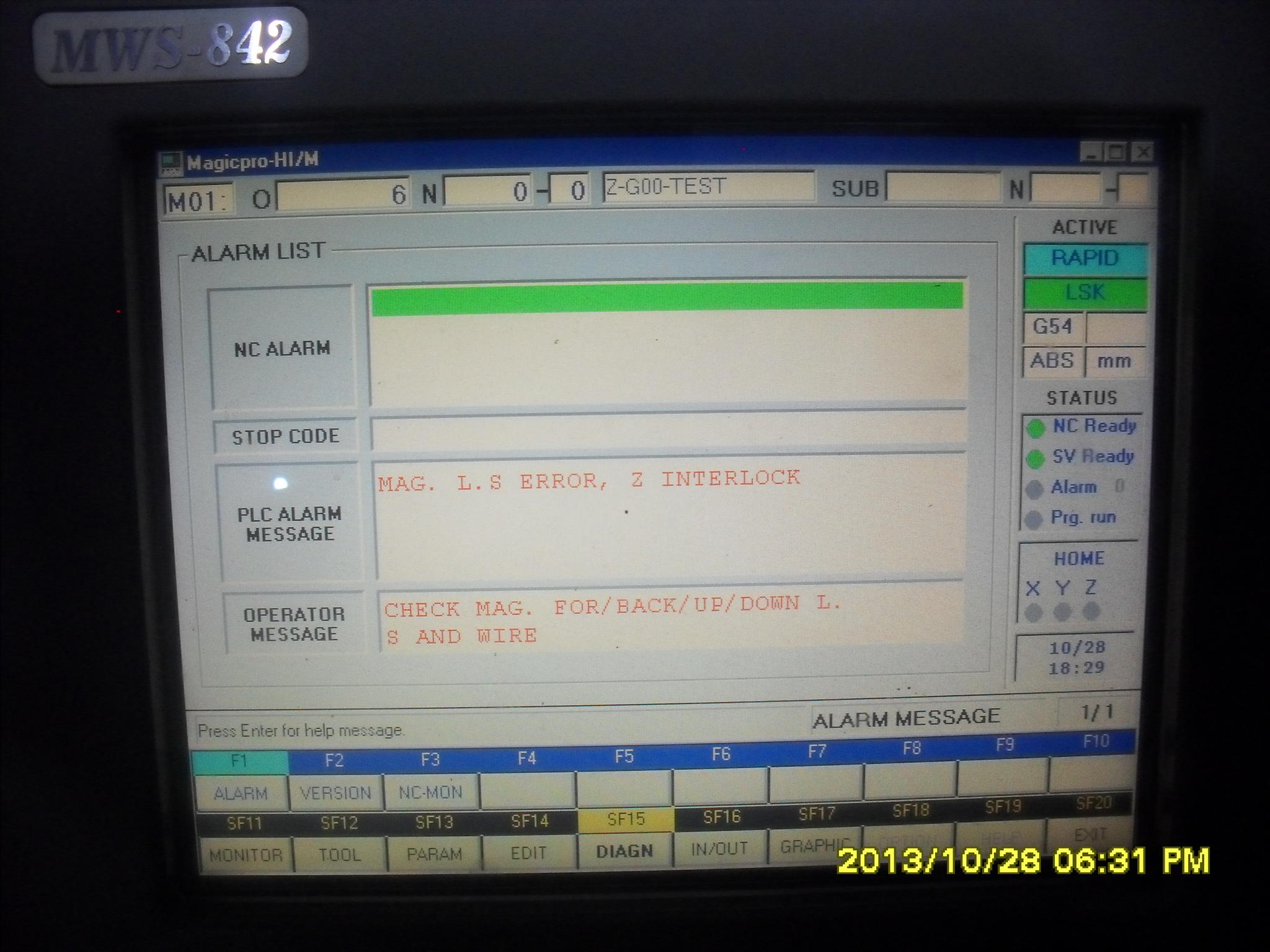

    hi
    we have magic 1500 cnc and pc controler meldas magic 64 pc base
    after error windows NT to boot I had reinstall window and install magic64
    after run program magic pro in dialog display error
ID:	10521Click image for larger version.
    please help me
    It looks like an error with a limit switch on the Z axis. You should check the switches are working and the wiring connections are good. If there is no fault found it may be the settings in the software for those limit switches.

    thanks for answer
    can you help how to fix problem by software ?
