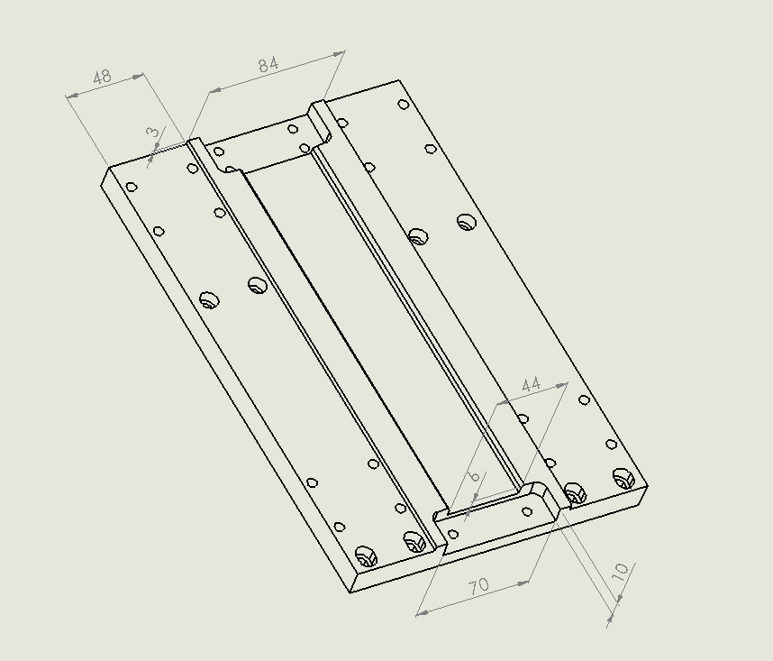

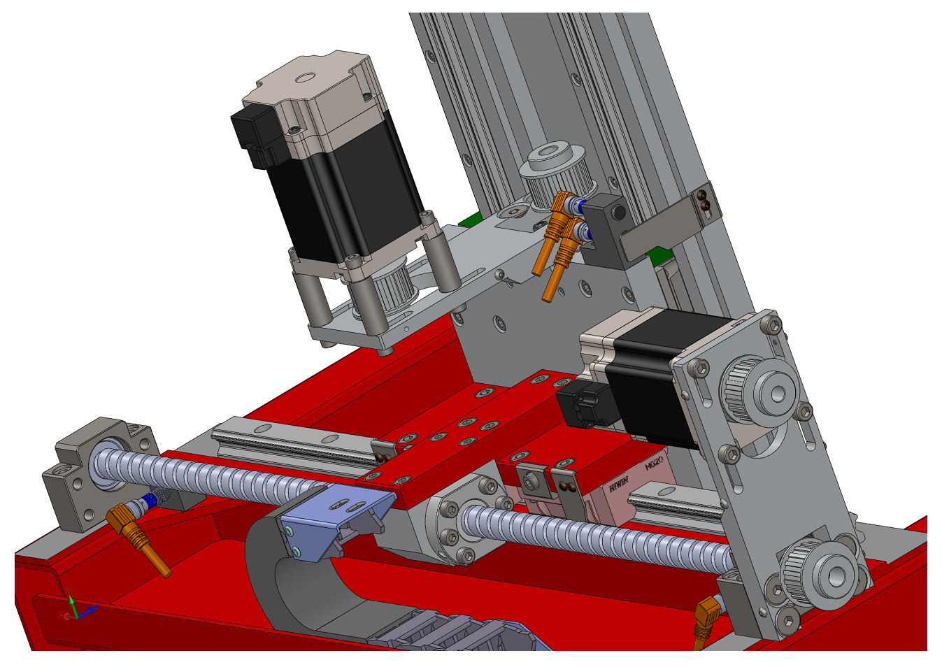

I'm planning now to design and build a CNC router/milling machine able to machine light material but also aluminium. I already start from an existing welded frame (50x50x3 tubes) which needs some reinforcement; but however this gives me the overall size of the future machine: 1100mm x 650mm.
My first investigations are giving the following axis travels: X 750mm Y 350mm Z 150-200mm
The distance under the spindle attachment and the table will be adjustable to accomodage eventually the use of a milling wise or the use of a horizontal axis divider
Here are some pictures of the project :
ID:	10559Click image for larger version.
ID:	10560Click image for larger version.
Screw ball types are 1605 for Y and 2005 for X (maybe 1605 sufficient ?)
Next question is the use of simple or double separated screwball nuts or dual screwball nut (combined type). what should you recommend as I want to be able to machine large holes with H7 accuracy...
The main beam of the steel gantry will be filled with concreat and same for X axis support beams.
The steel tubes sections are 50x50x3, 50x50x4 and 100x50x3
Currently the axes guides are round types (diam 20 and diam 16 respectively for X and Y axis)
The Z axis will be fixed on the Y box (made of 20mm machined aluminium)
Thank in advance you for all your future comments.
