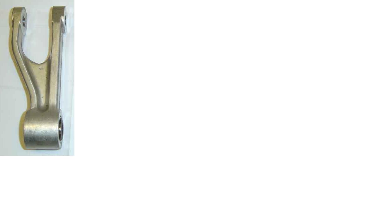

    I don't have the dimensions right now, but will do shortly.
    This is the original part. It is non adjustable.

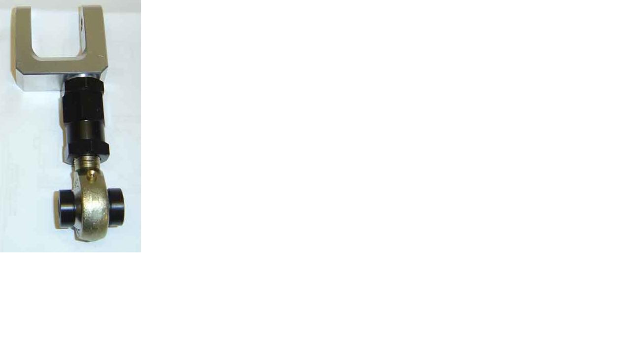

    This is an aftermarket part to replace the one above. But it needs to have the bolts dropped from the part to be able for the length to be adjusted.

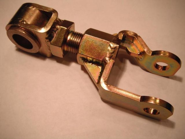

    The new one needs to be able to have the "adjustable length" via the thread and nut, adjusted while the part is mounted, meaning the ends will not be turning. This one below is another aftermarket design which works as it should, but are no longer made.Click image for larger version.
    This part is for myself, but If someone here is interested I can order multiples to market.

    Hi Dudz
    shouldn't be too difficult, but if you could give an idea of the thread size of the Rose Joint, a matching left hand tap would have to be procured, it's just a turnbuckle, some idea of the loading would be usefull,can't do this myself but others will wan't this information.Regards
    Mike

    loading weight would be around 200kgs. The thread size and dimensions I will list as soon as I can.
