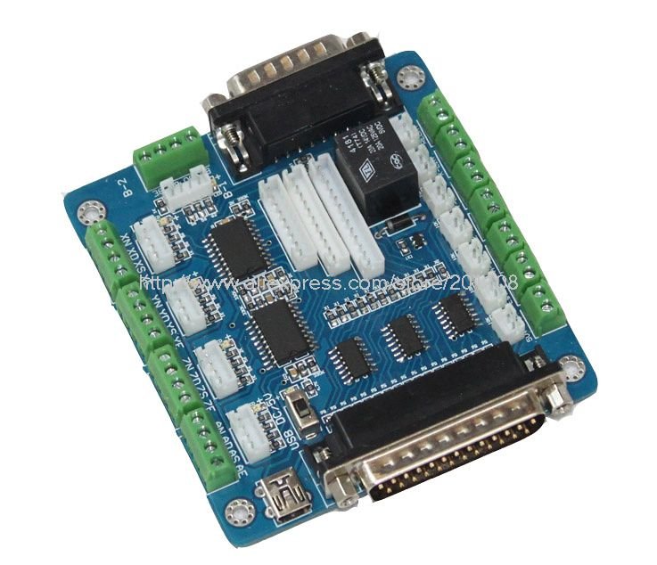

    I have 3 m542 steppers, 33v power supply and the following three steppers for my x,y,z axis; Vexta steppesr:
    X= PK 296-02AA (2 Phase 1.8° step, DC, 3A)
    Y: PK268-03A (2 Phase 1.8° step, DC, 3A)
    Z: PK268-03A (2 Phase 1.8° step, DC, 3A)
    and a 5 axis breakout board like this one Click image for larger version.

    What setting on the DIP switches should I be setting Click image for larger version.
