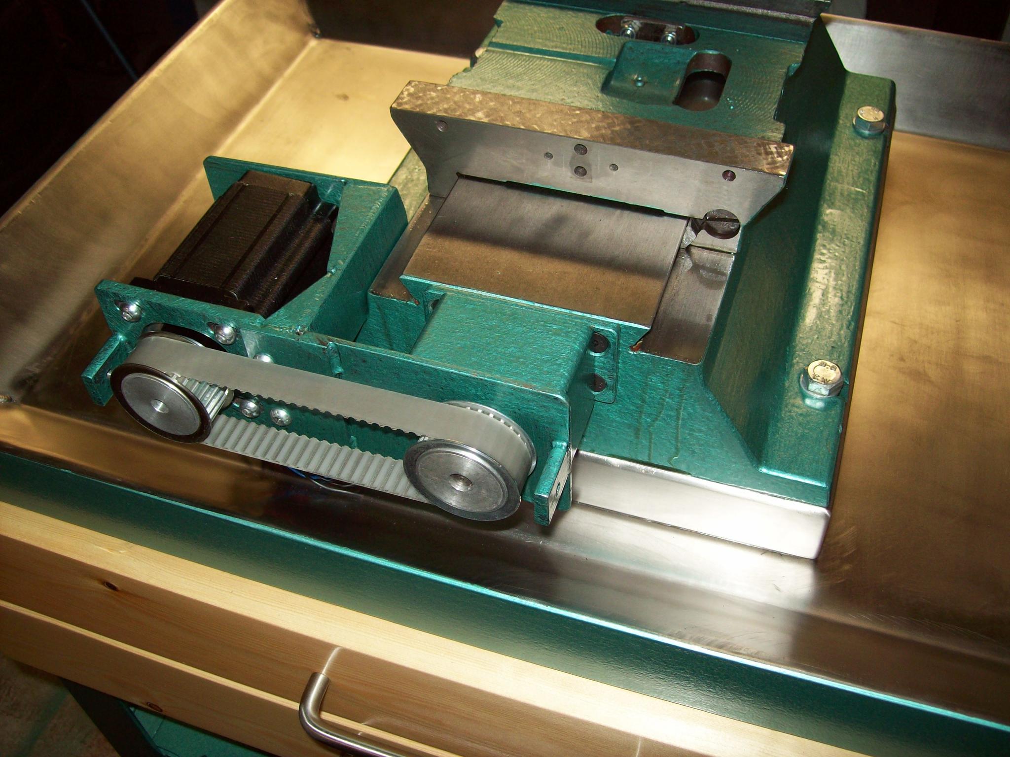

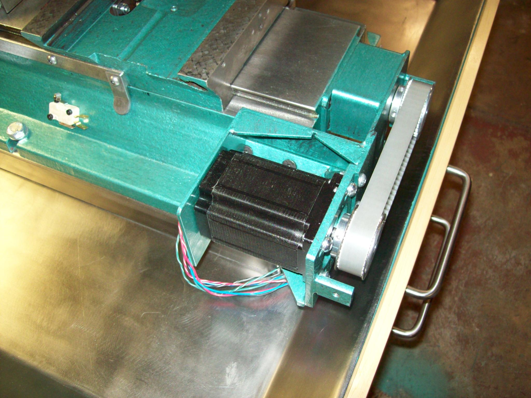

    I'm currently testing the first (Y) axis on my Warco WM16 mill conversion. I'm using standard M542 drives with THESE 4.2A, 3nm stepper motors and have noticed significant vibration at very low speeds. Is this a problem caused by lack of cable screening or is it a setup issue? At certain speeds the whole machine and stand will vibrate. At higher speeds, there are no issues. I've tried running the motor unmounted but it still vibrates at very low speeds. The motor is bolted to a solid mounting. Should I use some sort of rubber mounting to reduce the vibration or is it something I will have to live with?

    I'm beginning to think that the resonance is a feature of the cheap setup rather than a fault? I'd be interested to see what Jonathon and John S have to say about this, as I know they use these drives and motors on a regular basis. The motor is bolted to 200Kg+ of metal so I'm surprised there's any noise. I'm thinking I might need to isolate the motor bracket from the main machine using some rubber sheet. Having said that, the issue is with the motor setup rather than something mechanical. Pics for reference:

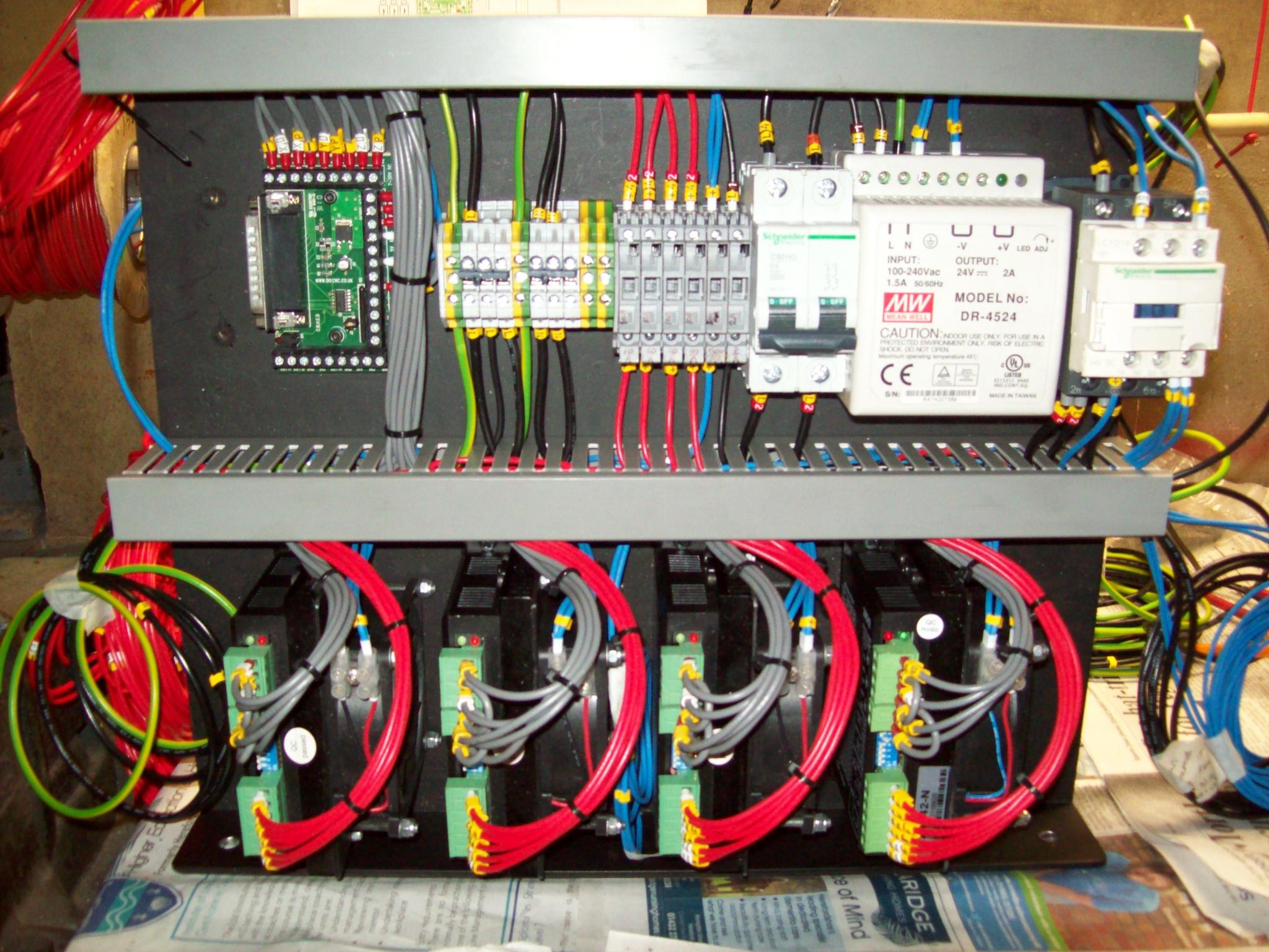

    Is my BOB too close to the mains, I wonder? Having said that, I ONLY get resonating within a fairly tight range of low end speeds. What problems are usually caused by not screening cables? My panel is just straight tri-rated panel wires. I've tried to keep the mains and signal cables apart as much as is practicable. Cables connect to the motors via metal cored industrial 20mm Adaptaflex.
    As a matter of interest are you using ball screws or the original screws? Big credit to the neatness of the panel. ..Clive
    I don't think your BOB is too close to the mains, I used CAT5 4core (2 x twisted pair) networking cable for the connections between the BOB and Stepper Drivers as this eliminates a lot of interference.
    The problem you describe does not sound like a wiring problem and is likely to be resonance. I noticed the gap between the motor bracket and the machine was very small in places and I wondered if they were vibrating against each other like a tuning fork ?
