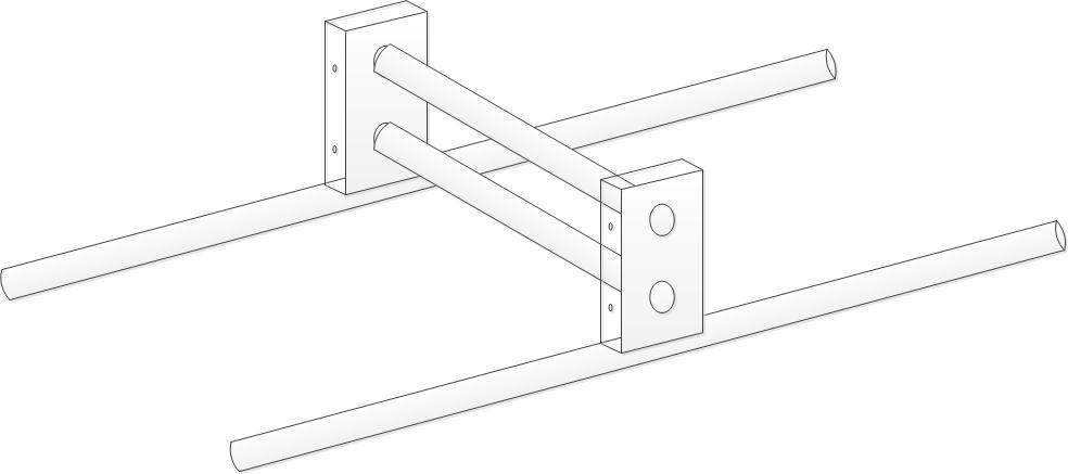

    Ok so my cnc is generally great (for my very very simple needs!) but it does have 1 major failing that i would like to improve. The gantry is made up from 2 20mm round bars spanning approx. 7-800mm and it supporting a 1.5kW chinese spindle and associated mounts. You can imagine what happens - tons of flex/ruined parts - most noticeable when trying to cut sharp 90 deg turns from y to x, ends up with a lovely big curve if I go to fast!
    Here is a rough diagram.

    I also had a situation cutting a long thin pocket running down the x axis - all was going fine until suddenly the spindle seemed to flex down as if was trying to dig into the wood! I guess this was the flexing issue allowing this to happen...
    So my question is how could I possibly improve my situation with minimum cost/rework?
    Two ideas I thought of are:-
    * upgrade the round rail to a larger diameter.
    * change the round rail to supported round rail - I was thinking I could grid off part of the support at each end of the rail so it would fit in the existing holes?
    Any ideas?
    I suppose you have to first establish exactly where the flexing is taking place, it's maybe not where you first think of.
    What about attaching a wide piece of aluminium extrusion or box section from one side piece to the other then fasten supported rail to that.

    Valid point - I admit the only reason for picking on the gantry as being the issue is based on my complex scientific testing - I grabbed the spindle, yanked it around until it flexed! I all feels very rigid except for flexing the spindle up and down.
    That could work really well! Thanks for the idea :)

    From what I have read on this forum, most of the parts are pretty good (I am only cutting thin wood) but the rails are the big area of issue, mainly from an accuracy point of view. Would that be right?
    Also, back to my original issue, does it look like it comes from the flexing on the y axis?

    Can you post a picture of a part which has rounded off corners, which you propose are caused by deflection? The reason I ask is if you have the acceleration set too low for the X and/or Y axis, that will consistently cause the machine to cut noticeable curves in corners if it's in constant velocity mode. Search 'constant velocity' or 'G64' on the forum and you'll find plenty about it. If your acceleration for the Y axis is set too low, then the corners you indicated will be rounded, so I'd start by checking that.
    I agree that the list of parts you have are not bad except for the rails, so if you replaced all the rails and make a rigid gantry you'd have a good machine. The 2.2kW spindle would have been nice, due to the larger collets, but that's minor compared to the rails.
    With £100 you're struggling, as that's not enough to get rails for both the X and Y axes. Without enough funds to replace every 'weak' part, we need to work out which is the least stiff and replace that as it will have the biggest effect overall. The deflection of unsupported rails for a force applied at the center is proportional to the length cubed, and inversely proportional to the diameter raised to the power 4. That means your X rails will deflect (1200/700)^3*(20/25)^4=2.1 times more the Y rails, so I'd be inclined to replace those first. Having said that, the difference is not that great so you would still notice some gain if you replaced either.
    Bear in mind that even if you replaced the rails with just 12mm supported rails, this would still be stronger than your current setup as it is the strength of the supporting structure that matters most when using supported rails, not the rail itself. I would advise using at least 20mm though, especially if wanting to cut harder materials like aluminium, since the extra stiffness of the bearings does help.
    Another option would be to invest the £100 in getting the open bearings that the supported rails use (SBR25 & SBR20) and adding your own supports to the existing rails by drilling and tapping holes in them. That could be a courageous decision though...

    Agree with Jonathan and Pretty sure this will be tuning and CV problem. Post the feed rate in G-code or better still the G-code file it's self so we can check.
    Regards the rest of machine then agree you have a half decent kit of parts so I'd just look to upgrading the Frame. . BUT. . Don't try to do it on the Cheap because there's very little gain for the Money and time invested.!! . . . Best to Save up and buy decent rails for all axis and Beef up the frame where needed.
