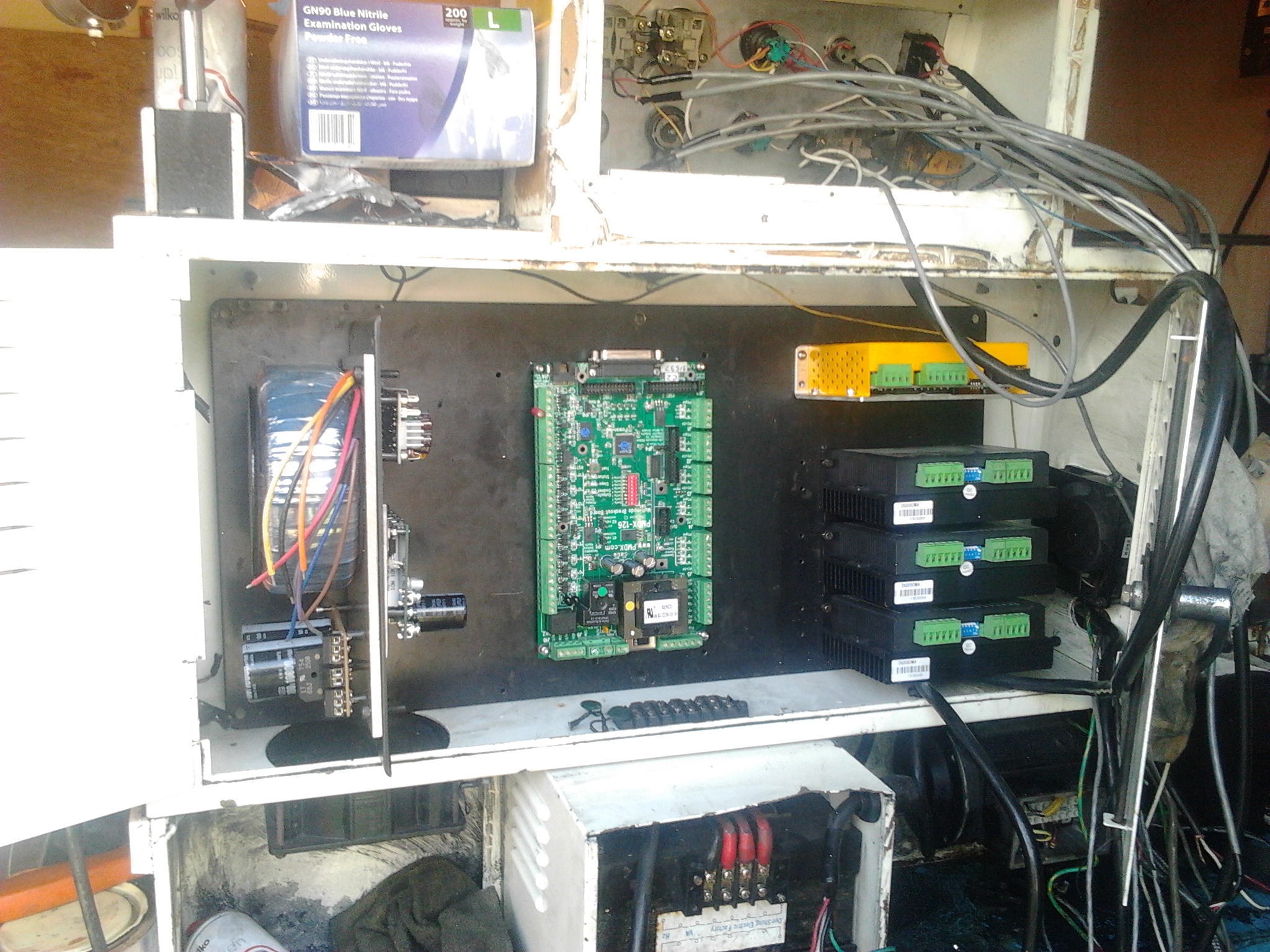

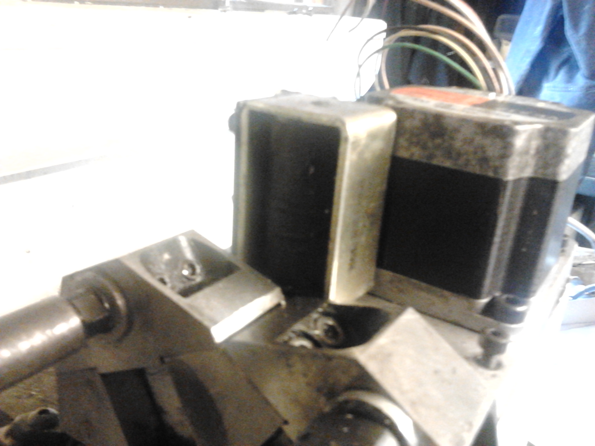

  2. #22
    sorry jonathan id totally forgotten about the above post.
    Ballscrews fitted,steppers fitted,its almost there.
    Attachment 13508
    Attachment 13509
    Attachment 13510

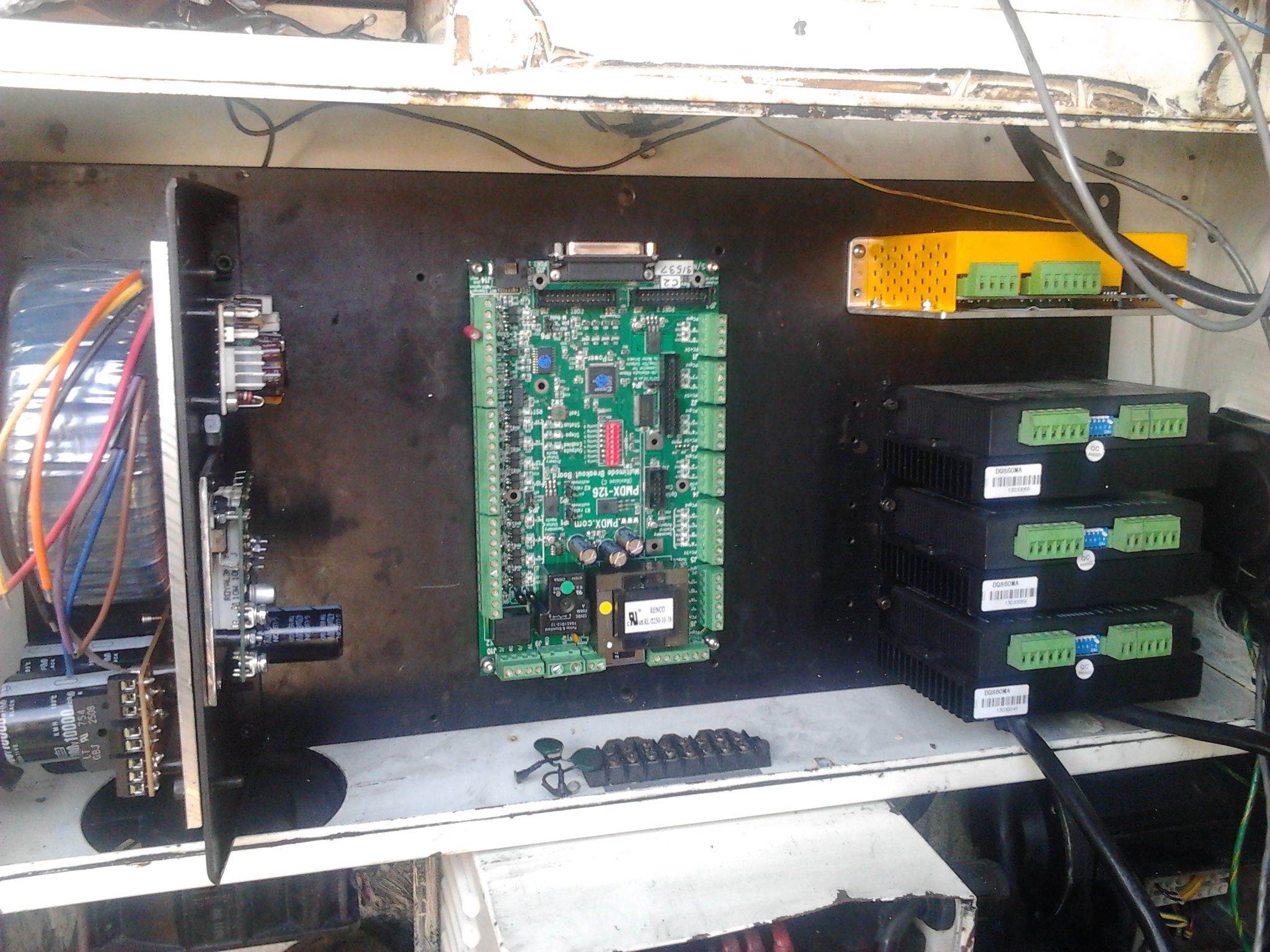

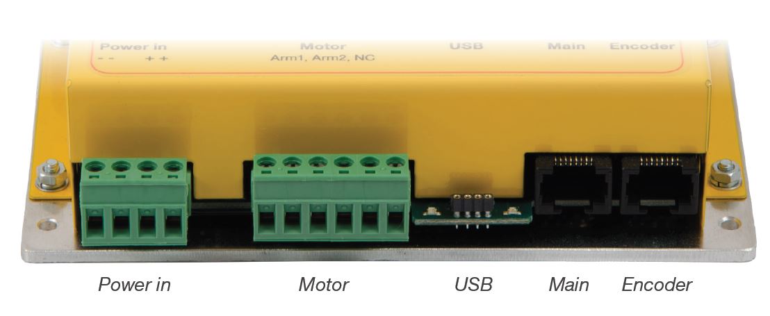

  3. #23
    Ive made a start on the electricals /enclosure (photos will be up soon) and decided to go for the DG4S-16035 positioning DC servo drive and a BRKC-180 braking circuit to power the spindle motor..i had come across a few on the zone using these on there mills with no complaints
Name:	dc servo drive.JPG
    im assuming the heds encoder/blue ribbon will need to be rigged up to this DG drive via one of these differential line drivers in the link http://cncdrive.com/Difflinedriver.html.

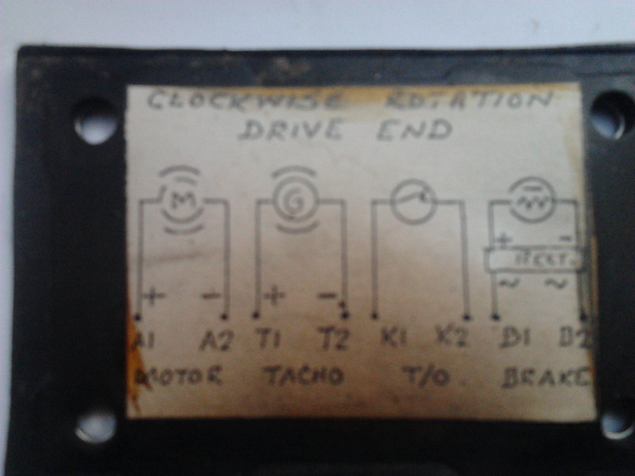

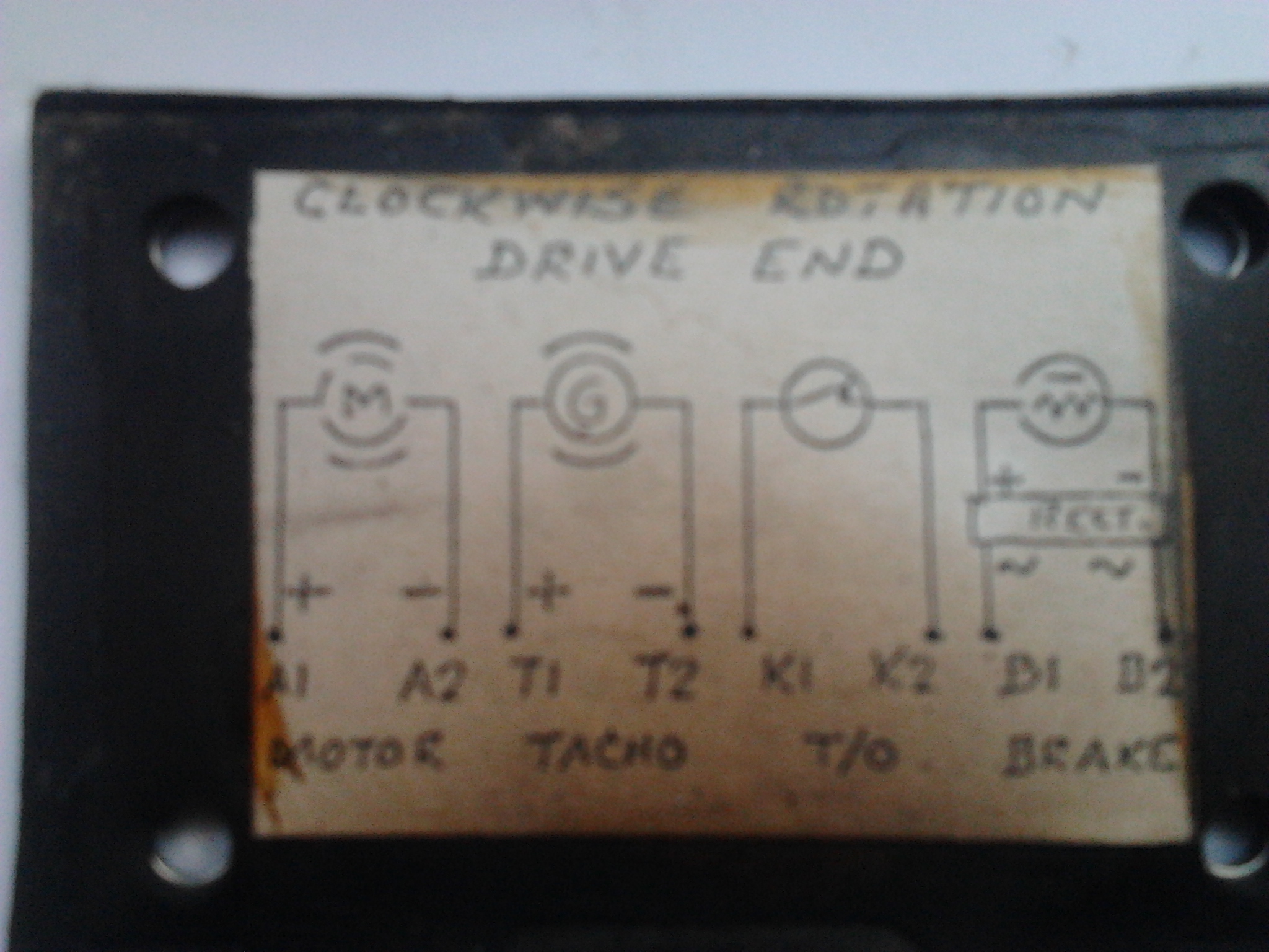

  4. #24
    Had a poke around the spindle motor area took off the wiring cover to reveal the connection block.
    the block is printed with he following wire colours to each letter
    T1 RED
    T2 BLACK
    K1 RED
    K2 BLACK
    A1 WHITE
    A1 BLACK
    B1 RED
    B2 BLACK
    .edited i completely missed the pin out info on the back of the lid so will stick below as I couldn't find it on line edited..what are the K1and K2 wires with the T/0 below it ?
    SEM MT30 U4-48

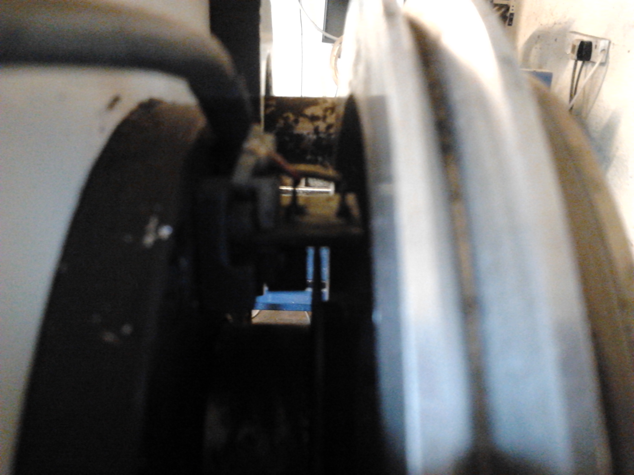

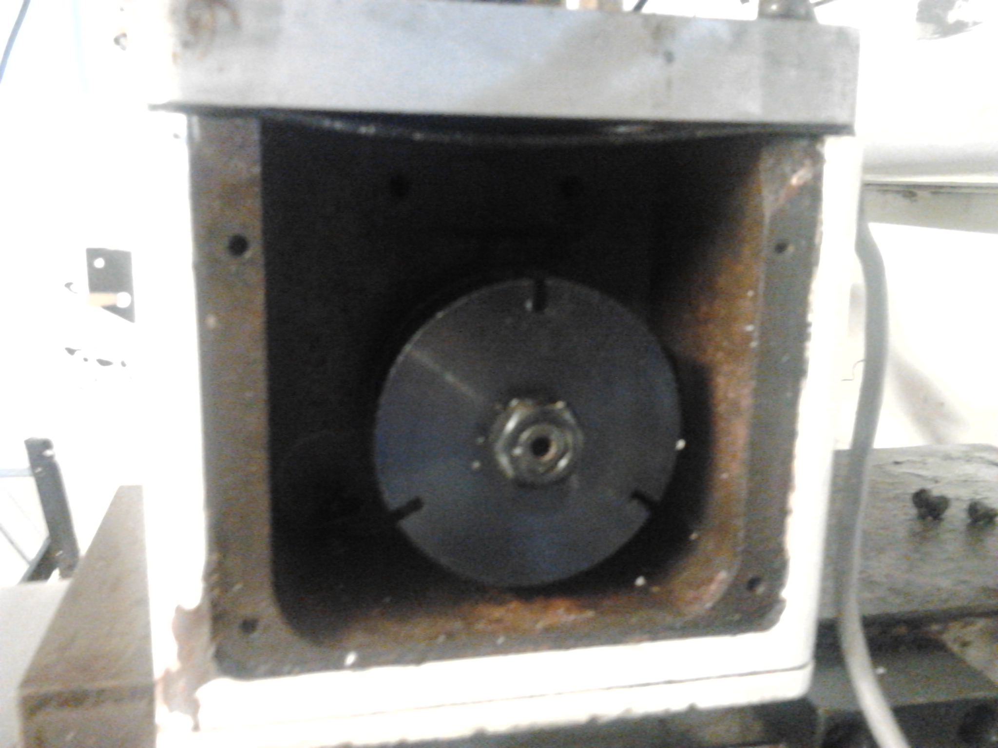

    second question I have is..
    with me using the heds encoder and plugging that into the dc servo drive as the manual instructs,
    is the optical sensor that sits on top of the spindle and the tach no longer required??
Name:	lathe 1 018.jpg
    I don't understand why I would need 3 forms of feedback yet they were all installed as standard when the lathe was in its original state.

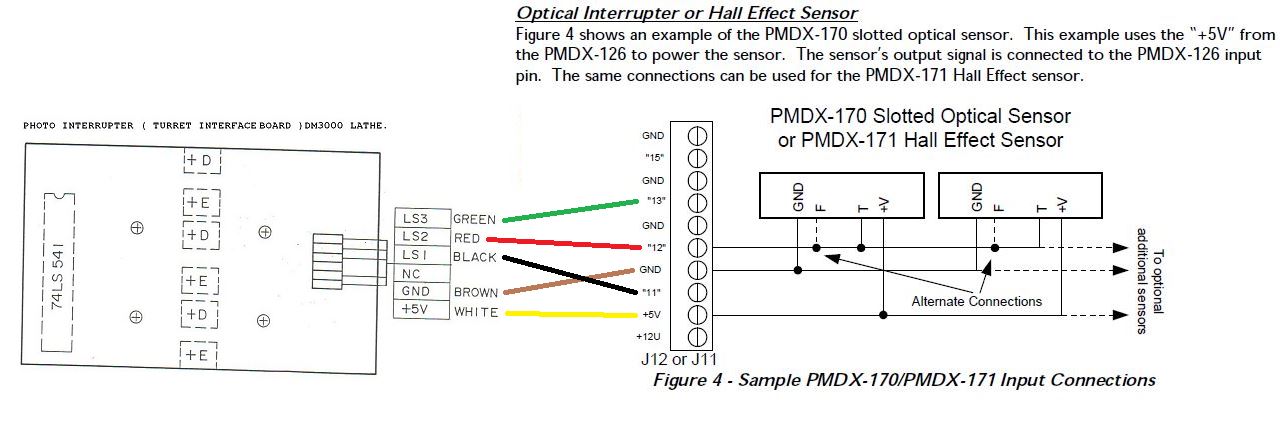

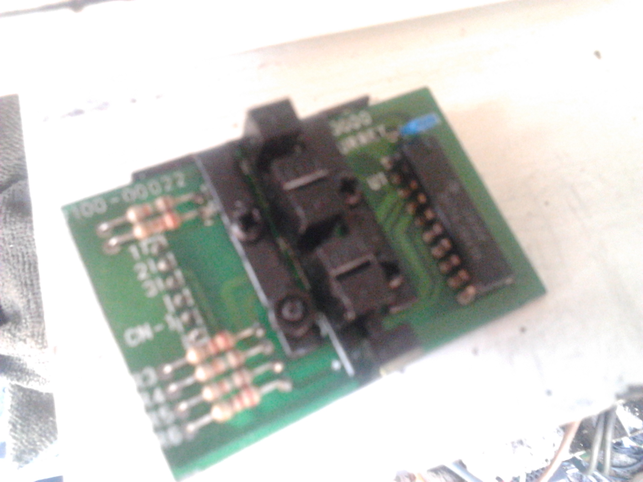

  5. #25
    It turns out I don't need to be concerned with anything other than the encoder so I don't need the rest
    im on the wiring next,it wont be pretty.

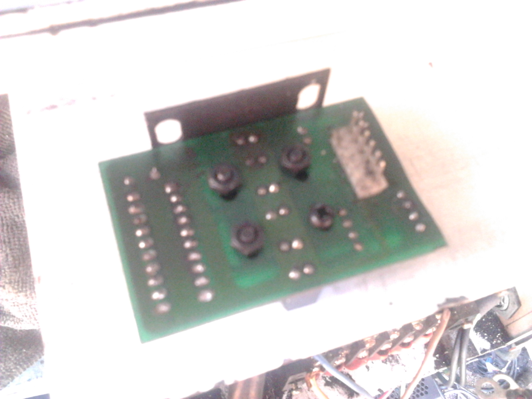

Name:	turret board 006.jpg
Name:	turret board 001.jpg

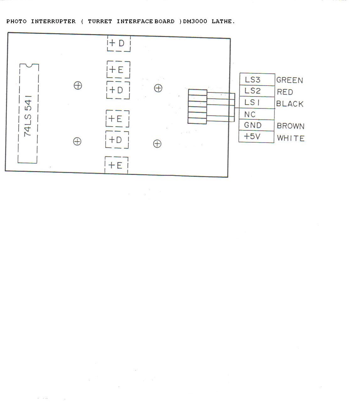

    ive no experience with electronics but I should be ok with wiring the drives getting the motors moving etc
    one thing im struggling with and cant find info on is the tool turret card and the 24v solenoid that operates the turret lock and how/where I would go about wiring these into the pmdx 126 board.
    EDITED Found the info for the board
Name:	turret board drawings 1.jpg
Name:	turret board 011.jpg
ID:	13242   Click image for larger version.
Name:	turret board 010.jpg
ID:	13243   Click image for larger version.
Name:	turret board 027.jpg
ID:	13244   Click image for larger version.
Name:	turret board 030.jpg
  6. #26
    Quote Originally Posted by deisel View Post
    thermal overload, over temperature probably
  7. #27
    right apparently I can use the k1 relay on the pmdx board to work the turret solenoid .
    does the wiring from my turret board to the pmdx look ok in the image below?if so can/should I daisy chain the grounds on the pmdx?
    Ive also received an email telling me as the lathe has a turret I will need either a smooth stepper or a second parallel port.. so im thinking this if anyone has any thoughts on it.http://www.cncdrive.com/UC300.html
Name:	turret board to pmdx 126.JPG
  8. #28
    Not sure if the PMDX is common gnd (Edit: Looks like it is) or if the 5V Gnd is isolated from the inputs.? If common gnd it will use the 5V supply Gnd as it's potential ref so won't need jumpers. If not then you will need you to connect the Input Gnd's to 5v supply Gnd's. In either case won't hurt to daisy chain if unsure.
    Same if you use external 5V or 12V you will need to reference Inputs to that supply's Gnd.

    Getting there :)
    From the video it sounds like the solenoid on the ATC, which holds the tool rack rigidly, is not being activated. Once it's wired up (using a spare relay on the PDMX or an external one, with the 24V psu) you can configure it to one of the outputs then add a line to the vbscript which runs the ATC. For example if you set the solenoid on to output #2 and put the correct pin for the relay, then you just add the line 'DeActivateSignal(OUTPUT2)' to the start of the script to switch the solenoid off so the rack can rotate, then put 'ActivateSignal(OUTPUT2)' at the end of the script to switch the solenoid back on.
