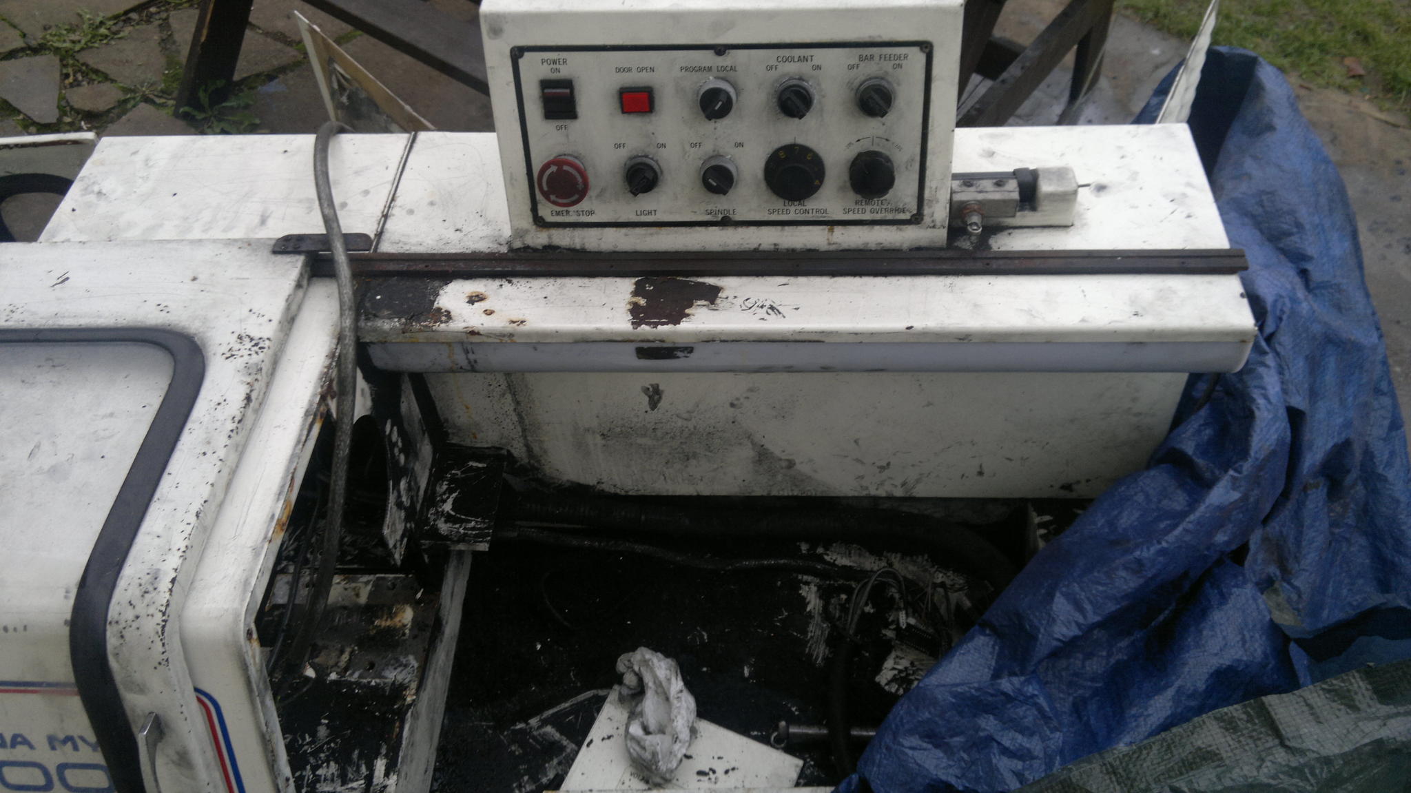

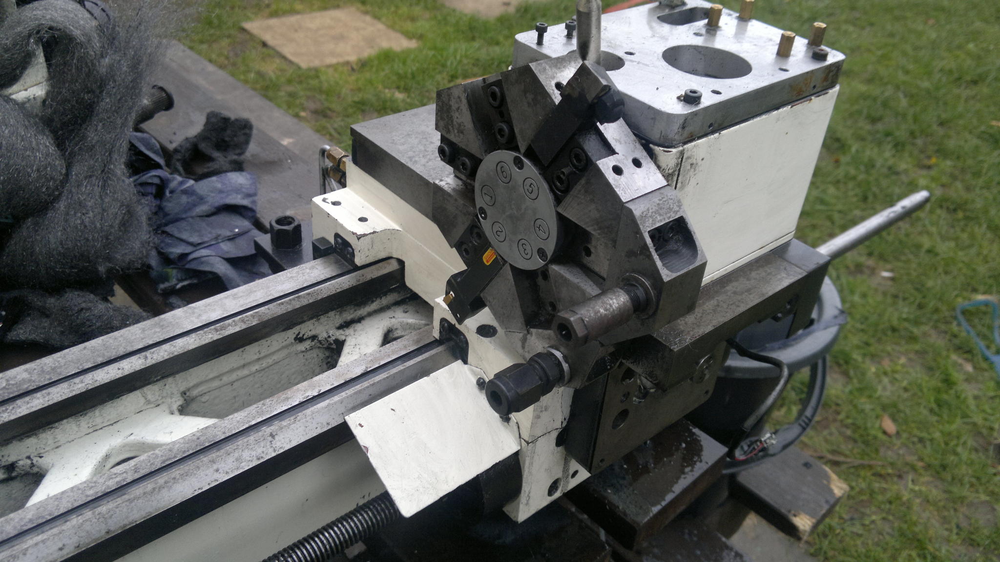

    This is a first conversion of any kind for me and im not sure where to start what needs to go what to keep particularly with the tool changer:
    theres an almost 3/4 inch thick manual that came with it so a fair bit of reading to do and i will add to the thread as i go.
    edited to add the parts list so far

    Quote Originally Posted by deisel View Post
    I think start by giving it a thorough clean, then oil it. It looks like you've got it outside at the moment so you definitely want to put oil on the bed and get it indoors asap to stop it rusting.
    what needs to go
    It depends if you need to convert it to mach3 or not. If the existing system still works, then you'd save a lot of effort just leaving it as it is.

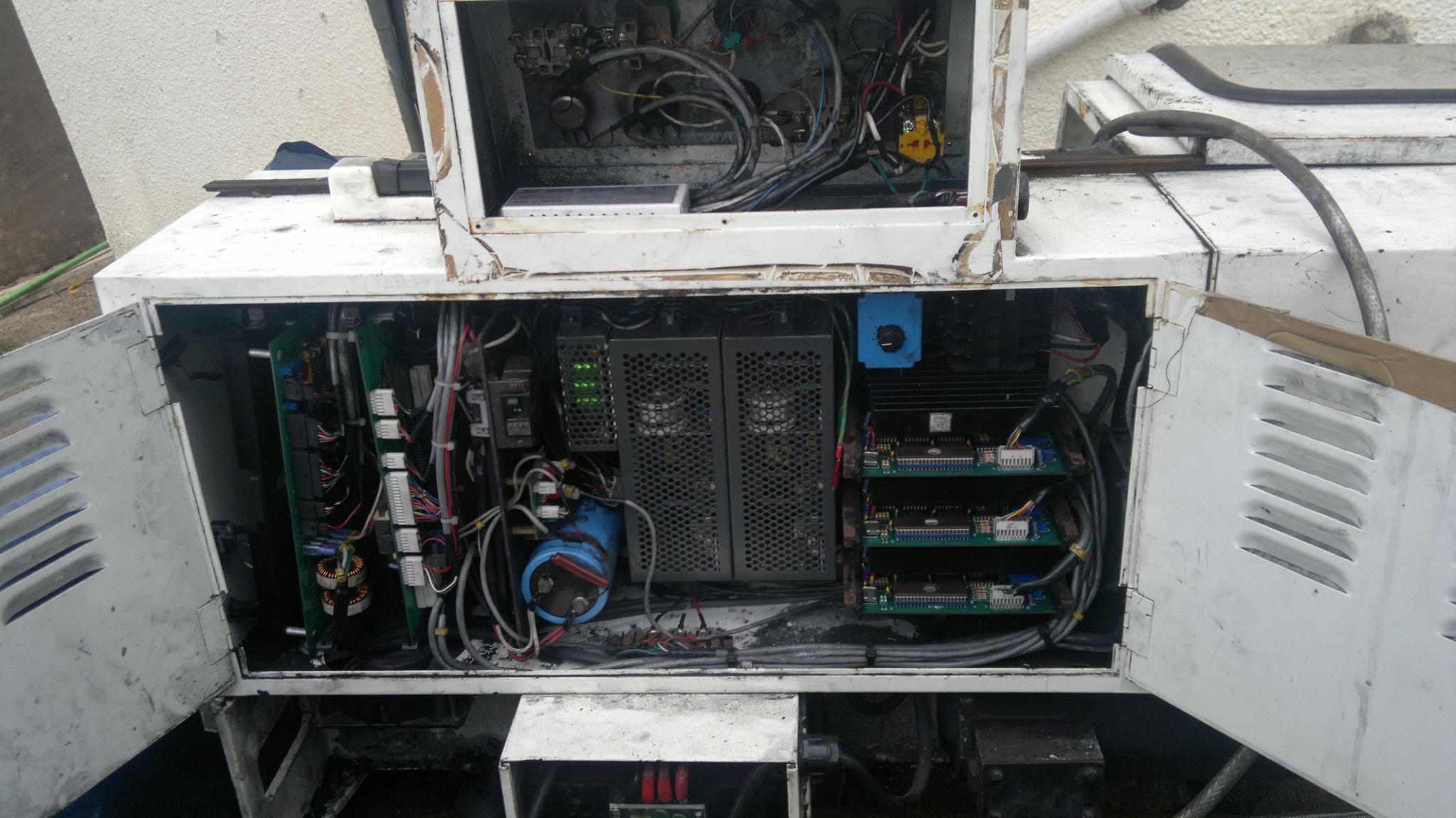

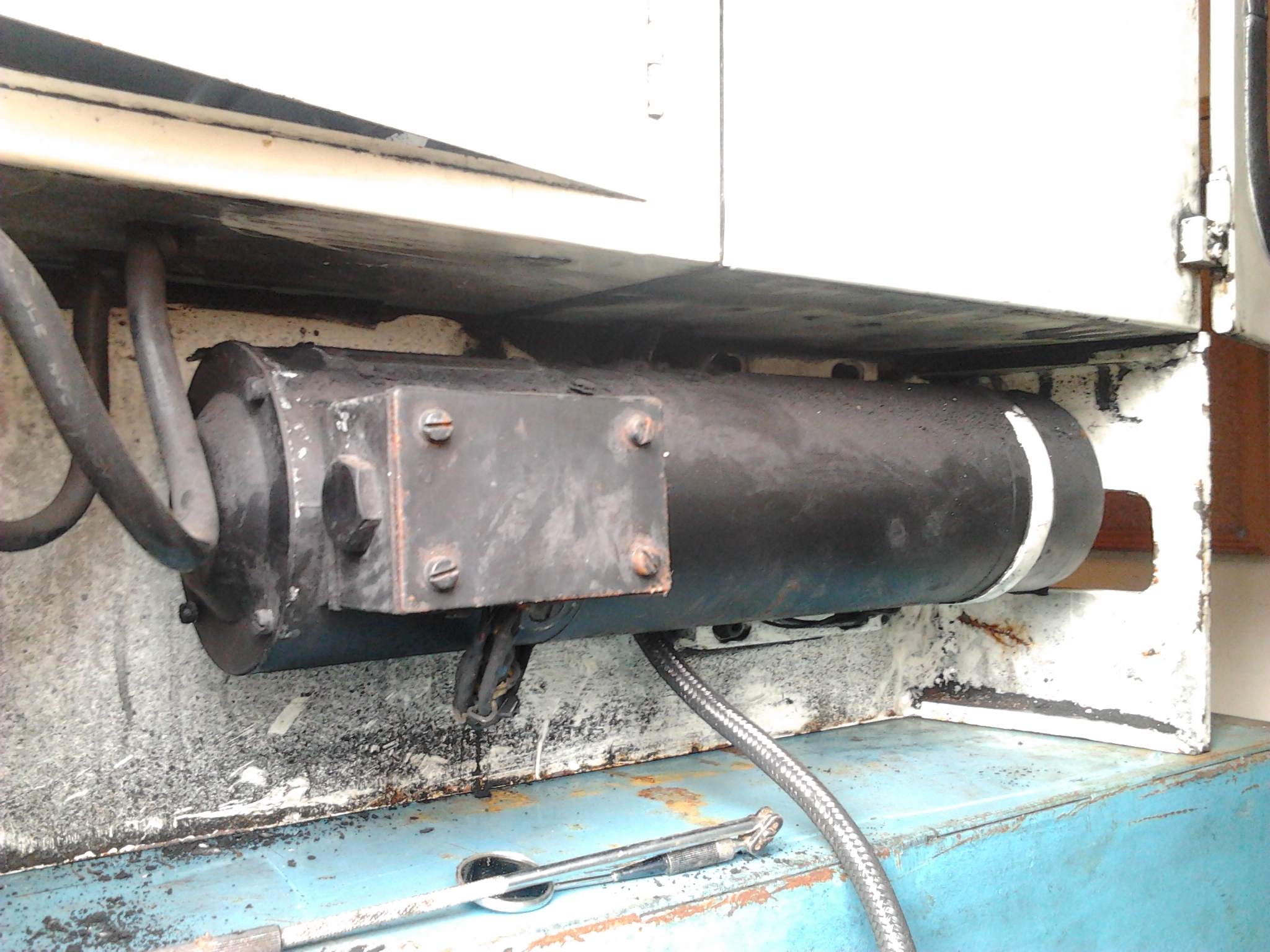

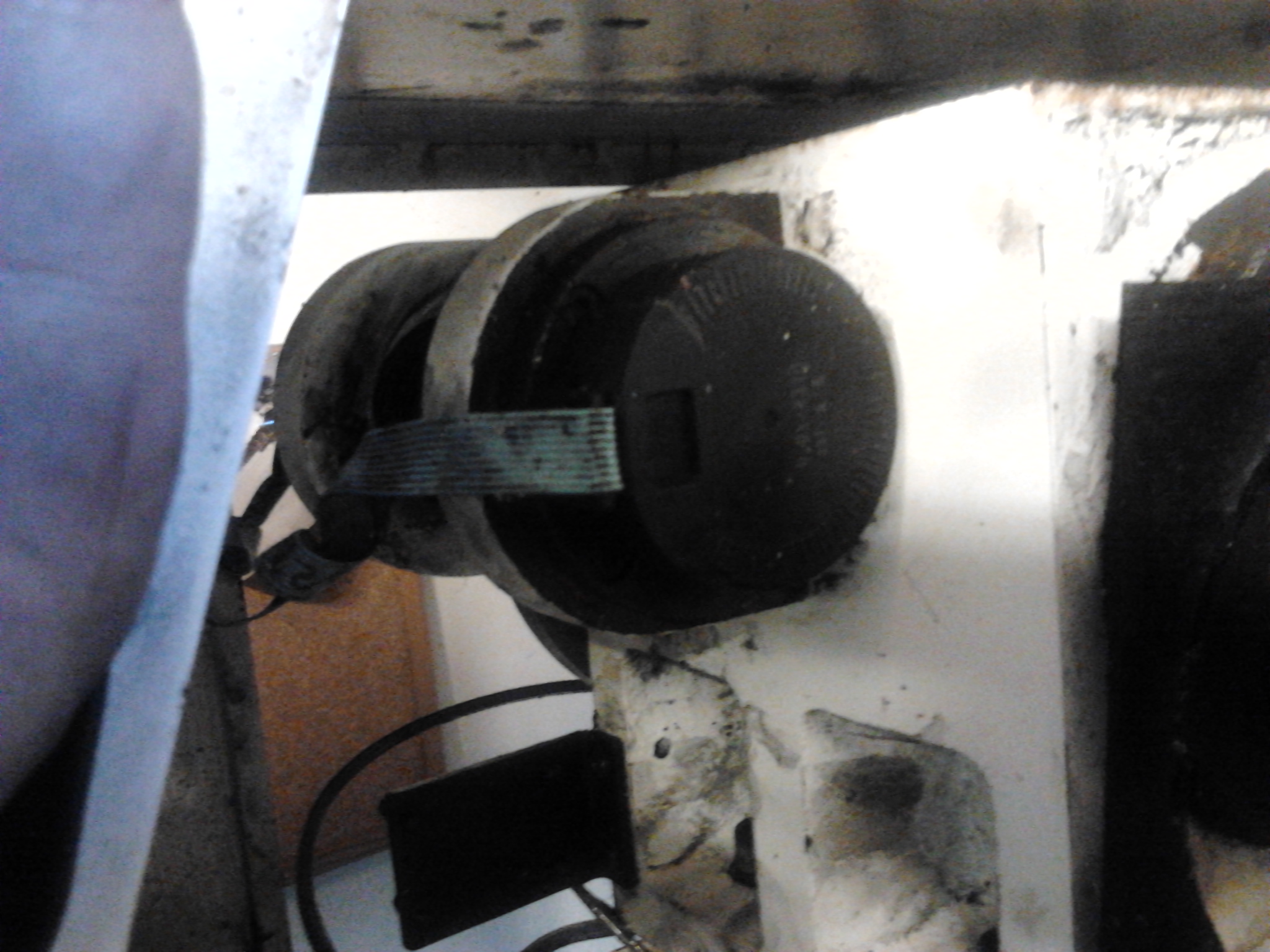

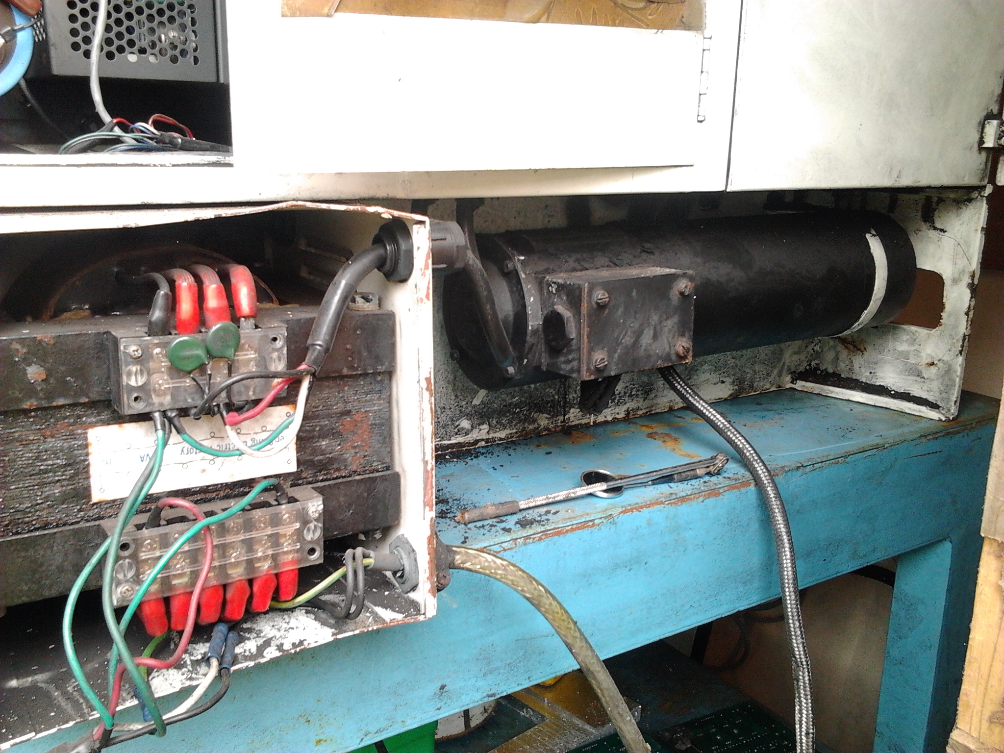

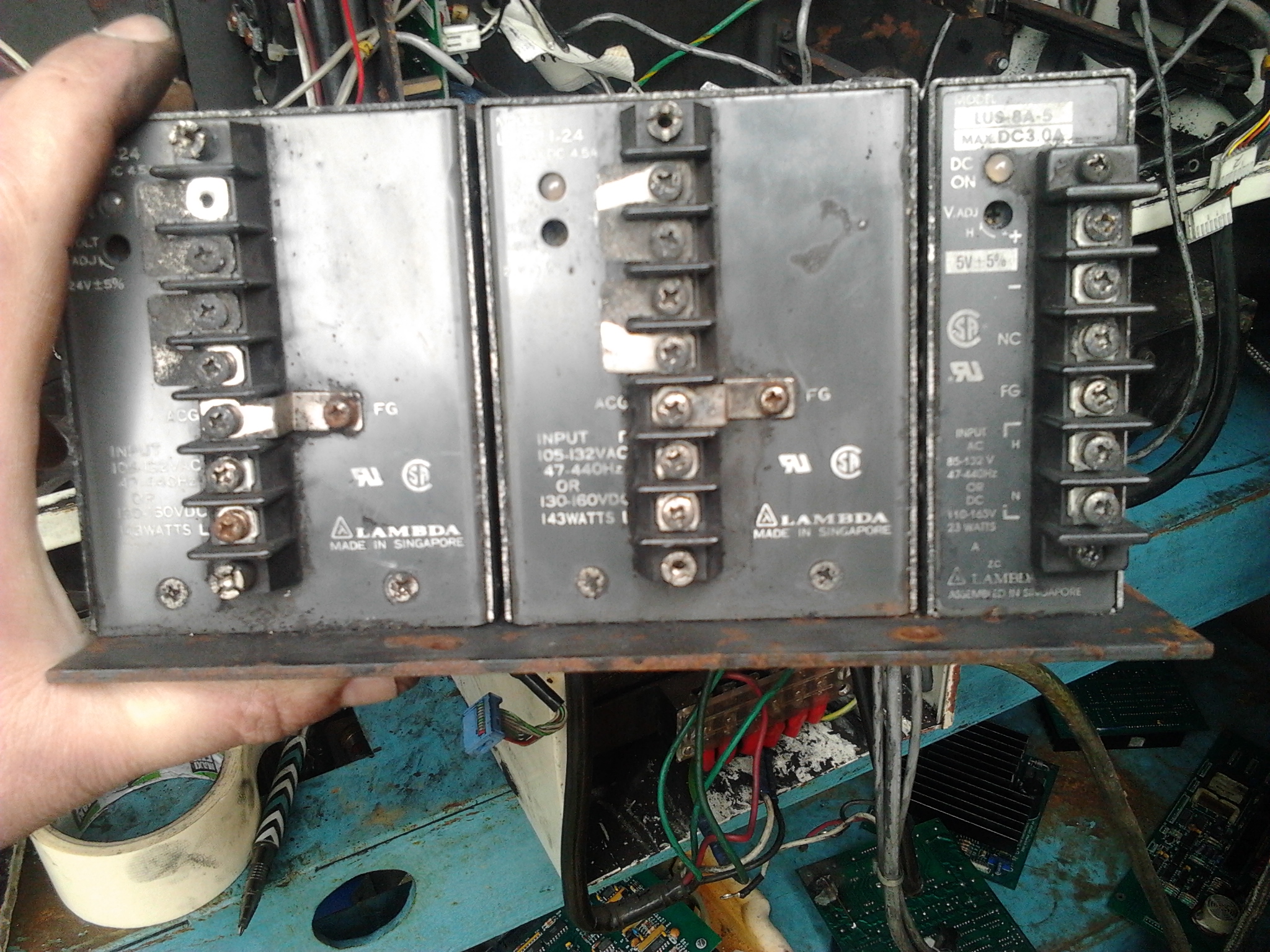

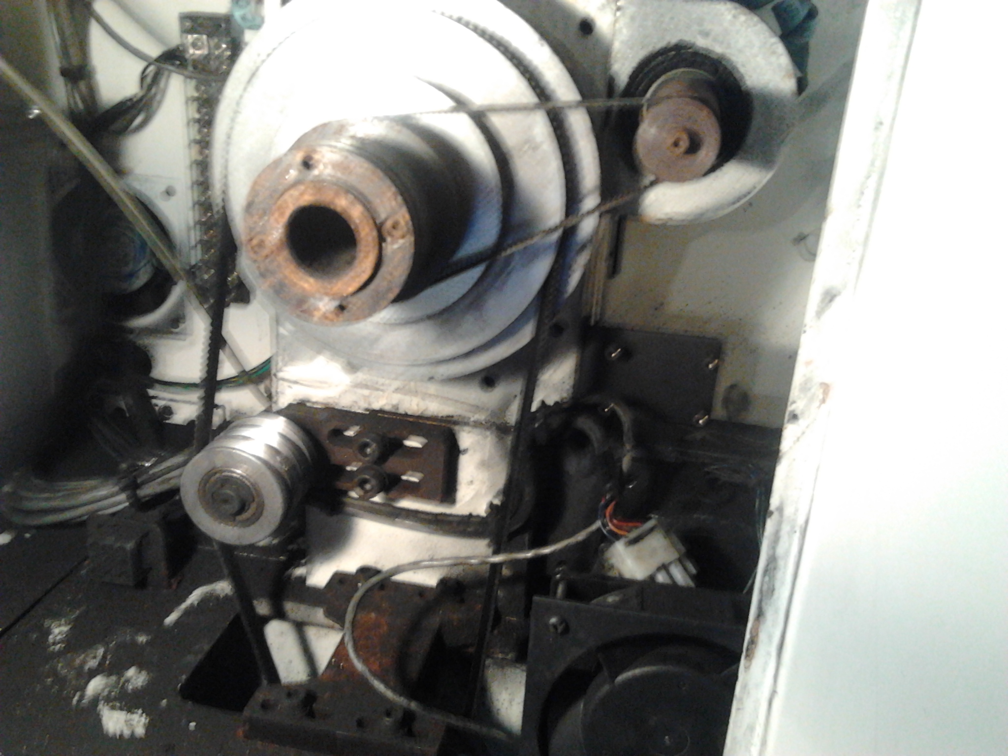

    Easiest option is just remove everything from the control box and start again, but you might be able to save a bit by re-using some parts. For instance the power supplies might be suitable for modern stepper drivers, so check their voltage and current ratings if you can. Look at what the spindle (which oddly enough I can't see in the photos?) is connected to - there's likely an encoder and some sort of driver for the motor. Also see what the toolchanger connected to.

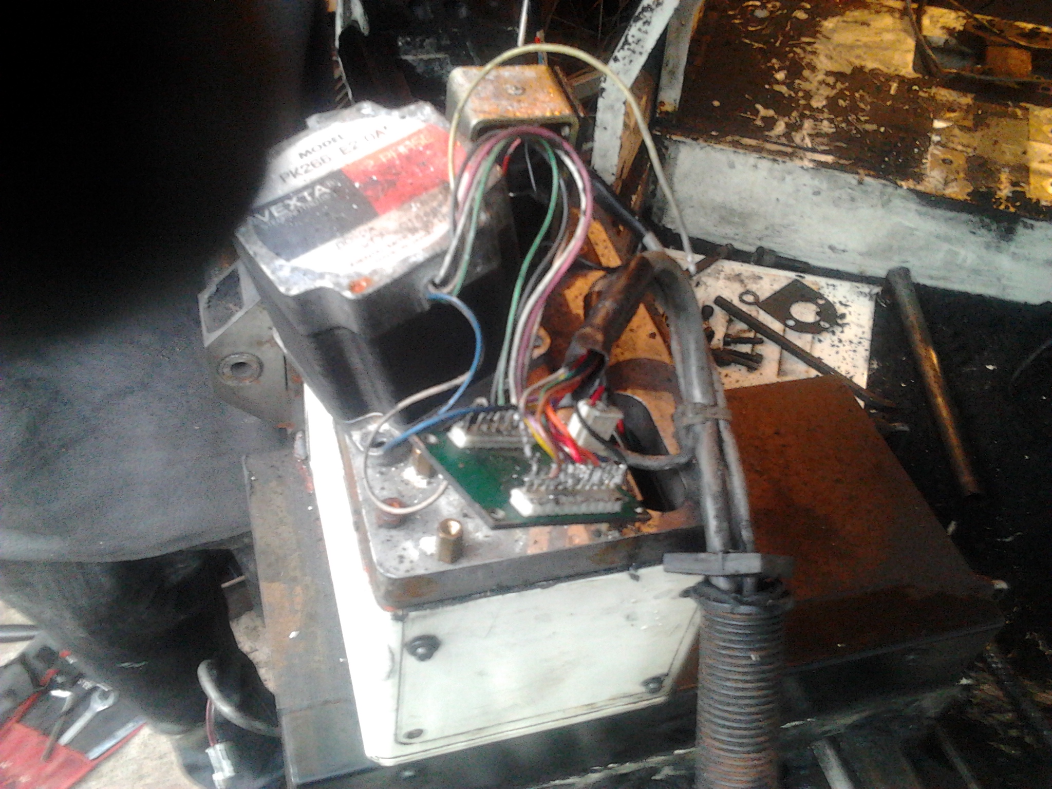

    From your pictures it looks like the stepper motors are Nema34. Have you tried googling the part numbers on them to see if you can find a datasheet? If you're lucky the current ratings might be written on them.

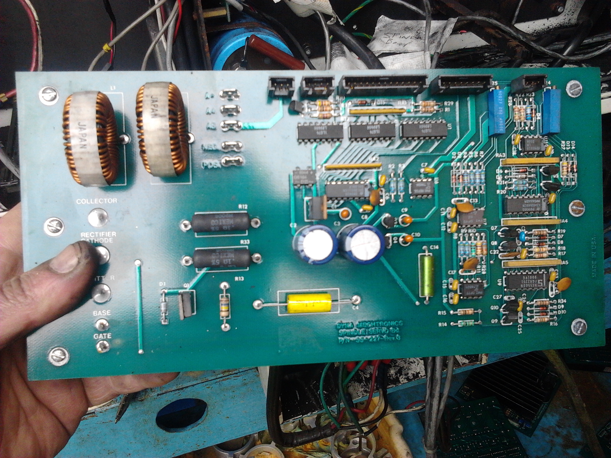

    the spindle motors an SEM MT30 U4-48 MT30 Series Servomotors
    theres a big board see image for the spindle motor, theres so many parts,and the manual really only covers operation and maintenance below spindle servo board p/n-ss-227-rev.3

    the power supplys are both 24v and the one on the end 5v

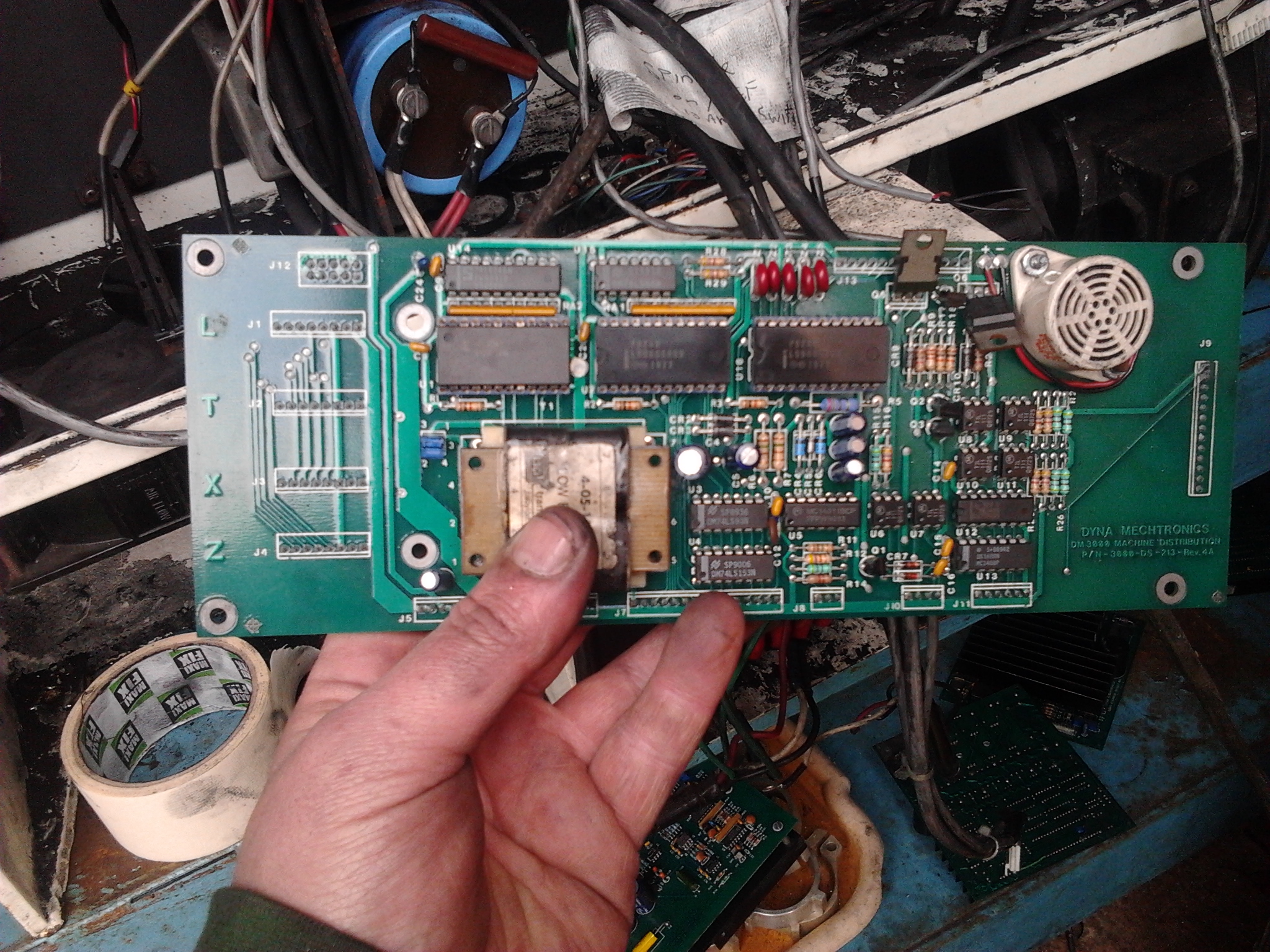

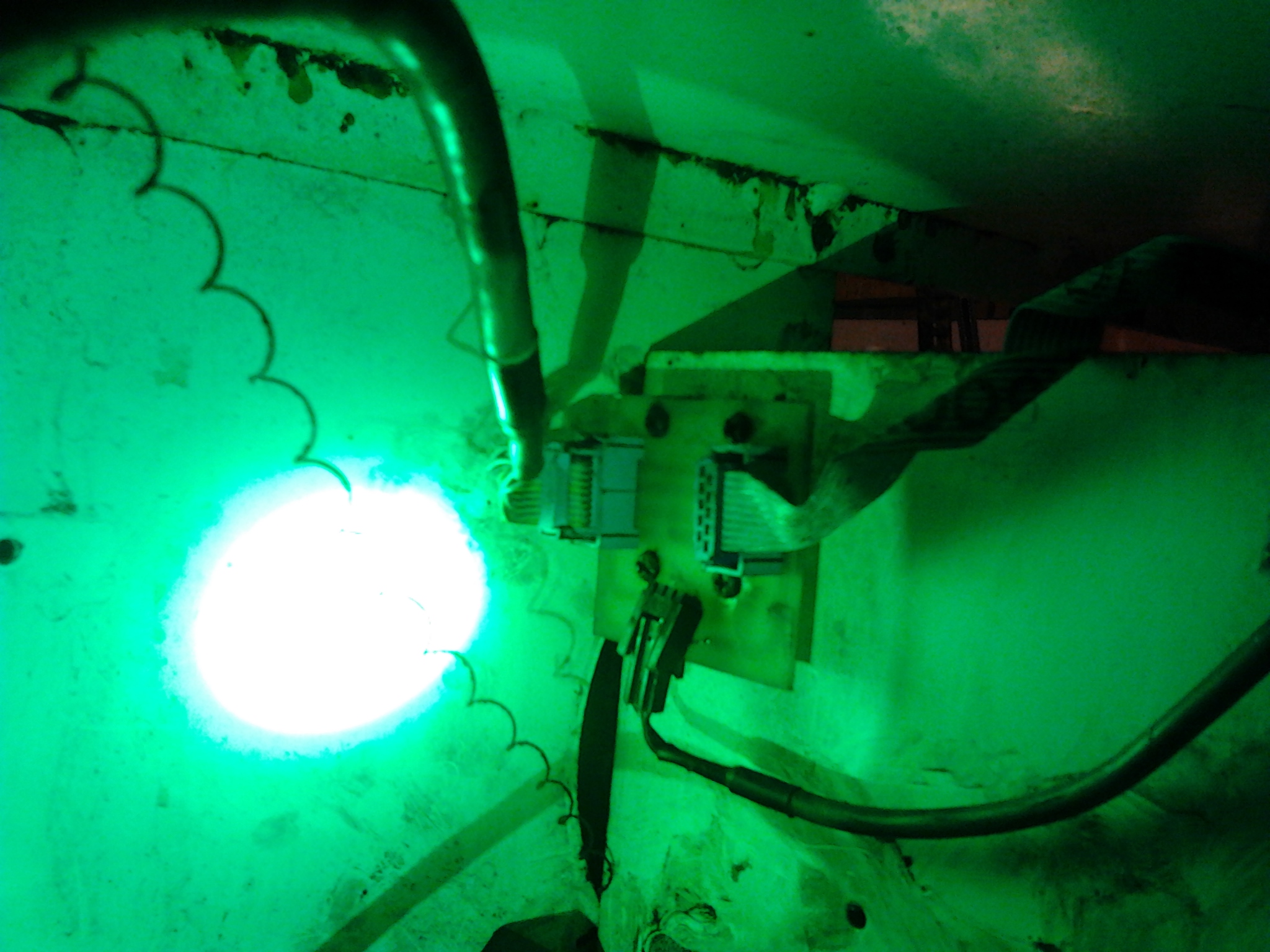

    various other bits,the board below looks to be some kind of breakout board, theres connector sockets marked L,T,X,Z, T being for the tool changer and the L? and a blue socket on the back the encoder ribbon plugged in to. p/n-3000-ds-213-rev.4a

    drivers were in a sorry state and looked to have been repaired a number of times

    tach

    ive attatched pdfs of all the electronics,a lad on the zones also given me a macro for mach3 that was written for this toolchanger,
    im hoping to do away with all the electronics if i can and re-new with up to date stuff.
    im told the company it came from was forever having someone out to sort out the electrics so they give it the boot.
    Attached Thumbnails Attached Thumbnails DM-3000 Stepper Driver Board Schematic.pdf   DM-3000 Machine Distribution Board Schematic.pdf   DM-3000 Spindle Servo Control Schematic.pdf
    Since most of the things seem to be opto-isolated, it would be relatively straightforward to connect a parallel port breakout board to these opto-isolators, and have Mach3 control them directly. Perhaps do that for the spindle and ATC, but replace the stepper drivers with modern ones? Do you know what part of the electronics kept going wrong with it?
    Im not sure what was wrong with it,.I bought it fully committed to convert it to mach regardless of wether it worked or not as trying to run it via the factory control system looked like a bit of a head do-er and as im used to mach..
