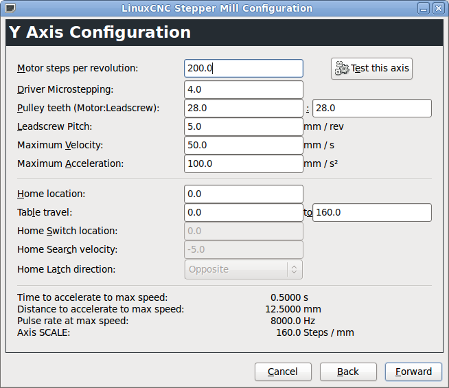

    I'm using LinuxCNC set as per the picture below. Dip switches on drive are set to 800 steps (all switches 'off' except for 5, 7 and 8). I've also tried running at 1600 steps (and changed "Driver Microstepping" to 8) which did improve the resonance slightly. At 3200 steps, I had some error message related to the RTAI (realtime kernel). I didn't look up the specifics of the error as I just assumed it was related to the step rate being too high.

    Sorry for assuming you used Mach3, from my limited knowledge the settings appear to be okay, you've probably been at this longer than me anyway. I would be into trying a different motor and swapping the M542 just to eliminate those from the equation. If you think it's maybe a screening problem why not run a temporary cable between the motor and M542 that is well away from everything else. There was another thread a few weeks ago about rubber mountings and I suggested using heatproof silicone sheet like this SILICONE RUBBER SHEET 200MMSQ, 1,1.5,2,3,4,5,6,8,AND 10MMTHK | eBay, but the opinion was to bolt the motors straight onto metal.
