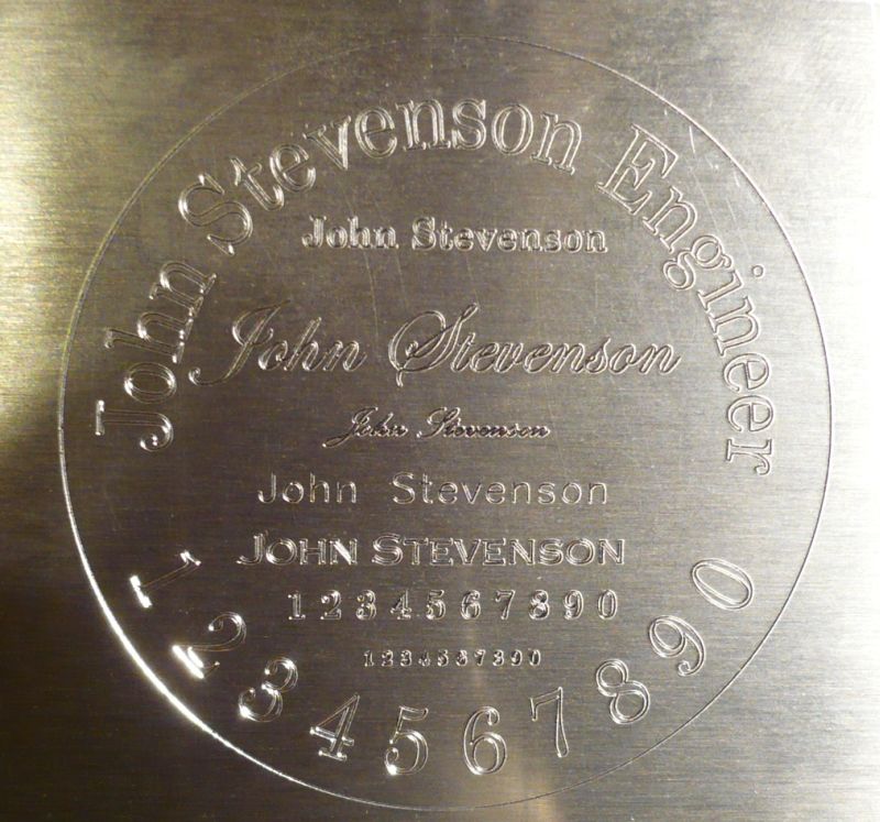

    I have a little Roland 2200 engraver here, year dot, works by dragging the carriage on bowden cable on a plastic capstan. I have removed the spindle motor and replaced it with a diamond drag.
    It's powered by a 24v Yoohoo board which was spare.
    The whole thing is crap, it's slow, max speed is 3.2 furlongs per fortnight but it works and if I engrave some small letters in stainless [ Yes will do stainless ] then run the same program it doesn't double cut at all so accuracy and repeatability is spot on.
    Thing is it does the job which is engraving gauges. If i posted this as a build on this forum I'd get shot down in flames but this is an example of the work.

    That circle is 50mm diameter and the small script name is less than 1/2mm high.
    So 32mm/min .. that's about what my mill did when I first converted it using an old unipolar stepper driver!
    I certainly wouldn't do any shooting there, as an engraving machine is the right application for unsupported rails. The obvious reason is the cutting forces are low, so the appropriate size unsupported rail isn't too large. As soon as you require a bit better material removal rate, the required unsupported rails size is so large that it's much more economical to use supported rails. The problem is all too often people post a design with unsupported rails and expect it to work well at much more demanding tasks.
