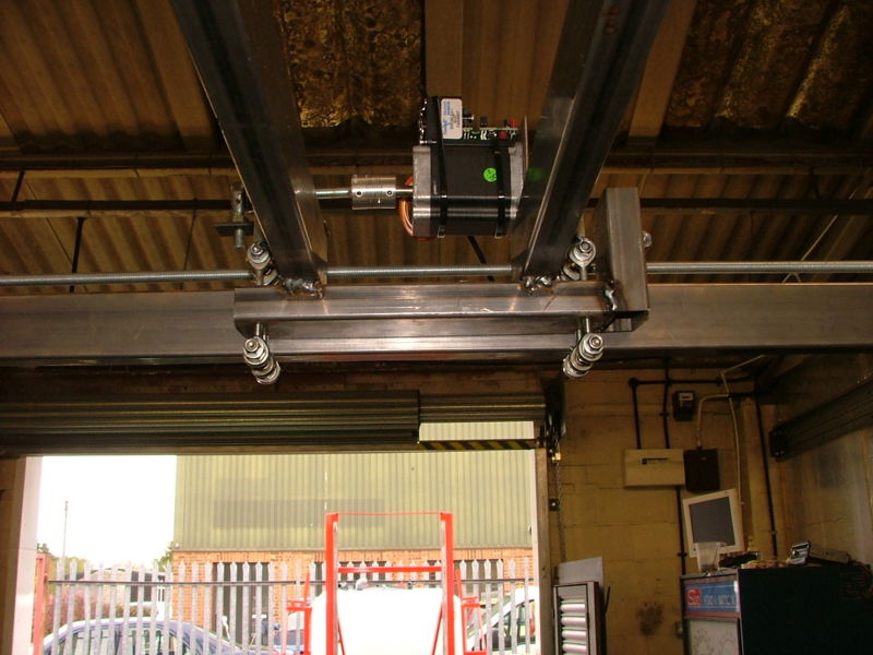

    The second picture is of the X-axis carriage. It used the frame itself as the track, and spherical rod-ends that could be adjusted to clamp bearings in place, and allow any potential twist in the X-frame to be ironed out.

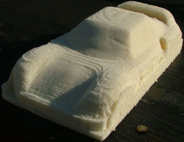

    The third picture is a model that I cut out of insulation foam (extruded polystyrene) of the car that I'm designing using the machine. Unfortunately, I leant on the table causing it to flex, so there's a few contours that are a little out as a result. Unfortunately, I didn't realise I'd had that effect until I'd done it a few times, and even after then, I kept forgetting :)
    The windscreen's been sanded a bit, but the rest of the body is as expected.
