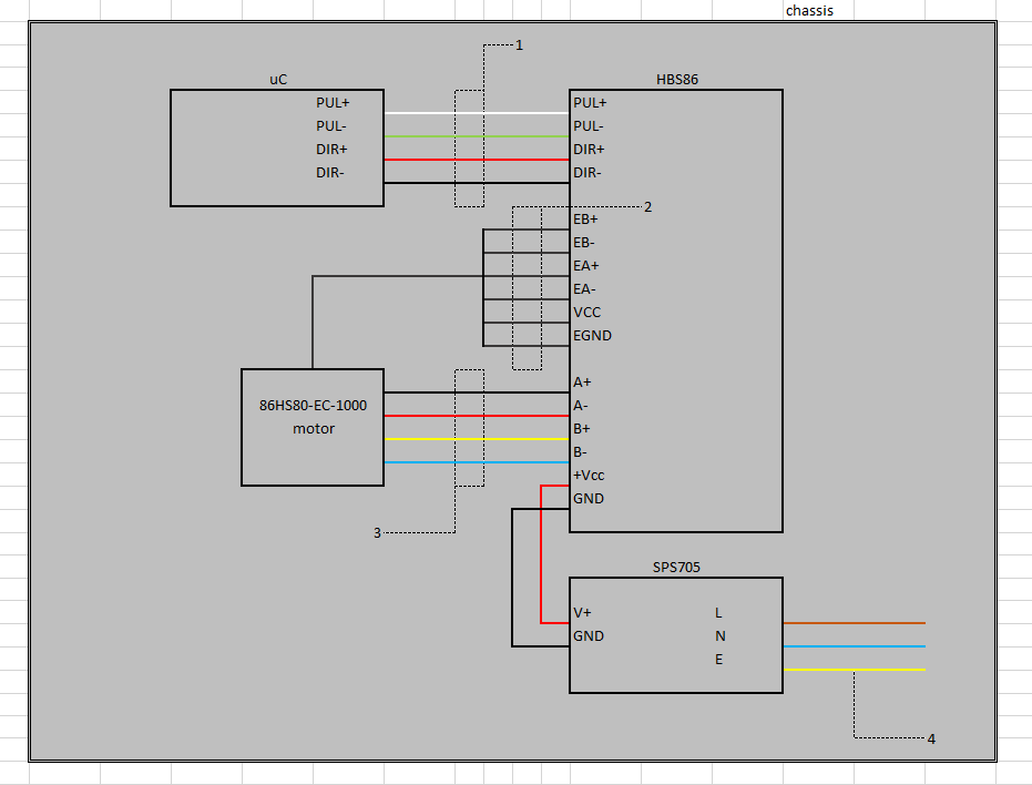

    I'm using a HBS86 + 8Nm motor with a 68VDC supply and driving this with a PIC based uC system via a PWM output. I've coded up a ramp start function, which generates a PWM with a variable frequency to ramp the motor up from 60RPM to 240RPM. On the scope all looks good, on the motor it works, but I can hear the motor sometimes glitching, as if it's loosing steps. I've even seen a 'positioning error' once on the driver, it needed a power cycle afterwards to get things going again. I'm using screened cables, but currently haven't got the screens connected, so I thought maybe this is the reason. Here's how it's connected:

    I've numbered the screens, should all 1-3 be connected to 4 - E(arth) / chassis? I'm guessing I need to put a link between the E(arth) terminal and the chassis as well to get the whole chassis earthed?
    Thanks in advance for any suggestions.
    Yes I would connect them all together but each cable screen should be earthed at one end only, the other ends should be insulated with some heat shrink sleeving for example.

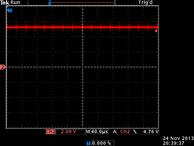

    I've connected the screen (one end, the other is tied back) for the PUL / DIR inputs into the E(arth) on the PSU, not much difference though, here's a shot before the screen got connected:

    Minimal difference, although there's a lot of noise on that line (that's the PUL- / GND scopped). Not sure what it is, or how to get rid of it. On the other hand, the proto board is a mess full of breadboard wires, so isn't exactly super noise resistant.
    I can't capture a long scope, I can only do a print screen kind of capture which isn't good enough to show how the PWM frequency changes. I can see a rolling effect ie. frequency increasing on the scope when the motor starts, but I don't know what causes the glitches on the motor. It stopped again with a positioning error today, don't know why though.

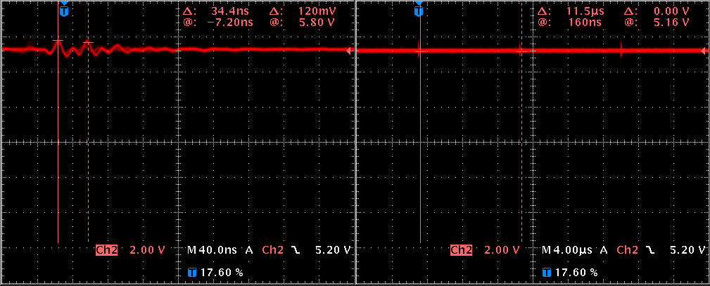

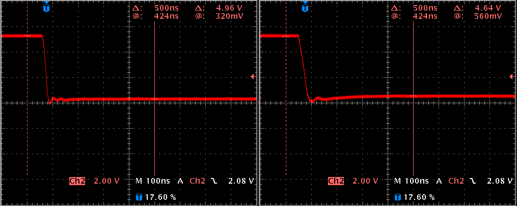

    I've done some further testing on this, here's my findings:
    1) as soon as I plug the DC supply in, there's noise on the PIC lines. It doesn't matter if the PIC lines connected to the driver or not, the noise is still there:
    It's periodical, with a period of 11.5us, which gives a frequency of around 87kHz.

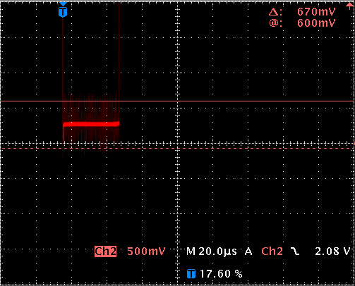

    2) plugging the PIC control lines to the driver, causes the low levels to jump up by around 100mV, I wasn't expecting that to be honest:
    3) there's loads of spikes on top of the PWM signal, see here:
    Not sure this makes a lot of difference, the high level trigger for the HBS86 is > 3.5VDC and low is < 0.5VDC, so it should behave itself.
    Any ideas on how to tame this? screening to earth doesn't seem to affect the noise at all. I've also tried ferrites, with not a lot of luck.
    Regards,
    dsc.

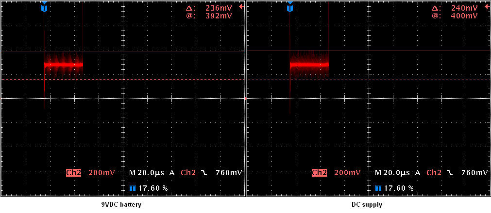

    Chances are it's a switch mode dc supply, in cases like this I used to connect the circuit to batteries as this eliminates a lot of problems straight away and indicates where the main problem lies.
    dsc's Avatar
    Lives in Lincoln, United Kingdom. Last Activity: 17-06-2020 Has been a member for 9-10 years. Has a total post count of 252. Received thanks 1 times, giving thanks to others 11 times.
    Cheers EddyCurrent, I was thinking it's something to do with the plug-in DC power supply I'm using for the PIC circuitry running in parallel with the big 68VDC PSU. I will try a 9VDC battery and report back.

    dsc's Avatar
    I've switched to a 9VDC battery, not much difference, after which I've earthed the driver chassis, which dropped the noise levels significantly. Comparison between a battery supply and plug-in DC supply with the driver chassis earthed:
    I'll stick with the plug-in supply and keep everything earthed.
    Regards,
    dsc.

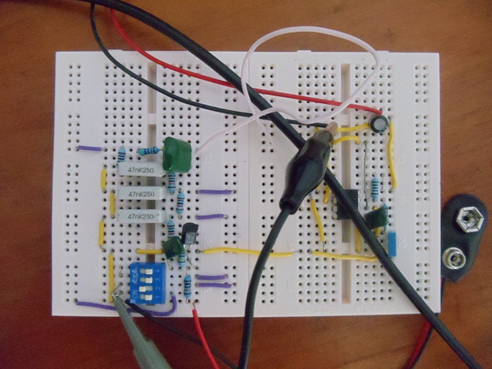

    Your code looks like it should be fine.
    Quote Originally Posted by dsc View Post
    So did it solve the problem? Since using a battery didn't make a difference, that implies the noise is not emanating from the supply. The most likely source is the 'mess of breadboard wires'. You should aim to keep the wires short to minimize stray inductance, keep power wires close together for the same reason and use decoupling capacitors.
    For example, you can see in this photo how the breadboard on the right uses much longer wires than necessary and the capacitor is a long way from the IC. My one on the left is neater...
    The circuit above still worked as it operated at quite low frequencies (where stray inductance is less of an issue). If it hadn't then it would be worth rearranging it.
