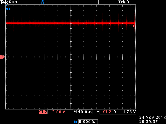

    I've done some further testing on this, here's my findings:
    1) as soon as I plug the DC supply in, there's noise on the PIC lines. It doesn't matter if the PIC lines connected to the driver or not, the noise is still there:

    It's periodical, with a period of 11.5us, which gives a frequency of around 87kHz.

    Any ideas on how to tame this? screening to earth doesn't seem to affect the noise at all. I've also tried ferrites, with not a lot of luck.

    Chances are it's a switch mode dc supply, in cases like this I used to connect the circuit to batteries as this eliminates a lot of problems straight away and indicates where the main problem lies.

    Cheers EddyCurrent, I was thinking it's something to do with the plug-in DC power supply I'm using for the PIC circuitry running in parallel with the big 68VDC PSU. I will try a 9VDC battery and report back.

    I've switched to a 9VDC battery, not much difference, after which I've earthed the driver chassis, which dropped the noise levels significantly. Comparison between a battery supply and plug-in DC supply with the driver chassis earthed:
    I'll stick with the plug-in supply and keep everything earthed.

    That's good, the main thing with trying a battery is to remove that doubt so at least now you know the PSU is okay.
    So with noise levels dropped has it improved the operation ?
