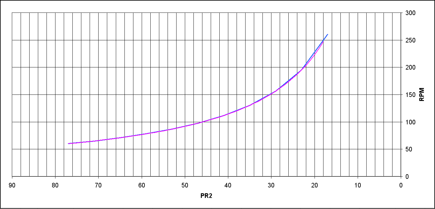

    I can do, it's just currently it's connected as a general I/O, debounced with some action behind it. The change of approach is using a timer based INT, the period is set to 100ms, as the INT also acts as a 0.1s timer for timer / LCD /sampling purposes, I've looked at changing it to 15ms or so to change the PR2 by 1 rather than 6, but overall there's very little difference in how this relates to speed. Here's a comparison between a 1 per INT change vs. 6 per INT change:
    Also the above shows the speed changing in relation to the value in PR2, as you can see it's not linear. I wanted to stop the motor without slowing it down, the load inertia isn't high and max speed will be around 500RPM.
    All I'm wanting from the slow ramp is to have more torque at the start, the torque requirement drops once the thing is moving.

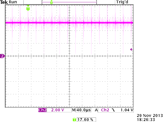

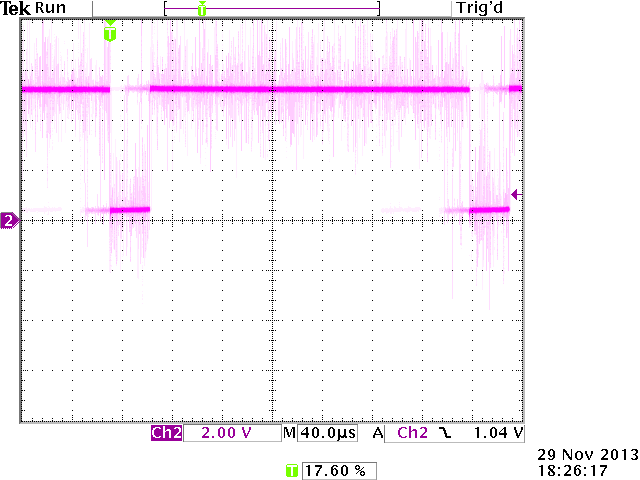

    Ok I've tried the new approach with changes to the PR2 every 100ms, all works well on a scope and on the motor, although the motor still glitches now and then on start up. Have a look at the noise levels:
    Huge is an understatement, this is measured directly on the plug to the driver, everything is grounded at this point, this includes:
    - chassis of the machine
    - motor
    - driver
    - screen on the PUL cable
    - screen on the encoder cable

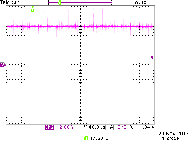

    here's another print showing the noise levels with the motor stopped:
    I'm surprised the thing doesn't trigger itself. If I unplug the motor and disconnect from the drive, the noise levels drop significantly:

    The biggest question mark is the noise levels when I disconnect the screen on the PUL cable:
    Grounding the screen seems to make things worse for some reason. Yes the screen is only connected on one side, the other side is tied back.

  7. Where are you attaching scope ground to? Sometimes the act of observing can make things seem worse.
    If possible try using two probes differentially with scope ground at star point.
  8. #18
    dsc's Avatar
    Lives in Lincoln, United Kingdom. Last Activity: 17-06-2020 Has been a member for 9-10 years. Has a total post count of 252. Received thanks 1 times, giving thanks to others 11 times.
    I thought it might not be the real noise, the ground is connected to 0VDC on the breadboard.
    Regards,
    dsc.
