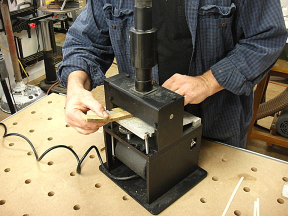

    Has anyone come across a small workbench drum sander like this sold in UK ?

    This can be bench mounted but maybe bigger than you want.
    http://www.axminster.co.uk/jet-10-20-plus-drum-sander
    I once made a jig to use a small oscillating bobbin sander, the workpiece was fed in on it's side. It was basically a hinged piece of plywood with a threaded rod adjustment so the gap between the drum and the plywood could be adjusted. Obviously the workpiece was then fed into the gap.
    Like this
    http://www.stewmac.com/shop/Tools/Sa...g_Station.html
    I also remember seeing someone build a machine like you mentioned using a hand held belt sander in a jig.

    What about a small planer thicknesser?
    Clarke do a few - Planer Thicknessers
    I think you'd probably need to build your own if you want a sanding equivalent without having to import.

    Yeah thanks for the link but it is a bit to big for waht I need :)
    Yeas M_C i was thinking about maybe making one , they dont look to complicated tbh, I have a planer and thicknesser it works well, but I have an idea for something and I want to sand flat some small thin wood in an ali case. It was only an idea if someone had seen somthing like it on the UK for sale.

    And I suppose hand sanding the item upside down on a flat surface is no good ?
    I'm not that good lol ! and its more to get some hard woods down to 1.5 mm thickness evenly as well, my thicknesser can do a good job to about 4 maybe 3 mm somthing like this but in woods that are hard to find in this thinkness cherry , ebony etc and yes I have done a fair bit of with veneers but on a larger scale , small stuff deserves sthe soild stuff :)

    For thin veneers I use a bandsaw to resaw a thicker piece of timber then sand flat.

    Wow those are awesome links , just what i'm looking for , never thought of looking at sites like that thanks !! :) Sob the sander lol I'll get some of these. I dont have a band saw btw , did have one dont have room now :(
