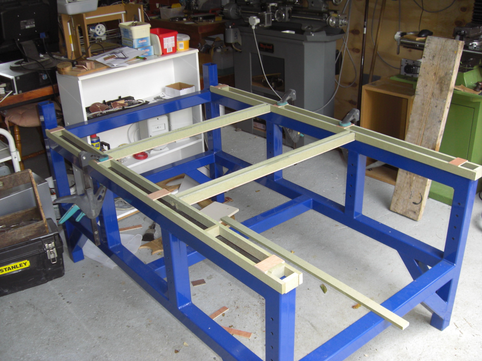

    The base will be constructed from steel and be welded. The plan is to make the base no bigger than the width of a door opening. So the height of the base would be no greater than about 780mm. I don't need a lot of Z movement - max about 4 inches. 80mm x 80mm box section appears to be ample frame size.
    At the planning stage I have decided upon 1 of 2 designs for the base.
    Design 1 - I believe this is some chap on this forum

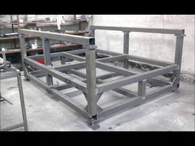

    Design 2 - Has detachable top rails. Mine would not have such a Z axis movement and be a lot lower. I may extend the rails at one end thanks to JAZZCNC for this idea.
    Design 2 is my favourite at the moment. Taking into account the length of my machine I would probably need 4 vertical supports instead of 3.
    I would be interested to hear thoughts from others on this.

    Quote Originally Posted by bobhome View Post
    Bob
    Very similar to what you have in mind I think ? but this one is just 1000 x 600 bed so about 1/4 size.
    http://www.mycncuk.com/forums/router...html#post52425
