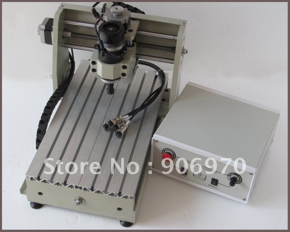

    The upgrades are just a fun project, but there is one annoying problem which has now happened 3 or 4 times...
    The Z axis coupling becomes loose and the axis drops down from the motor. Last night is was the motor side that came loose, previously it had been the leadscrew side. Fortunately it wasn't during a job and happened while setting up, but it was a major pain to take apart and tighten up. I have re-tightened everything again and put some thread lock on the screws this time. The coupling looks something like this. Is there a better alternative?

    Sorry Les, must be loosing my marbles
    I can't understand why the axis should drop because the coupling should not be holding anything up, it should just be connecting the motor and ball screw shafts.
    The ball screw should have a bearing and support block at each end.

    Well if the coupling becomes loose the motor/leadscrew separate so the axis falls down. There is nothing else holding it and don't understand how there could be as it has to move up an down. I don't have any close up pictures but this is same machine.

    Sorry Les it's me. I'm not familiar with these machines, I was thinking of a Z axis similar to this Z Axis 250mm Ballscrew Plain Mount
    As you say it looks like the leadscrew screws directly into the Z axis block so if the coupling fails the whole lot drops.
    Maybe someone else with a similar machine has a better arrangement ?
