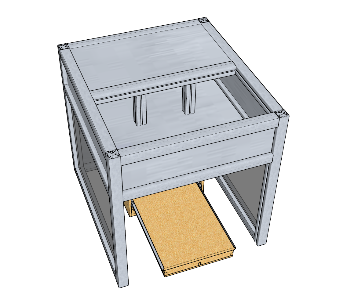

    As you say yourself why upgrade if it works ? it would probably make more sense to put the money into making a better machine from scratch but if you don't plan on any more demanding work why bother ?.
    Regarding the enclosure, gravity makes everything go down including lubricant and swarf so I'd say it was a bad idea putting the electronics underneath. It looks like a nice tidy solution but vibration would also transfer through the components, I would suggest a separate box something like a PC tower shape.

    Thanks for taking the time to reply Ed,
    Some good points.
    It does what I want it to at the moment. mechanically so no plans to replace it or do a scratch build.
    Good point about gravity, although I have never used any lubricant. Gave me an idea to turn it upside down! The controls would be more at my eye level, and I could fit some LED lights underneath the top part to light up the working area. Also as the enclosure would only be sitting over the CNC, and not physically attached, it would cut down on the vibration.

    Sorry but I would rather make something, which is all part of the fun of it for me. Joysticks, keyboards are pretty easy and cheap to make. I like the idea of everything being built in to one unit.
    I did find those links already, but I don't think any of them did everything that I wanted. My main concern is whether the 20mm x 20mm aluminum would be strong enough. Now it's not so much of an issue, as it's not going to take the weight of the CNC.

    I just wanted to say thanks to Kris from KB Aluminium, he has been very helpful so far, for absolutely no gain. (Mainly down to me being stubborn with my design & budget)
    To be honest I was also to buy from Valuframe until they whacked a £30 carriage charge on top, which I felt was a bit on the steep side.
    What amazes me with this stuff is that the fixtures and fittings are costing more than the actual profile. Perhaps I should super glue it together, or use some old toilet roll holder and sticky back plastic. Actually I could just stick with the MDF frame I have and put some windows in it!
