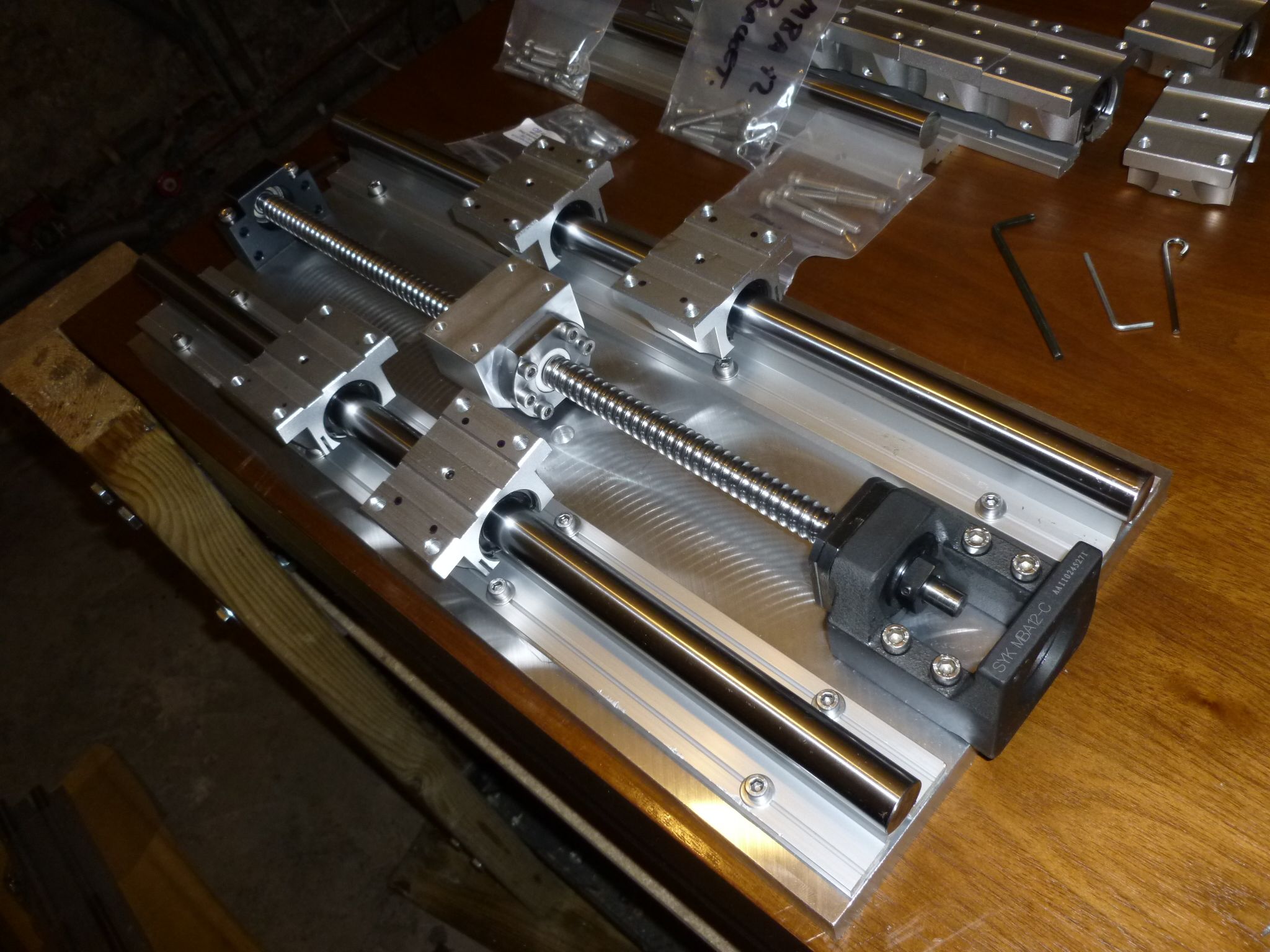

    I've started my fixed gantry mini-mill build and so far so good. Here's a pic of my bare x-axis and one with the machine table loosely fitted.

    It's a simple build made up of three linear stages, with the x riding on the y. Here's a 3D visualization:
    Looking ahead, I can see that I'm going to have a bit of a challenge when it comes time for me to square the rails on my x/y gantries.
    I'm pretty confident that I can get each pair of rails running parallel, but I'm wondering if anyone has any suggestions on how I can ensure that the two sets of rails run perpendicular to each other.
    I'm aware of the millkins script (which is an X-Y skew correction script) available from here:
    LinuxCNC Documentation Wiki: ContributedComponents
    but if I can get it close to start with, then that can only be a good thing.
    Thanks for any advice!
    Wal.
  2. What I did to check perpendicularity on my mill was to clamp a good known 8" engineers square to the table and mount a lever arm dti in the spindle. I then adjusted the square to achieve 0 deviation on the x traverse, rotated the spindle 90° and measured the y deviation by traversing the other leg of the square. In your case you could use the x & y reference edges to do something similar. A set of good parallels would allow you to check y alignment at various x positions. Obviously you don't have a spindle yet so you'll have to synthesize some sort of temporary and fairly rigid fixed height z axis.

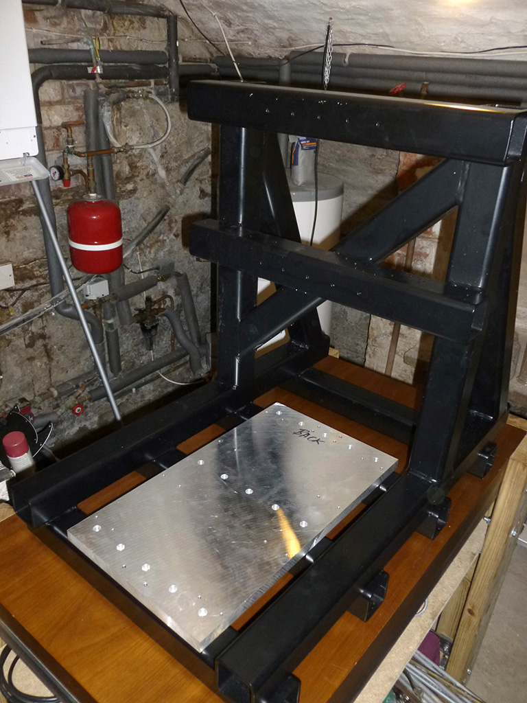

    Picked up the (70Kg!) frame from the steel fabricator earlier today. A friend helped me get it into the basement - door and banister had to come off temporarily (and will now probably stay off for the foreseeable future as I devote all my time to putting it together - heh!). In theory I now have everything I need, just a case of tapping, assembling and squaring the beast..!

    I feel a week off work is in order...
    Wal.

    Looking good Wal, I don't think that will flex much ..Clive
    Wal's Avatar
    It's Dean's fault. I'm paranoid about deflection...!
    Hey what.??? . . . . Don't be blaming me I had nothing to do with it you read into my posts what you will.!!!. . . To quote Manuel from faulty towers " I Know Nothing". . Lol
    Just want to ask why you had that diagonal brace put so low down.? . . . . Looks to me like could be in the way if you have larger material on the bed or use a vice etc.?
