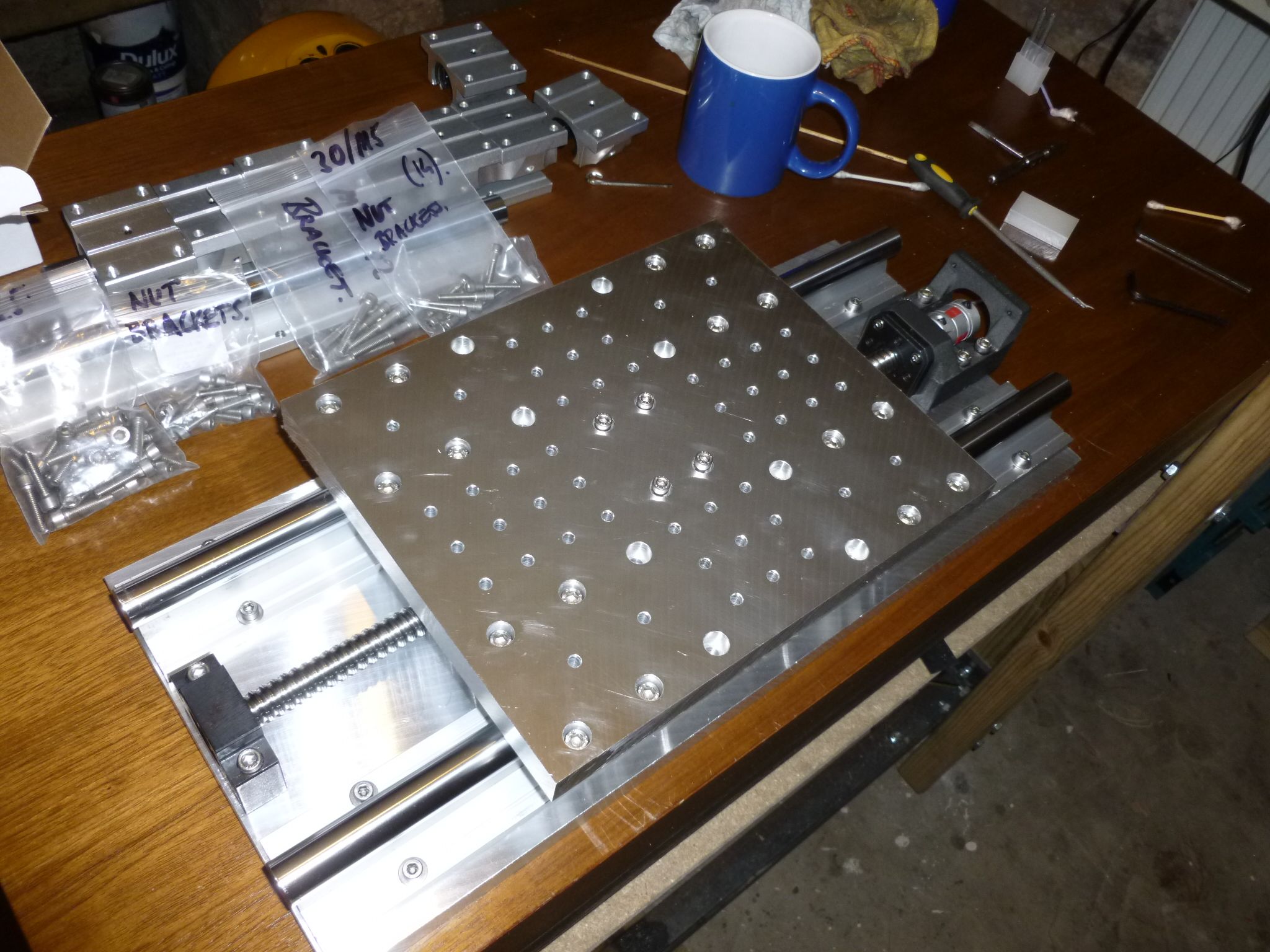

    I've started my fixed gantry mini-mill build and so far so good. Here's a pic of my bare x-axis and one with the machine table loosely fitted.

    It's a simple build made up of three linear stages, with the x riding on the y. Here's a 3D visualization:
    Looking ahead, I can see that I'm going to have a bit of a challenge when it comes time for me to square the rails on my x/y gantries.
    I'm pretty confident that I can get each pair of rails running parallel, but I'm wondering if anyone has any suggestions on how I can ensure that the two sets of rails run perpendicular to each other.
    I'm aware of the millkins script (which is an X-Y skew correction script) available from here:
    LinuxCNC Documentation Wiki: ContributedComponents
    but if I can get it close to start with, then that can only be a good thing.
    Thanks for any advice!

  2. What I did to check perpendicularity on my mill was to clamp a good known 8" engineers square to the table and mount a lever arm dti in the spindle. I then adjusted the square to achieve 0 deviation on the x traverse, rotated the spindle 90° and measured the y deviation by traversing the other leg of the square. In your case you could use the x & y reference edges to do something similar. A set of good parallels would allow you to check y alignment at various x positions. Obviously you don't have a spindle yet so you'll have to synthesize some sort of temporary and fairly rigid fixed height z axis.
    Hi Wal, your pics are looking good. Well done and keep those pics coming. G.
    Wal, For a machine that size it looks like a much better and easier route than the moving gantry design. If it is out of square what are your options for correcting it i.e. means of adjustment ?
    I wanted to keep things as simple as possible, so opted for 3 semi-autonomous linear stages along with off the shelf parts (like the motor mounts) - all I really had to do was buy the rails/ball-screws (as per the specifications recommended here) and then work out where the holes needed to be to mount 'em... The work area comes out at approx 200x200mm - or 200x300 if I re-position the pillows on the machine table. The footprint is a lot bigger than that - about 800x600 - and the weight of the frame/aluminium/plates/hardware is knocking on 100kg... eek.

    Irving, I'm having a bit of trouble visualising the squaring process - no sooner than I get an inkling, another thought comes along and de-rails (pardon the pun) it. I'm gonna have to draw some pictures..!
    Wal.
    Fashion something like a fly cutter, mount a dial indicator on its long arm and rotate around or something like this, which is better and use the long arm, then rotate. or something simpler, but on the same principle.

    Picked up the (70Kg!) frame from the steel fabricator earlier today. A friend helped me get it into the basement - door and banister had to come off temporarily (and will now probably stay off for the foreseeable future as I devote all my time to putting it together - heh!). In theory I now have everything I need, just a case of tapping, assembling and squaring the beast..!
