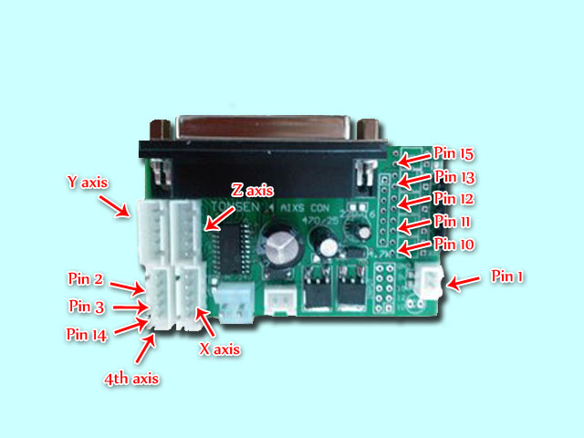

    I have this BOB in a machine i purchased a couple of months back, so far ive had no problems with it. Although im not doing anythign greatly extravagant with it. I would like to add home switches to it though and maybe a touch off plate but so far ive not found where to connect the wires.
    Any help would be appreciated

    Here's a a pic with the parallel pin locations...
Name:	tonsen controller.jpg
    Don't forget that none of these are opto-isolated. I will be posting on my blog in the near future on how to make an opto-isolated addon board for this controller.

    Ok this is going to sound dumb but what does optoisolation do? lol sorry but im very new to this. I will probably be connecting microswitches as home switches, although i have some prox sensors i think in the garage which need 8v according to the packing .
  5. #14
    Quote Originally Posted by Jester View Post
    An opto-isolator use light to transfers electrical signals between two circuits, preventing high voltage from affecting the system receiving the signal.

    Just think of it like this...
    If you have a major malfunction and 240v gets sent to your parallel port, it will probably fry the port and motherboard. Opto-isolation helps to prevent that.
    Having said that, I have been running my home/limit switches without isolation on the Tonsen BOB for the last 6 months without issues. I have however just built the opto-isolated addon board to hook up to the Tonsen BOB, I just haven't had time to test it properly. Now that the Christmas malarkey is out of the way, perhaps I can get to test it.

    Hi all, I also have one of these Chinese Wonders (It's a Wonder that it works!) with the Chinglish Manual and misspelled PCB designates. For my efforts I decided to fit Home/Limits to the X, Y, & Z planes which went quite smoothly until I inspected the I/O Board.
    So I set about to bring this into line with half decent components. I upgraded both the 5v and 15v Regulators. Changed the polarity protection diodes for 3A shottkies which have a much
    lower forward voltage drop than the !N4007’s.
    I also changed all the electrolytic’s for 108° low ESR, replacing the 407µF with a 1,000µF The PCB has all the locations needed to fit 5 Opti-Couples and the pull-up resistor network needed for the home/limit switches.
    I thought I was doing ever so great and about to do a bit of ‘Yankee Back Patting’ as I connected everything up and switched on..
    This time the Spindle Motor didn’t Rev it’s nuts of as usual and the System Fan did not work.... Yep, you guessed right I miss-connected the Fan and Spindle Motor Controller. No big deal as I didn’t see any ‘Smoke Escape’ 1 However, putting 15V directly across the Anode and Cathode of the Motor Controller Opti-couple ensured its demise.
    Whilst I was investigating the possibilities of any further damage I rung out to continuity the return line from the connector to the Parallel Port Pin 1.
    The Drawing Les, (Pointy) has painstakingly provided is a great help apart from the Motor Line from Pin 1 is connected to the 5v Line via one of the 330R pull-ups, and the second connection to ground. This is incorrect. Pin 1 from the parallel port connects directly to the Opti-Couple on the Motor Controller Sub Board. Be very careful when tackling any problems with the Motor Controller Board It is connected directly across the Mains with enough current to blow your hat off !!
    Scoping the Signal, DC Lines, and I/O lines shows that my efforts in upgrading the components has paid off with reduced electrical noise.
