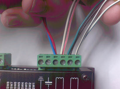

    This is driving me nuts. Last night I started wiring up my PSUs, drivers, and motors. All the standard Zapp/MCP kind. Wired everything up as per the diagram provided by MCP. Plugged it in and the PSU has a green light, but the drive has a red one! I have checked my wiring against the note about a hundred times! I tried both series and parallel, tried different drives, different psu. Nothing works!
    This is the wiring I am using:
    A+: Blue + Red
    A-: Blue/white + red/white
    B+: Green + Black
    B-: Black/white + green/white
    Could someone please check the attached pic and tell me what I have done wrong? I have wired these things up before without problem.
    Cheers,
    Dave.

    We have seen this problem before, another PSU in parallel with your current PSU should fix the problem.
    Let me know what size PSU you’re using and I’ll give you a price, i would also suggest doing the linking at the motor end as well.
    I don't even know if I want to admit this...
    But as it turns out the problem was the PSU. One of them is a PS407, the other is a PS705. The 705 is rated at 70 something volts, and the drive only takes something like 48 if I remember correctly.
    Anyone want to buy a PS705 unit? :D
