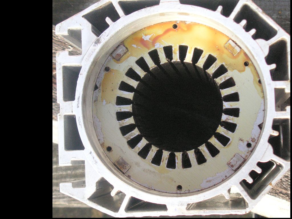

    My first thought was to look the at connections to see if I could reconnect as delta . The motor windings are well constructed with every thing tightly wrapped up varnished and baked, I don't know if it is star or delta at the moment and it would take a bit of risky digging to find out.
    I have also worked with motors for a long time, I have in the past (~60 yrs ago) rewound the odd motor or two, things had not used to be so throwaway then, I also had the advantage of working at a motor manufacturing plant, so all the materials were readily available.
    The actual laying in of the coils is a fairly easy mechanical task, particularly with 8 poles 24 slot single layer, and is well within my DIY territory.
    The more technical aspect of rotor slots, flux densities,wire gauge and turns is a bit more challenging, as John S inferred, which is why I was looking for the experience of others who may be designers of motors. There are several programs available to help with this but was looking/hoping for a shortcut.

    I have eventually rewound my 2 pole spindle to 8 pole, dragged on a bit for a variety of reasons. Did a little research on rotor slot numbers, seems to be a bit of a black art with different motor manufactures doing their own thing, seems to be more to do with starting torque and efficiencies than any thing else.
    Invested in a winding design service on the net, asked for 240v 400Hz delta connection, came up with 20 turns per slot.
    Wound the stator at 20 turns two in hand 0.75mm wire, ~20A in delta no load running - ~12A in star, this was about 8 times the original motor.
    Some emails back and forth getting me nowhere, seemed obvious to me that it was lack of turns (flux).
    Decided to think it through on the basis that I knew the turns and current of the original motor and that HSD had got the ampere turns right.
    Fortunately I had tried the motor before varnishing it so I was able to strip it down again very easily.
    Wound the stator at 50 turns two in hand 0.55 wire, ~2.5A in delta no load running similar to the original motor, runs OK up to 500Hz which is more than I want.

    Sorry but modifying some one else's motor would be a bit scary , I persevered with mine mostly because I was told it's not possible and I could see no reason that it could not be done, just a matter of finding the correct info, I have spent a lifetime solving engineering problems, many of which were not possible.
    There are motor design programs out there but they are very expensive, need to find a friendly face in one of the universities. I tried a couple of re-winders for info but they really don't want to know about anything non standard.
    Modifying an existing motor should not be too difficult if you accept that the manufacturer got it right with respect to flux densities in the stator (ampere turns in old money).

    Anyway, Geoffrey, have you got a picture of the stator inside your motor? I'd be interested in rewinding it / working out how for you. Who told you that it wasn't possible and what reason did they give?
    Thanks for your reply and offer Jonathan. I do not have any pictures of the internals of my spindle as I have never thought about dismantling it. I have a couple of these spindles which I love to use because of the air release collet chuck and work around the fact that I am limited to 3.172mm shank tools. As I have a "spare" spindle I would be happy to take a chance that it does not work if you are prepared to try. The impossible comment came from various commercial rewinders and I had very little faith in that I believe that nothing is impossible!!! Perhaps a little difficult sometimes. The most logical comment came from one rewinder who said that it would be difficult on a small diameter spindle to use the heavier duty wire necessary to change. These spindles are lovely (ex pcb machine), but I only have one HF inverter and I would like to get one running on a standard 400hz inverter as I have started to strip down another machine which has a cutting area of 540x600mm. G.
