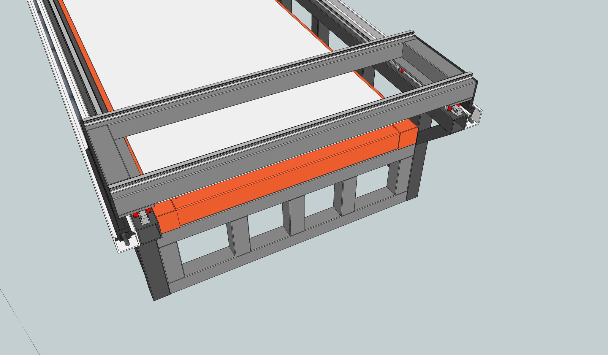

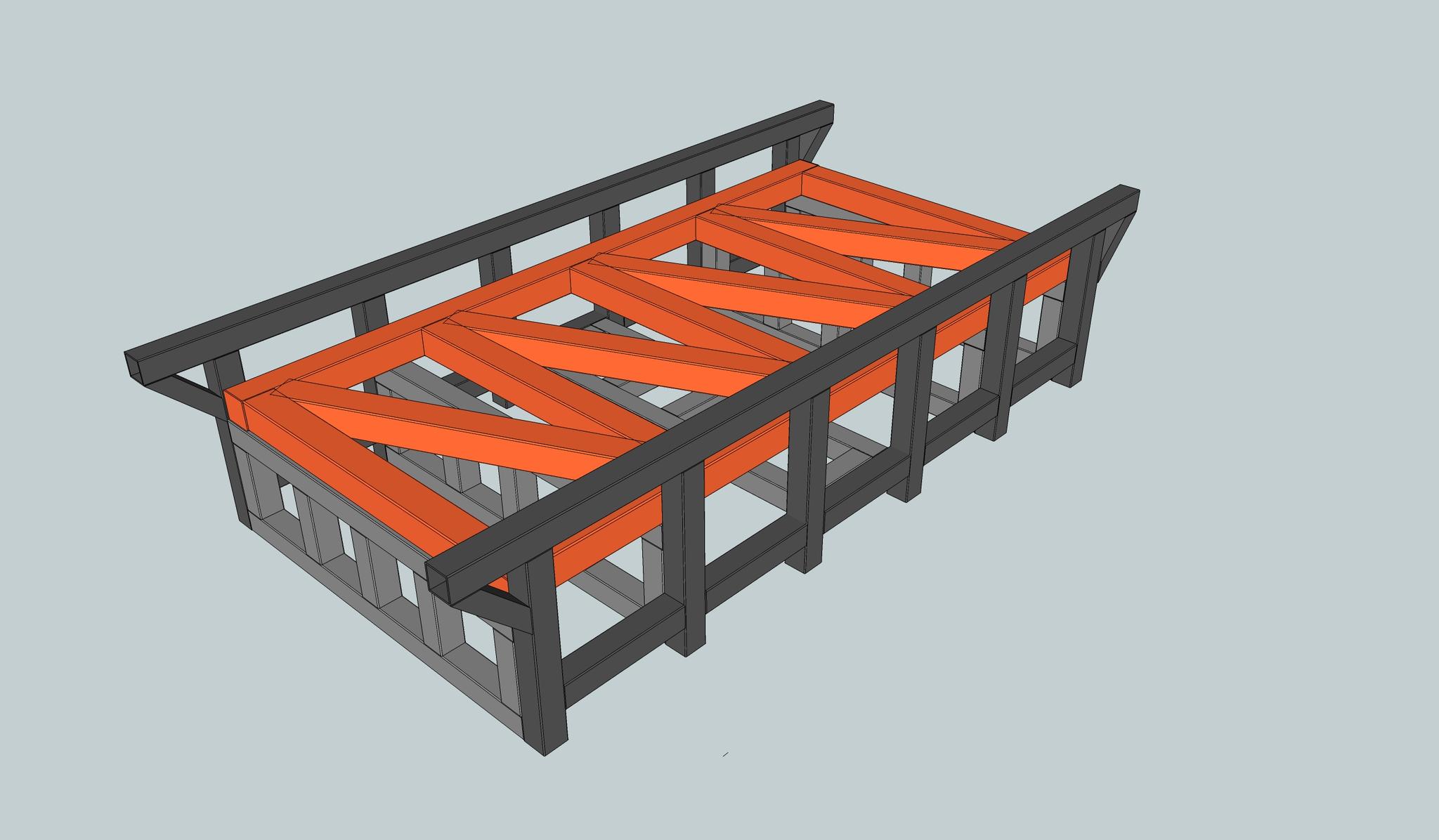

    Next round guys Mk3!

    Removed steel form sides and changed bed supports. Any better? Saves a lot of excess steel.

    Started on ideas for rails etc... let me know your thoughts please.

    Think this should provide a strong setup, also thinking about using BK blocks to mount Ball screws? Will these be suitable?
    Thanks!!
    The covers round your ballscrews will fill up with swarf and cause the ballnut to fail prematurely.
    Quote Originally Posted by Wejjmeister View Post
    Best way is to use a rotating nut. If not, then at this length you'll want two angular contact bearings at both ends to get a respectable speed. Search on Google 'ballscrew critical speed' for more information.
