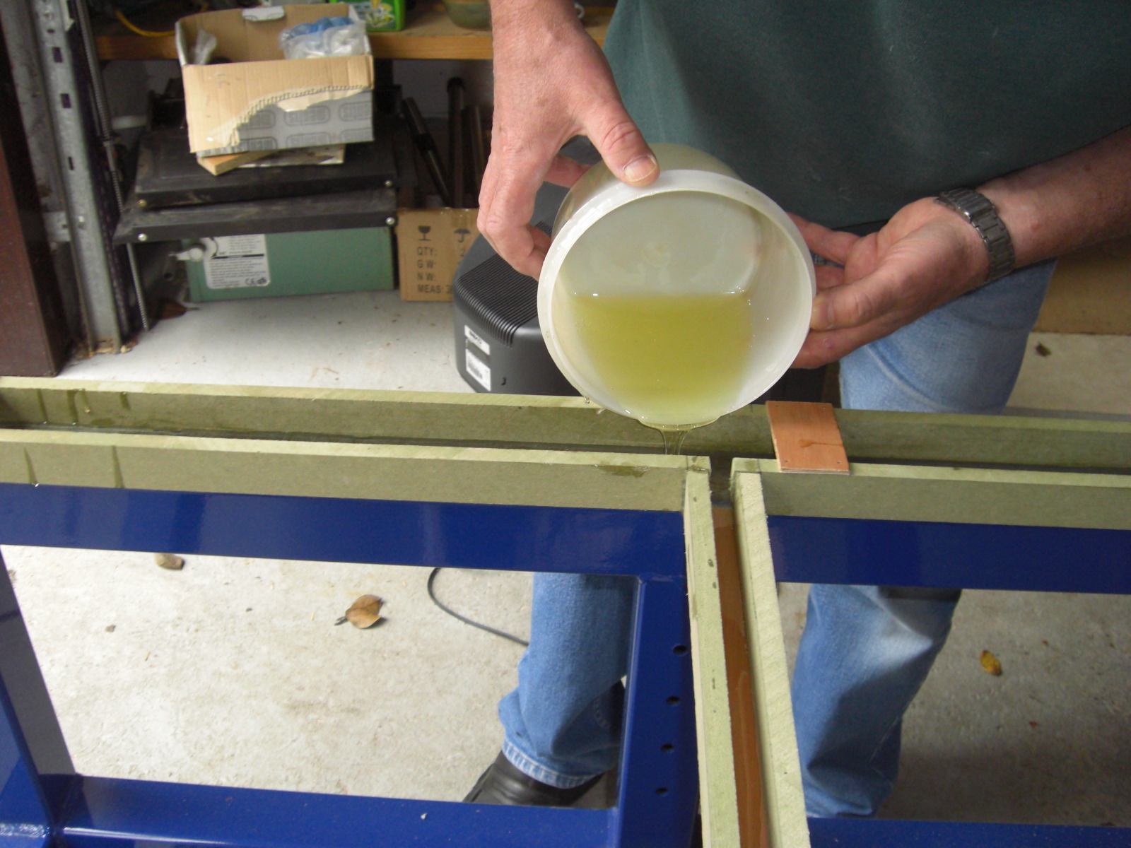

    Lives in Marple Stockport, United Kingdom. Last Activity: 10 Hours Ago Forum Superstar, has done so much to help others, they deserve a medal. Has a total post count of 3,347. Received thanks 620 times, giving thanks to others 90 times. Made a monetary donation to the upkeep of the community. Is a beta tester for Machinists Network features.
    That's the method I'm also using and I found that after welding, one corner of the frame was 3mm out of level with the other. This might be regarded as too much depth for epoxy treatment alone. I don't know for sure ? but at least I can shim the rails to as near level as possible then use epoxy from there.
    Eddy You might have seen this before there is no problem with the thickness of the epoxy Jonathan and I have used it I think Dean uses some sort of epoxy putty which is stiffer, he has explained that on other threads.
    I poured this to about 5mm deep it is very slow setting 10 - 20 hours and don't touch it for 48 hours. Wests system
