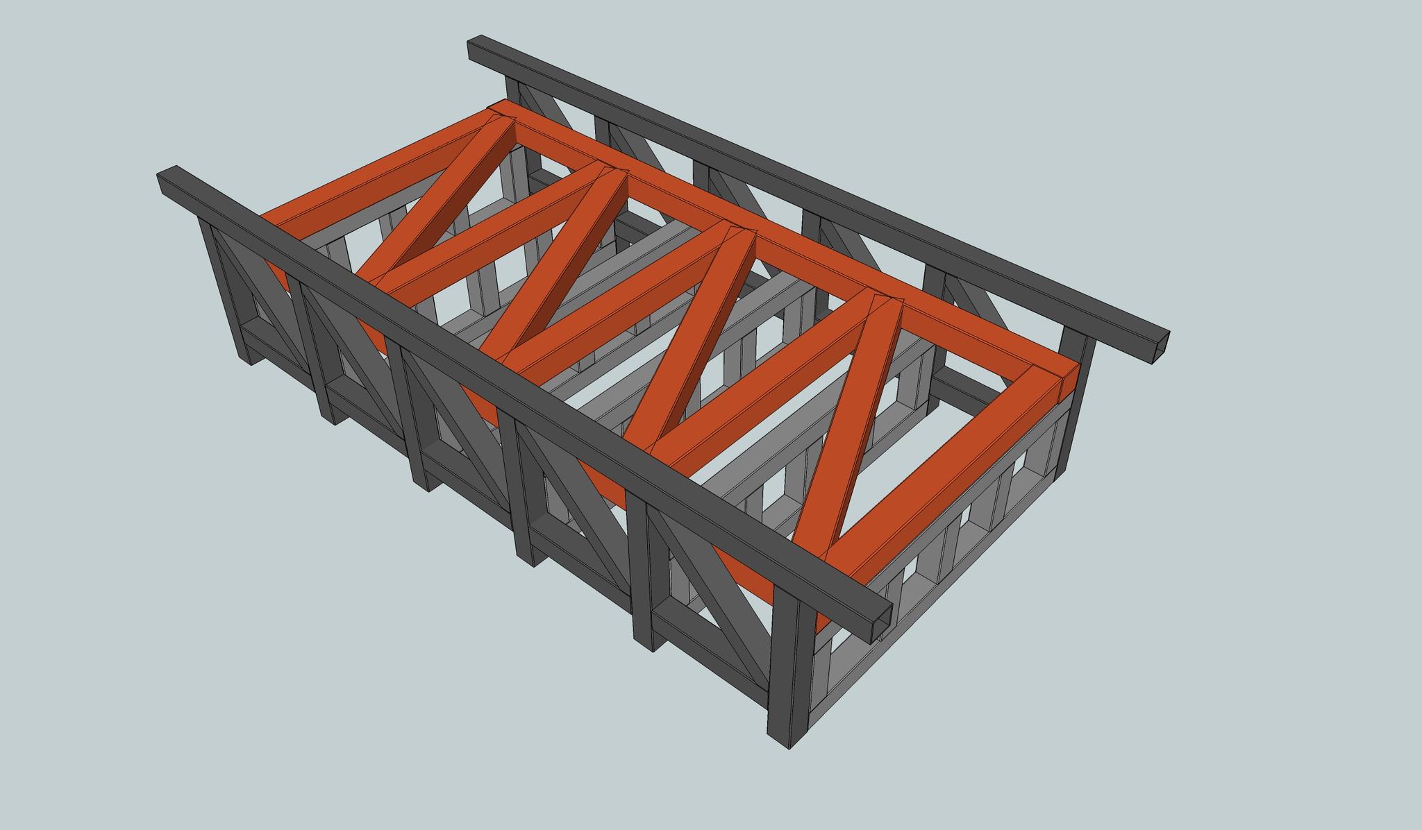

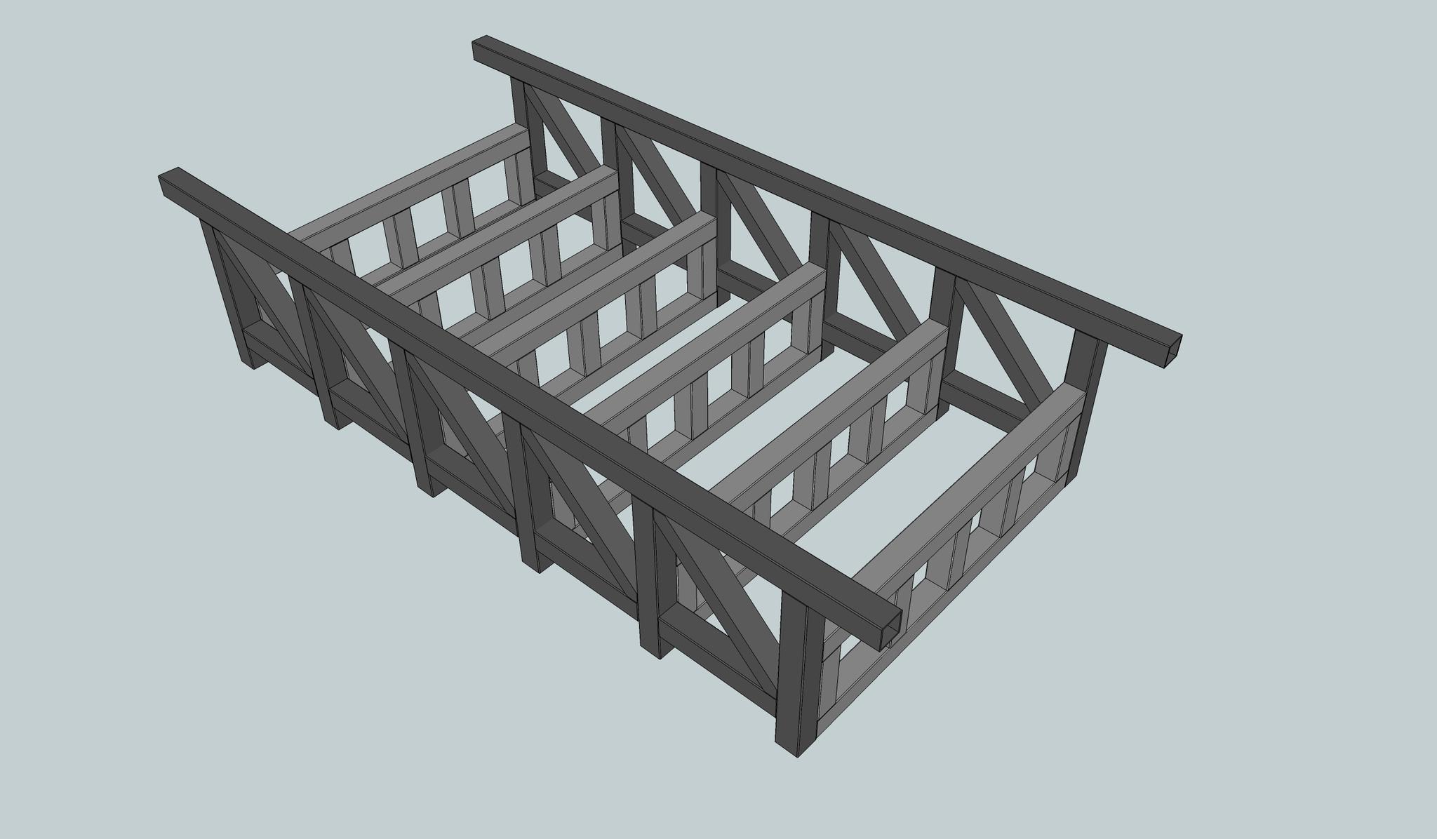

    First stage of the MkII done, Im still working on it so bear with me. I decided just to use the epoxy on the tops of the rails as plates and shims plus epoxy will be a mare. It may be slightly better but I dont intend on moving it once set up so I think Epoxy should suffice.
    The whole of the frame will be sand filled too, so not worried about resonance.
    Next step is the rails and ballscrews and placements of. Will add more a little later hopefully, time permitting!
    Thanks ever so much for all of the comments though guys, a real help!

    The diagonals at the sides, it seems to me help nothing except add weight. Should work fine without them, but that's me :-)

    Looks ok... but probably a bit OTT. Don't leave the ends of the long pieces of box section cantilevered - support them with a piece at 45°.
