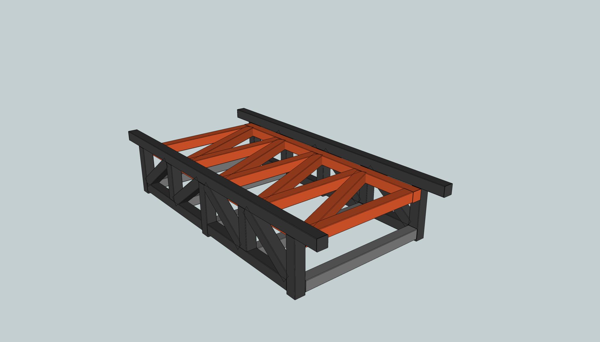

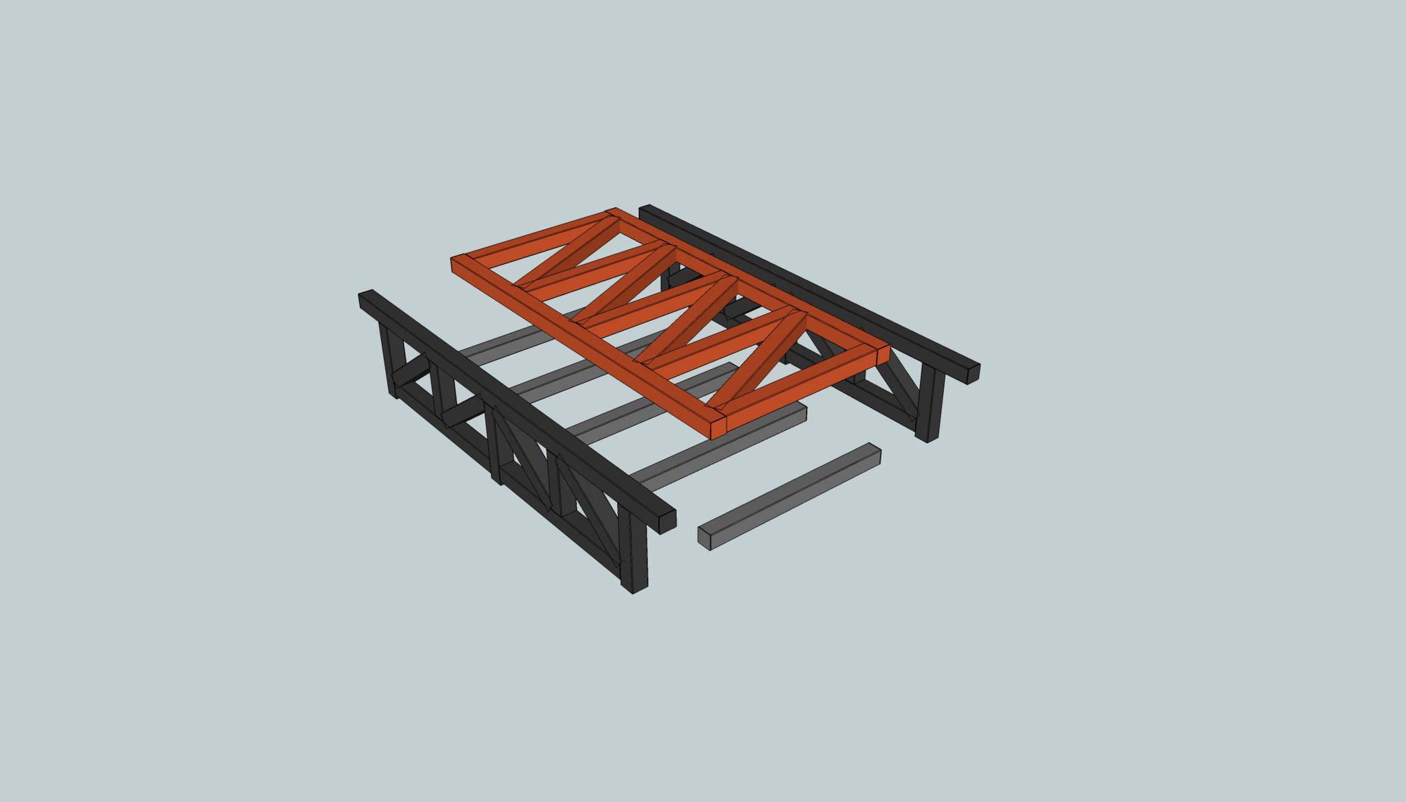

    So I've been planning to build this thing for quite some time now, finally I have taken the plunge and started to finalise the specs. I have read, re-read and read again many of the posts on here looking for advice and ideas, and I am now ready to lay out my designs in front of you guys for some no doubt frank but highly constructive criticism hehe!
    My machine will be used for every type of material between balsa (model making) and Aluminium, and must be able to cut 1220mm x 2440mm sheets of the above materials at times. I will type out my specs a little later on as I'm limited on time at the moment, but I have put together the design in Sketchup for the general idea, and wondered before I go any further if you can give me ideas as to whether it will be strong enough or not?

    It looks quite strong but you don't have any diagonal bracing on the ends. Also with a machine this size I would estimate the amount of material and calculate the weight, you will probably find it need to be made in bolt together sections, the bed being one section on it's own. The method of bolting may therefore have a small effect on your current design. It also looks like you have very little depth of cut in the Z direction.

    I wouldn't use that method to build it.? I would drop the extra top rail and just extend the uprights to get your extra height.
    It will save on material and resonance because those will be 2 large drums you'll be creating. To be honest I wouldn't use 100mm Box I'd go with 80mm and thick walled.
    I'd use the design Eddy showed with top rails sat on plates which can be adjusted into plane much easier. The work involved with Epoxy is quite involved and to be honest a complete waste of effort if your going to use those Cheap round rails has there will be more error in there base than the surface your fastening to.! . . . . I also doubt you'll get it any better with epoxy than using the above method and it will take much longer and not be has flexible, it will also cost lot more money.
    Show us the same picture but with out the bed base so can see the bracing etc.

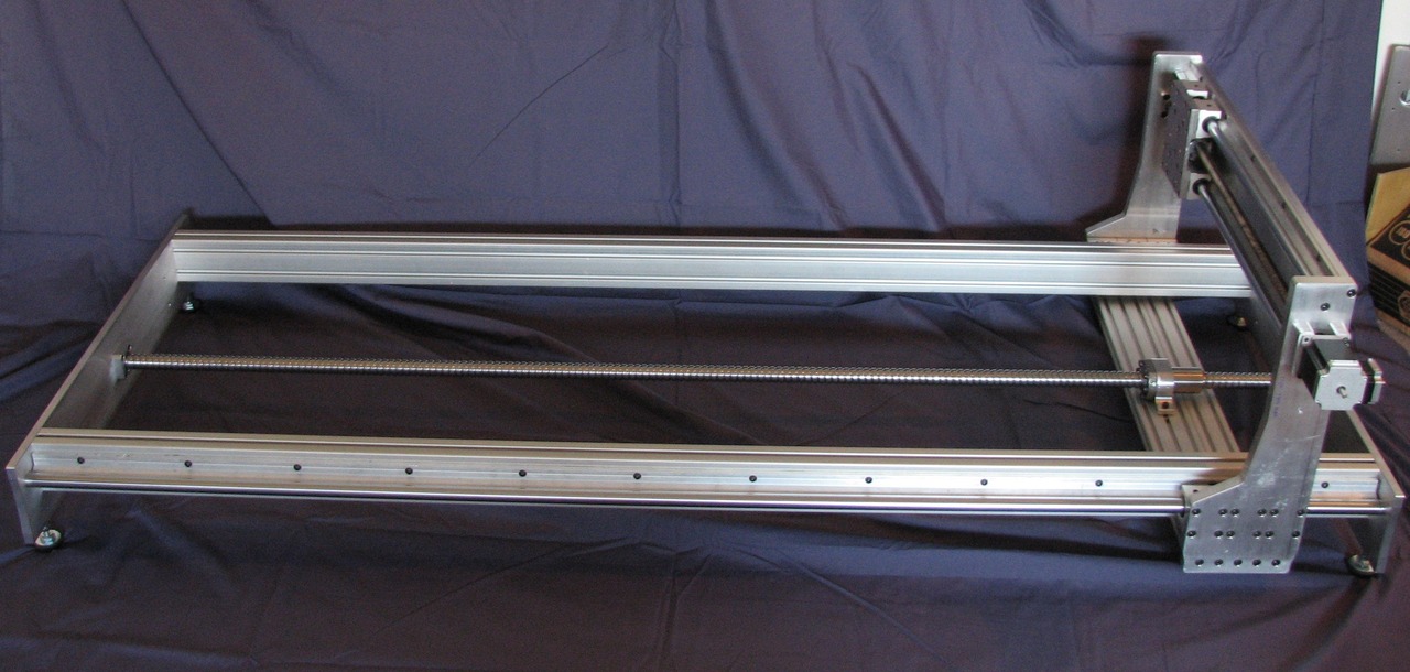

    Hi Wejjmeister,
    The ideal rail arrangement for these types of rail (supported round) is like what you see in the first pic below on the Y Axis (machine bed), so what your looking for is the base/bottom face of each rail to be facing each other. This dose make it harder when you come to true the rails to each other and get them on the same plane's but it is feasible.
    This is true for any axis you use this type of rail for, so if you look at pic two below i'm selected in green the faces I think you should use to mount your rails. If you mount them on those faces, the other nock on effect is that you are also bringing the gantry closer to the bed.
    .Me
ID:	11197   Click image for larger version.
