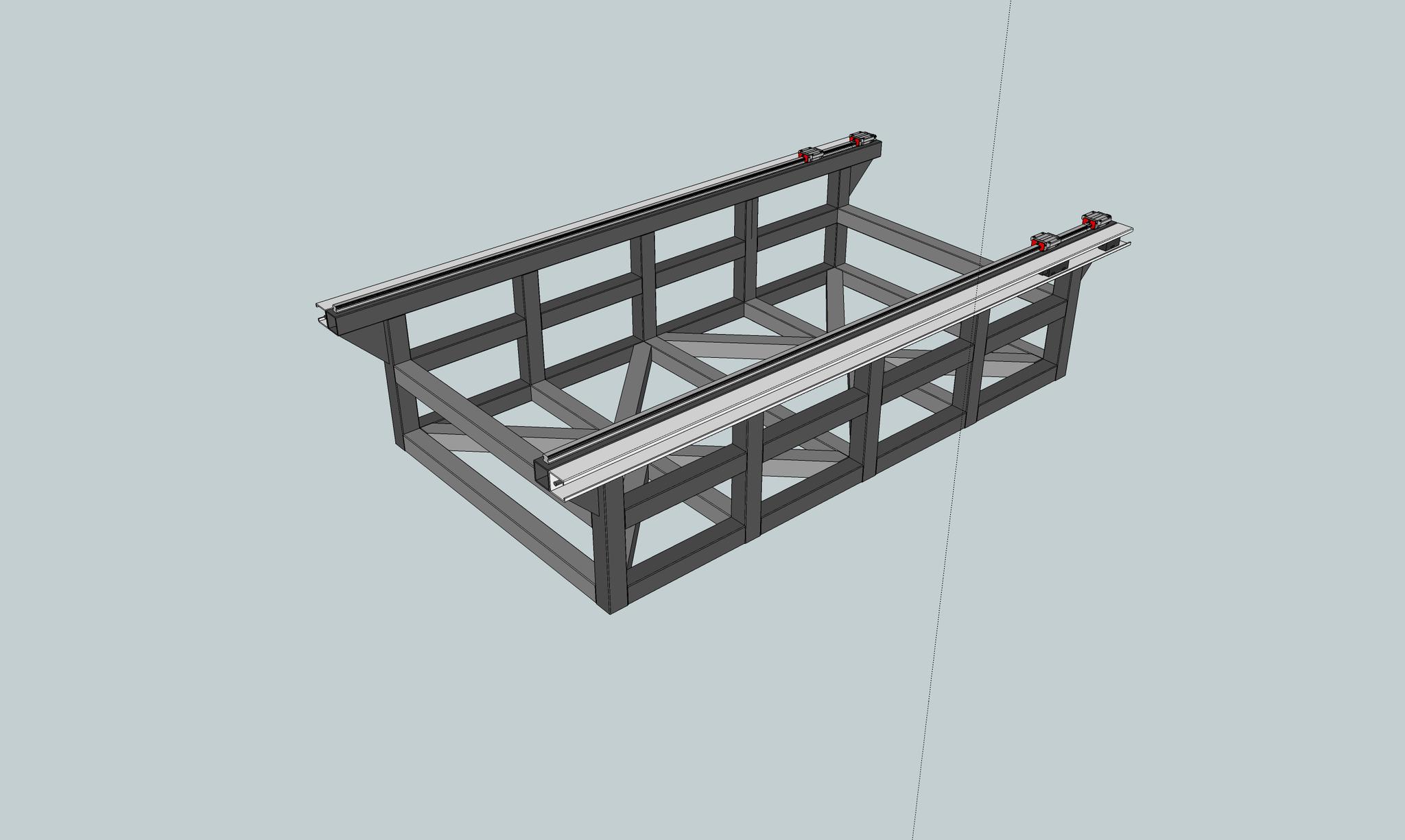

    Thanks, shortly after posting that comment I found some file Jonathan had uploaded, so Im currently trying to integrate that into my design.
    Here is the Mk4 frame layout, any opinions guys? Ive taken on board other designs in this one, Im making the bed adjustable too on holes inside the legs, so it will have further movement, will that affect anything else do you think?
    Thanks in advance!
Name:	CNC CROUTER - Frame Mk4 withj bed.jpg
ID:	12420   Click image for larger version.
Name:	CNC CROUTER - Frame Mk4.jpg

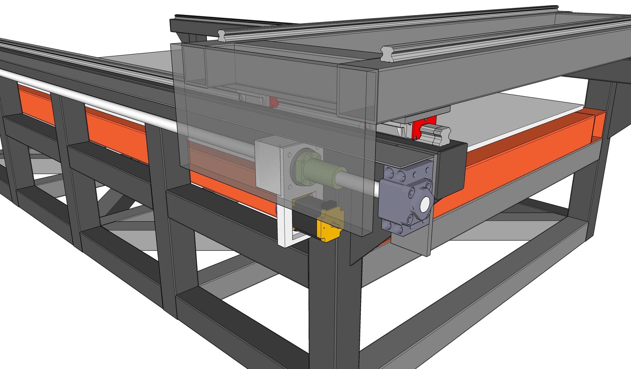

  9. #59
    Is this any good chaps? Changes a fair amount to incorporate it...
Name:	CNC CROUTER - Frame Mk4 ballnut design2.jpg
ID:	12469Click image for larger version.
Name:	CNC CROUTER - Frame Mk4 ballnut design3.jpg
ID:	12468Click image for larger version.
Name:	CNC CROUTER - Frame Mk4 ballnut design.jpg
  10. #60
    Can anyone just gimme an idea as to wether Im heading in the right direction please, I dont want to go too far with any major flaws. Thanks.
