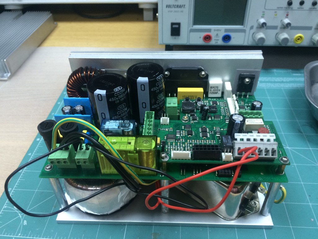

    Im so sorry im rising such old topic from the ashes, but it is the only one on the internet with same problem as mine. I recieved my machine and it could only go to about 500 RPMS less than specified. I was sent by manufaturer adjustment procedure and while trying it the motor has jumped 5800 RPM and fuses exploded. My PCB is a newer variant with IKCS22F60F2C . It could be seen PCB was hand repaired before as many other junk Chinese packed on this machine (i was an one time buyer, so great way to get rid of various defective parts that were not shipped to Optimum). I replaced the burnt PFC stage, IKCS22F60F2C, input rectifier and my board works now. However the motor does not work and PCB only makes short 6 flashes (error code maybe?) and freezes. I managed to get a new tested board, but this behave same as one i repaired.
    Im suspecting the motor, but never worked with BLDC motors in past. How should i test this motor? Its same as motor allready shown here. Should i open it up and test Hall sensors?

    There will probably be 3 main terminals, you should check the resistance between each one and they should all read the same.

    2 months of trouble, but started working tonight. So i removed the motor, powered the hall board with a bench power supply and tested the output of them, all of them worked ok. I measued ressitance to ground and between terminals, it was ok. I tried insulation tester and all windings seemed to be ok. I tried applying DC to terminals and all of them slightly moved the motor.
    I reinstalled the motor again and same thing happened. While starting the motor ON/OFF switch gave 6 flashes and went silent. As i was speaking some rude words to it i pressed the on button few times in series and motor started. Now it works ok. I tried for research purpose to disconnect motor terminals and it again gave 6 flashes and go out. After pressing on button 3 times in row, the PCB "resets" and it works nicely afterwards.
    I guess the PCB goes to somekind of protection mode after the motor has been disconnected, and 3 pushes of the ON button reset it. Even the manufacturer does not know this (or does not want to tell).
    Im attaching a picture for this PCB as future reference if someone will google this situation in future. Furthermore i will give discovered procedure for adjusting speed range. Pressing the lower button on small PCB you adjust the maximal speed with speed pot, and pressing the upper button you adjust the minimall allowed speed.
