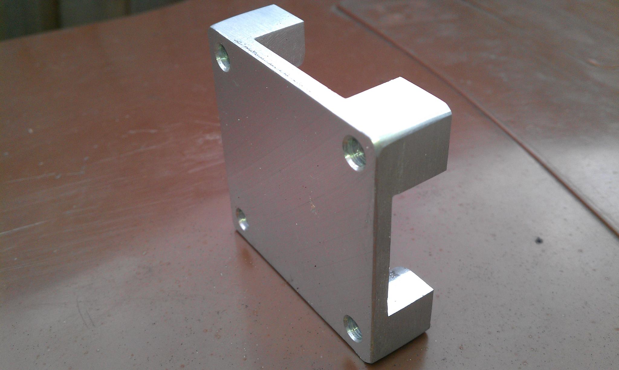

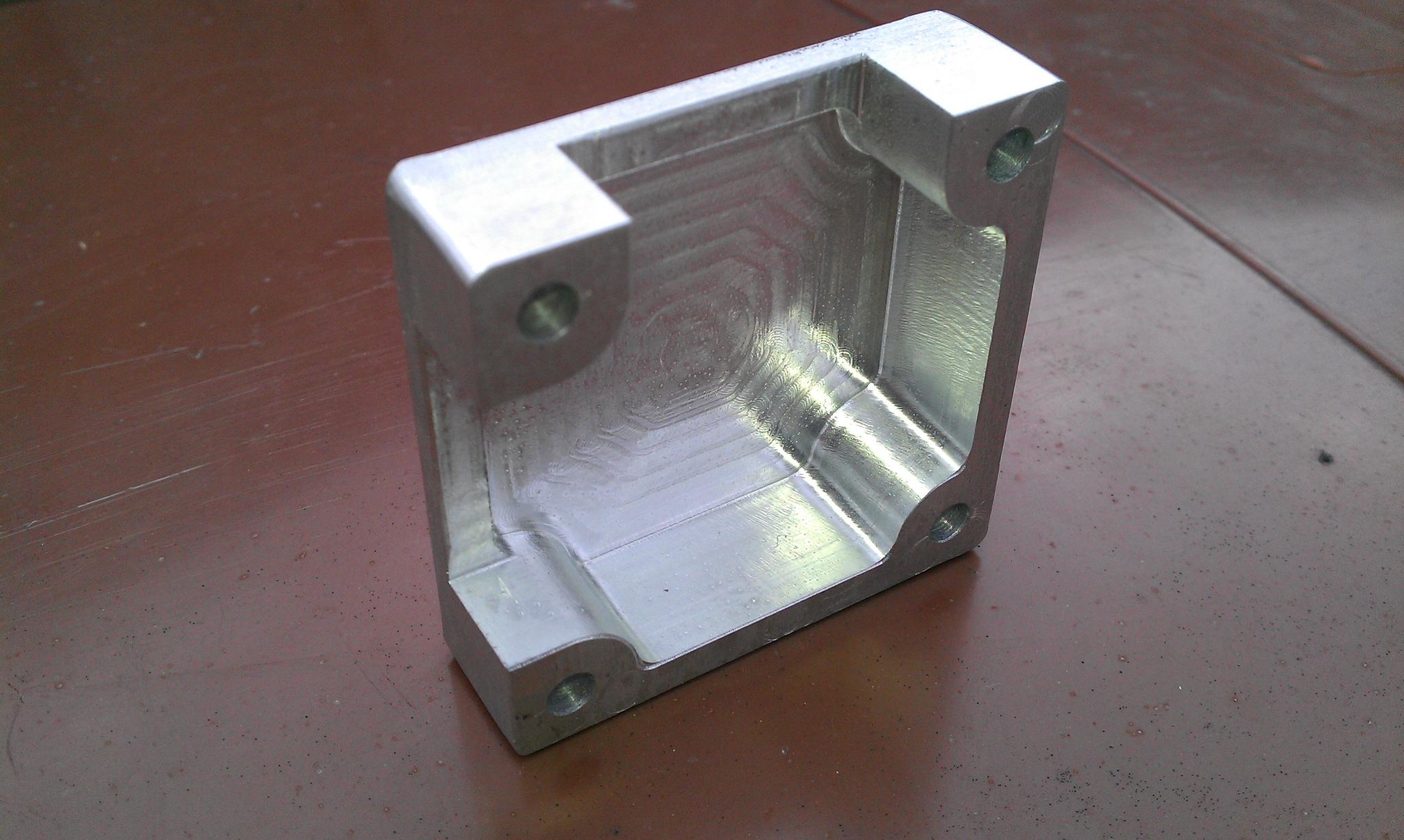

    No that's conventional cutting and yes the I-machining does indeed improve tool life massively but like you say it's resoanably hard on the machine if run at the higher settings but it can still be fine on even larger gantry machine like mine.
    Here's a rough shaky video of my machine doing a little, these are just roughing passes, was finished with 4mm and conventional wall & floor paths. This was level 2 and theres 8 levels plus turbo mode.!! The DOC is 7.5mm but only because flute length was only 10mm other wise it would have done it full depth 15mm just has easy and at same feed etc. CNC Stepper spacers using i-machinine toolpaths - YouTube
    This is the finished part just off the machine.

    Awesome - the material removal rate is fantastic compared to the raster/offset paths I'm using out of Vetric and there's something very "right" about chips and the way they come off of the cutter.
    2000mm/min doesn't sound too aggressive (I assume that's the rough maximum as iMachining varies the feed) - I was expecting 3-4000mm/min max, but as you say its No. 2 out of 8+ settings.
    Well it doesn't so much change the Feed but more it adjusts the stepover when you go to higher settings.
    How it works is by varying between a Minimum and Max stepover and feed rate in differant areas to maintain a constant chip load and positive tool engagement.
    To give an example of going one setting higher. 8mm Carbide 11mm flute length cut depth 15mm done in 2 passes [email protected] DOC 2nd @ 6.6224mm
    #2 setting
    Min Step over 0.160mm Max 1.050mm feed 2411mm/min Spindle speed 13,571Rpm x 2 steps . . . . Cut time per part 3.27mins
    #3 setting
    Min Step 0.560 Max 1.710 Feed 2498mm/min 14,667Rpm x 2 steps . . . . Cut time per part 2.10 mins!!
    My machine would have handled this and possibly higher but didn't want to push it.!
    Just for giggles.
    #8 Min step 2.880mm Max 3.310 Feed 3902mm/min 16.213Rpm x 2 steps . . . . Cut time per part 0.52 Mins.!!!!
    This would rattle my machine into pile of nut n bolts and melt down the spindle. . Lol
    Funny enough Same but with flute length to allow full 15mm DOC so only 1 x pass isn't that much quicker due to lower STO & feeds.
    #2 Cut time per part 3.08 min
    #3 Cut time per part 1.54 min
    #8 Cut time per part 0.42 Min
    Edit: Oh by the way just checked code and that video was done on setting #1 not #2 and thats why feeds are lower at around 2mtr/min. Total time for 3 parts was around 15mins I seem to remember.?
